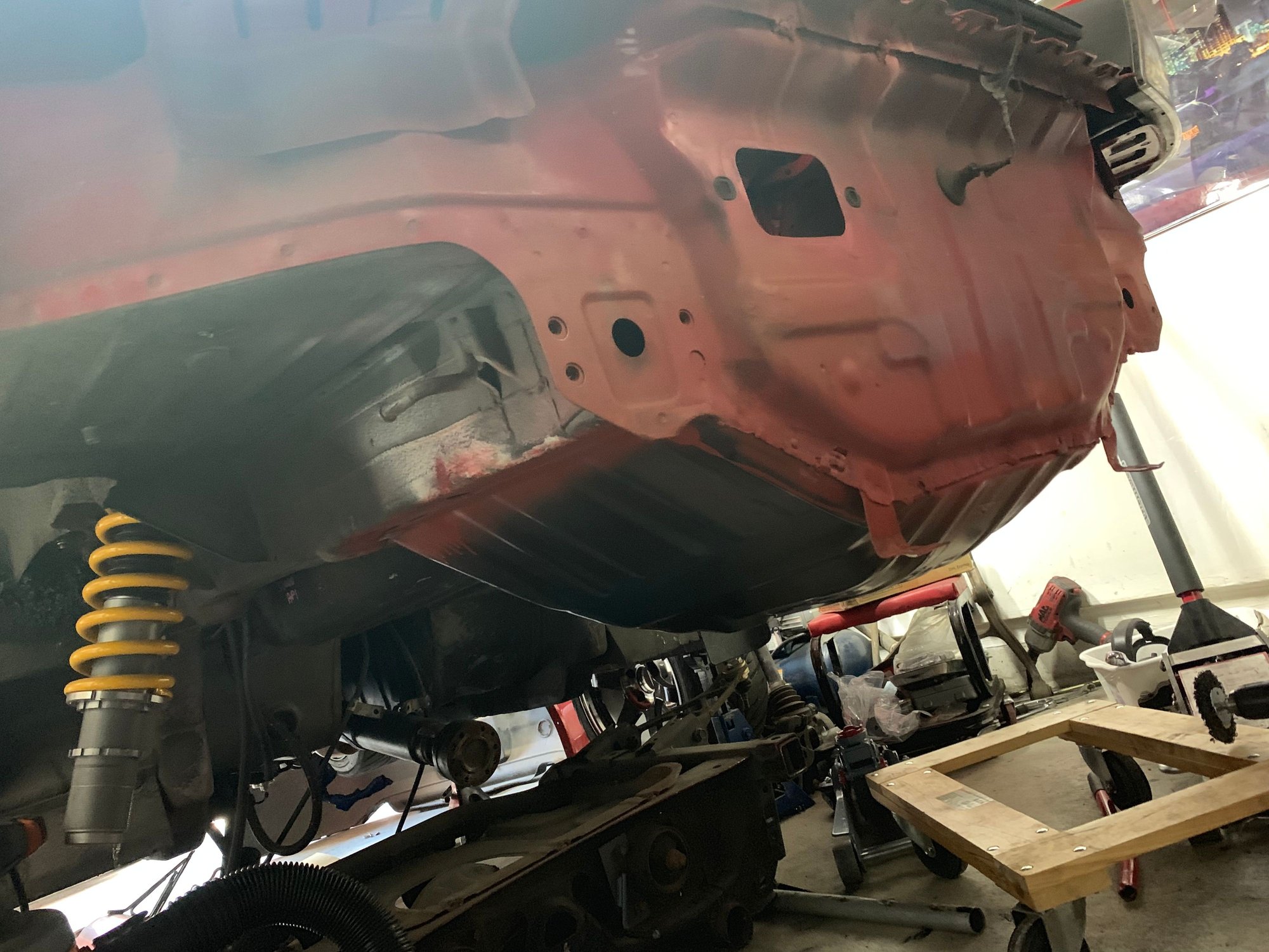

Time to bring out the big guns and give this trunk resto the full send.

Primed, Panel bonded and welded in I think I could’ve left welding out and panel bonded this. The panel bond flat surface to flat surface is strong as hell. This is now overkill. Will 3m seam seal and top coat after.

CR Trunk Reinforcement Goodies...might as well
Sealed and done
Loading up the new to me AP2 subframe.

AP2 subframe ready to be jacked up into place. Spoon collars and innovate mounts added to this setup.

80% Trunk carpet back in! Going to stop this and put the subframe back on soon.

Ap2 Rear subframe is in! Just need to torque everything down to spec and put the upper/lower/toe arms back in with new camber bolts.
debating on using an ap1 or ap2 rear sway bar. Leaning towards ap1.

I thought the AP2 rear was softer?

yes ap2 rear sway is much softer than ap1. So i’ll try the ap1 to start and work my way from there.
