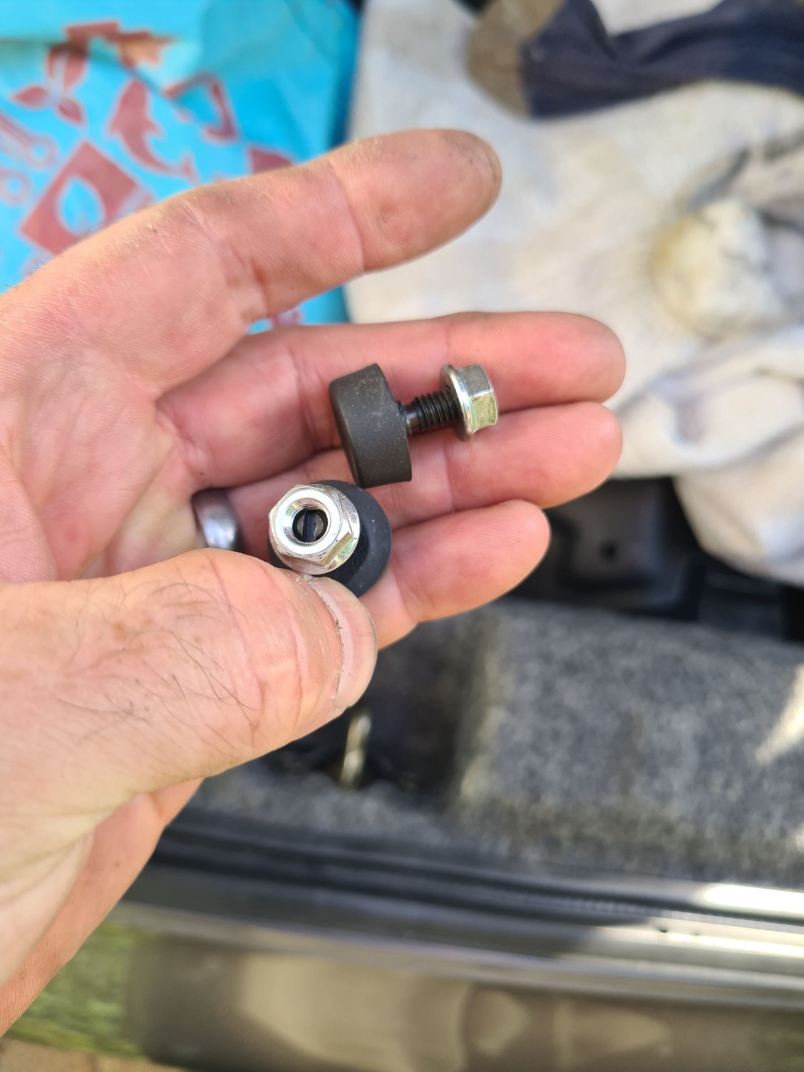

Putting car back together after it's been in pieces a while and even though I carefully stored them in a bag marked 'rear parcel shelf' I can't remember where they fit...that a rubber knob at the end of the thread. Thanks

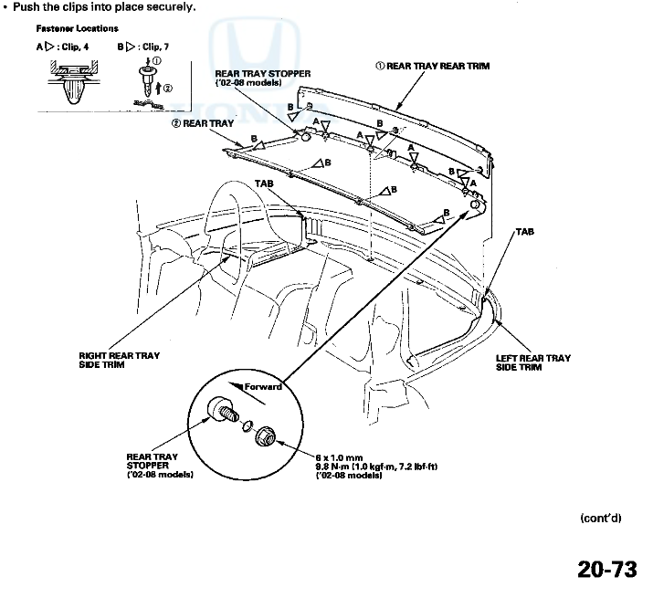

Did you have the soft top off? Looks like part 94 in the diagram, but could be way wrong - Soft Top Frame - 2006 Honda S2000 2 Door S2000 KA 6MT

Thanks for the reply Sam, I've only removed interior trim, so ot part of the roof assembly. I think they are an NVH device to stop something squeaking. Maybe.

Pretty sure they go on the rear corners of the parcel tray to hold the soft-top glass off the plastic - so your notes tie in with that.

Part #17 on the diagram, maybe? Diagram isn’t clear where it goes though. https://www.hondapartsnow.com/parts-...rear_tray.html

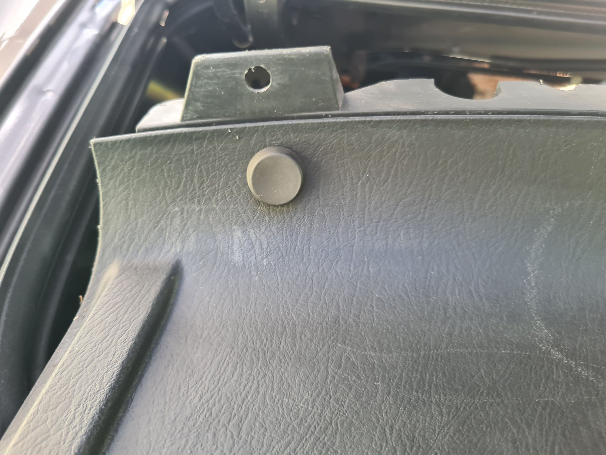

Found a better pic, like Ben said, corners of the shelf.

Just been cleaning that area after a few dusty top down outings, unfortunately roof back up and the rain streaming down at the mo otherwise I’d go look, seems like a good call although can’t say Ive noticed them there.

Thanks all, really appreciate the help, I'll stick it all that back in this arvo

Thought I'd post these in case it helps someone in the future...
