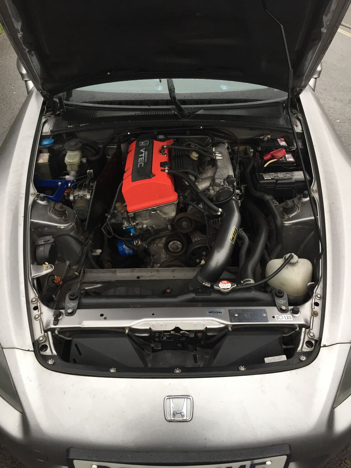

It's alive! All new bolts and new gaskets for the rocker cover.
New alarm board fitted and works perfectly.
Battery deep charged and now being topped up by an AA Solar Panel from
Amazon Amazon
Rear spoiler finally fitted.
Now trying to find a good fitting AP1 front lip spoiler in Silverstone, Honda have discontinued it. Seen this on ebay
Getting the bushes and new bolts fitted next week with the HSD's, the uprated rear lower brace and front lower brace.
Got a q300 to go on too!

All bushes replaced with Strongflex red bushes done
HSD coilovers fitted
new droplinks fitted
front lower brace fitted
rear lower brace fitted
gearbox tunnel brace fitted
Now for alignment today, to get vaguely inline
full geo and full corner weighting next week
Todo
heated seats
drivers bolster and seat refurbish
drivers side window seal
purchase of front lip
fit flybikeslee lips
full underseal treatment
and that should be it done mechanically!
I have heaps of spare bolts and nuts from the bushes ad I bought a whole new set from the US.

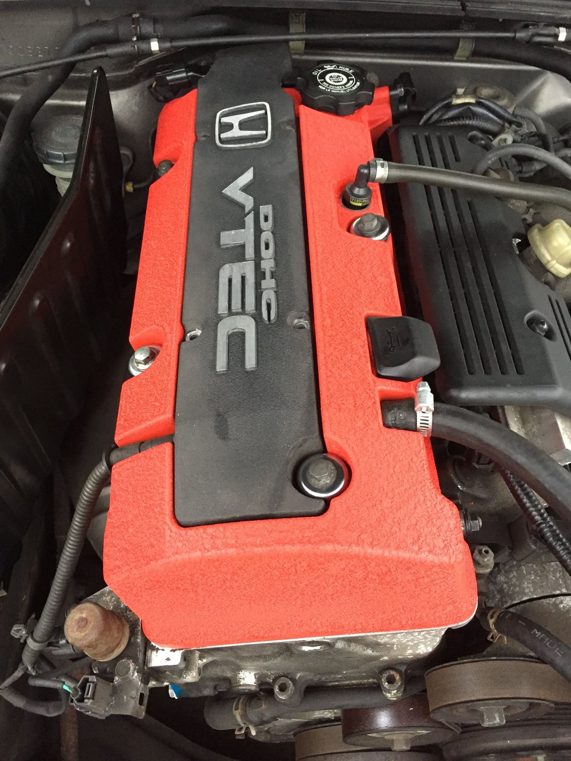

Quick shout out to Ross Dunn aka rd55 for the work and patience on the rocker cover refurb!
In the bay
I just need to clean up the spark plug cover now!
In progress!
