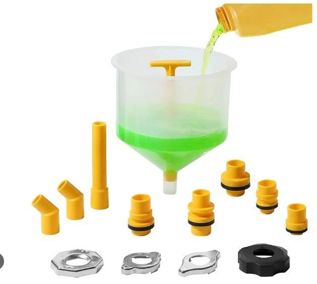

Can't find a good pic but this
It sits in the filler, you open the tap then run the car and it burps out air and gulps down coolant
Makes it very easy, when I swapped my rads I used it, without that you tend to get splash from the burps

Good idea, known as an anti spill or no spill funnel.

I use the universal one with the plunger/stopper and it has worked great on other vehicle. Getting ready to do mine as well on the S2000 in a few weeks.
