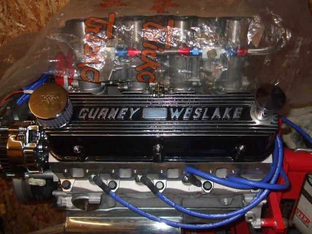

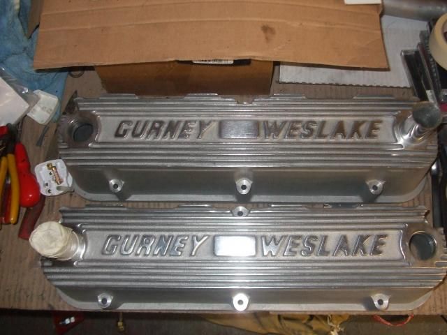

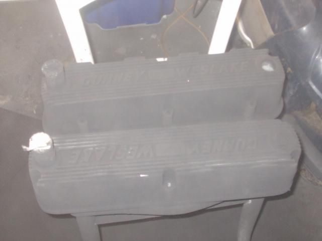

Apologies for the thread hi jack my set up was not as good as yours as I just used an old second hand oven here are the stages and results. The rocker covers were done in gloss and the aluminium panels Matt black.

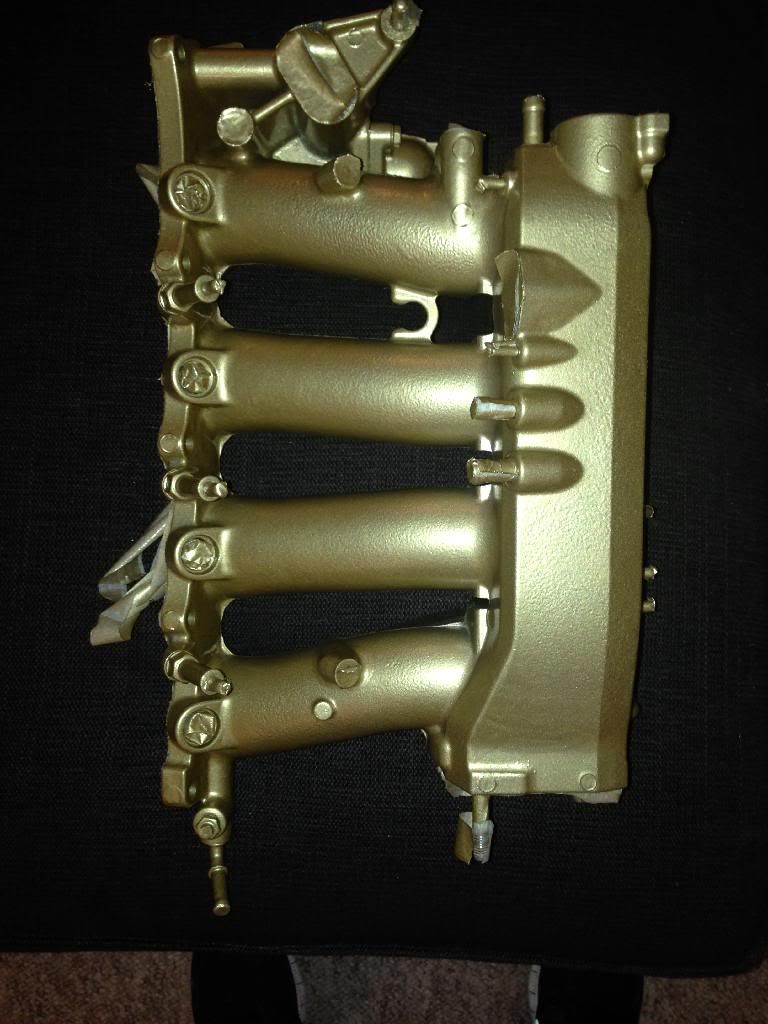

Here is my Inlet manifold from last night. It actually took me longer to mask up everything then it did to powder and bake!
One thing I noticed doing a part this big is that the little xbox fans aren't man enough to extract that amount of powder and my garage soon became covered! Always were goggles and a mask..
I'v now designed a much better spary booth design and will be picking up materials for it over the next week or so, will share once it's built and ready to take my rocker cover and if I get good enoigh the centres of my BBS LMs..
