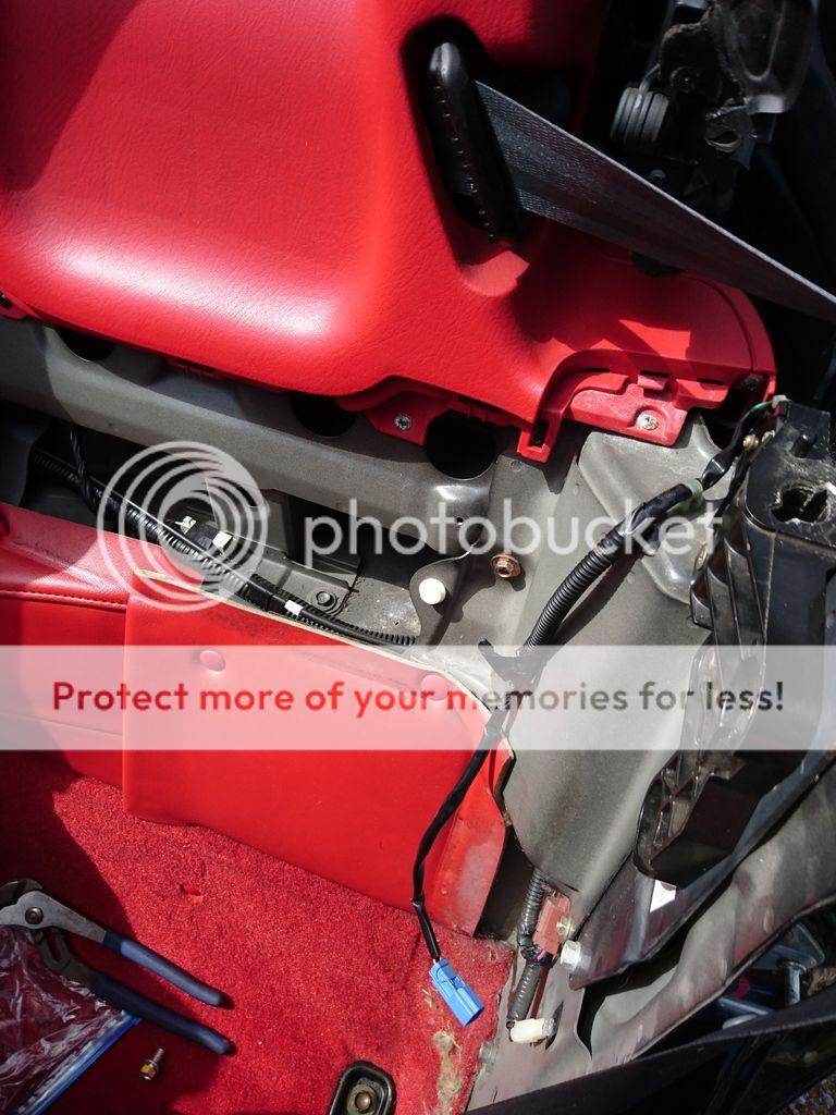

I recently bought a hardtop with a fitting kit. I installed the fitting kit, as well as some new hardtop strikers from Hendy. I assumed the fitting kit was complete but when I set about fitting it I found that it's likel I'm missing a harness to make the demister work. Can anyone advise what exactly I need?
Thre is a 2 prong female end on the hardtop fitting kit, a grey/white female end coming form the rear of the car. The Honda guide I used wasn't much help as it appears there should be an additional subharness. The car is a 2006 Irish car. Any help appreciated.

I'm guessing this is what I need.
Hardtop defroster wire harness

You're correct. This PDF should help.
https://www.handa-accessories.com/s2000/s2k2top.pdf
