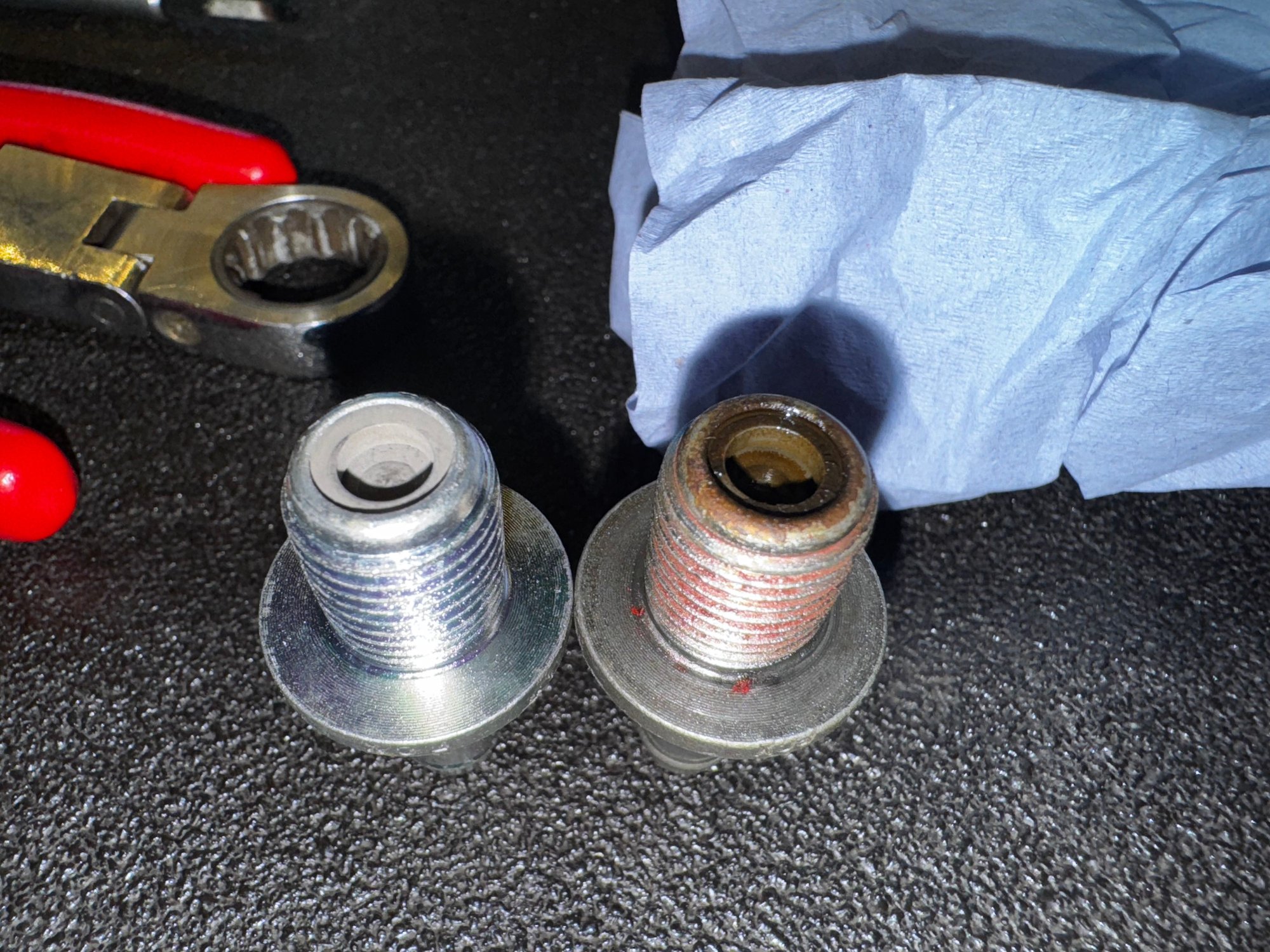

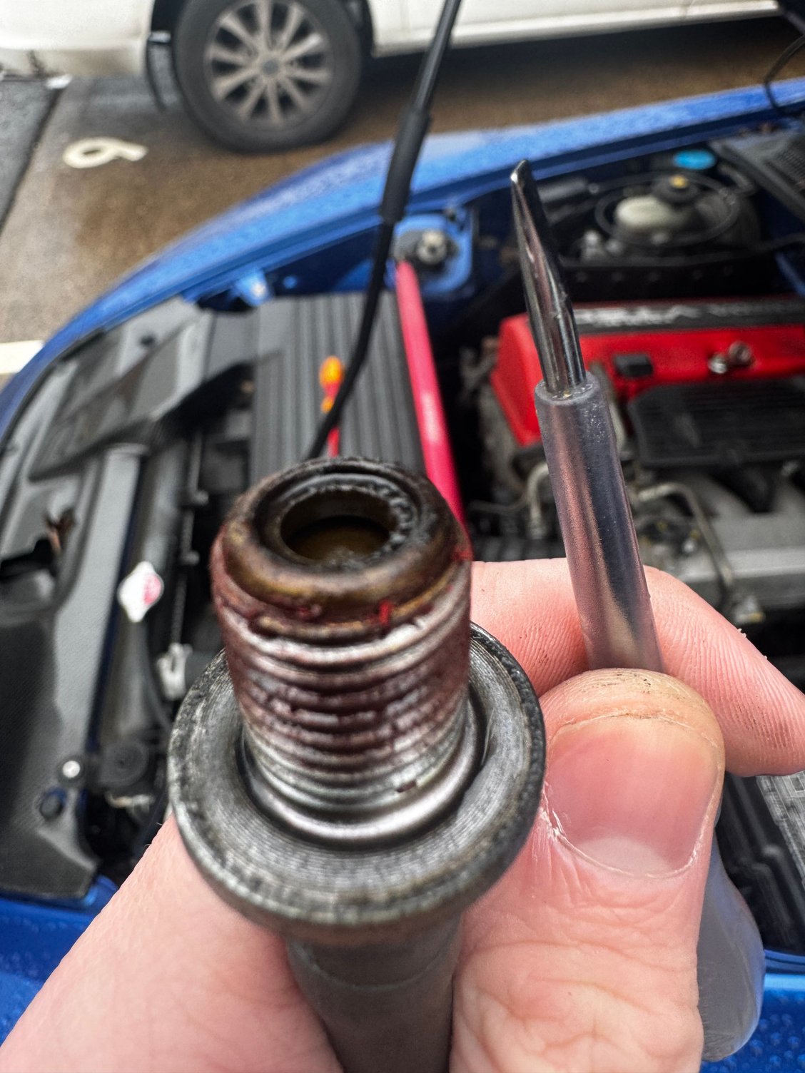

I can’t see that it’s had a valve clearance done in the past, however it’s had 9 or so stamps at Honda I would have liked to think they would have told the previous owners it needed to be done. I am hopefully planning to have it done over the Christmas period.
Changed the pcv valve, noticed that the valve was loose and not tightened into the rocker cover, may have been caused by me messing around with the pipe when trying to see if it worked, but i doubt it.

Blimey... Looks like anti seize on the thread, or copper slip. Neither is needed. Get it rattling like a snake, loads of cleaner blasted in.
