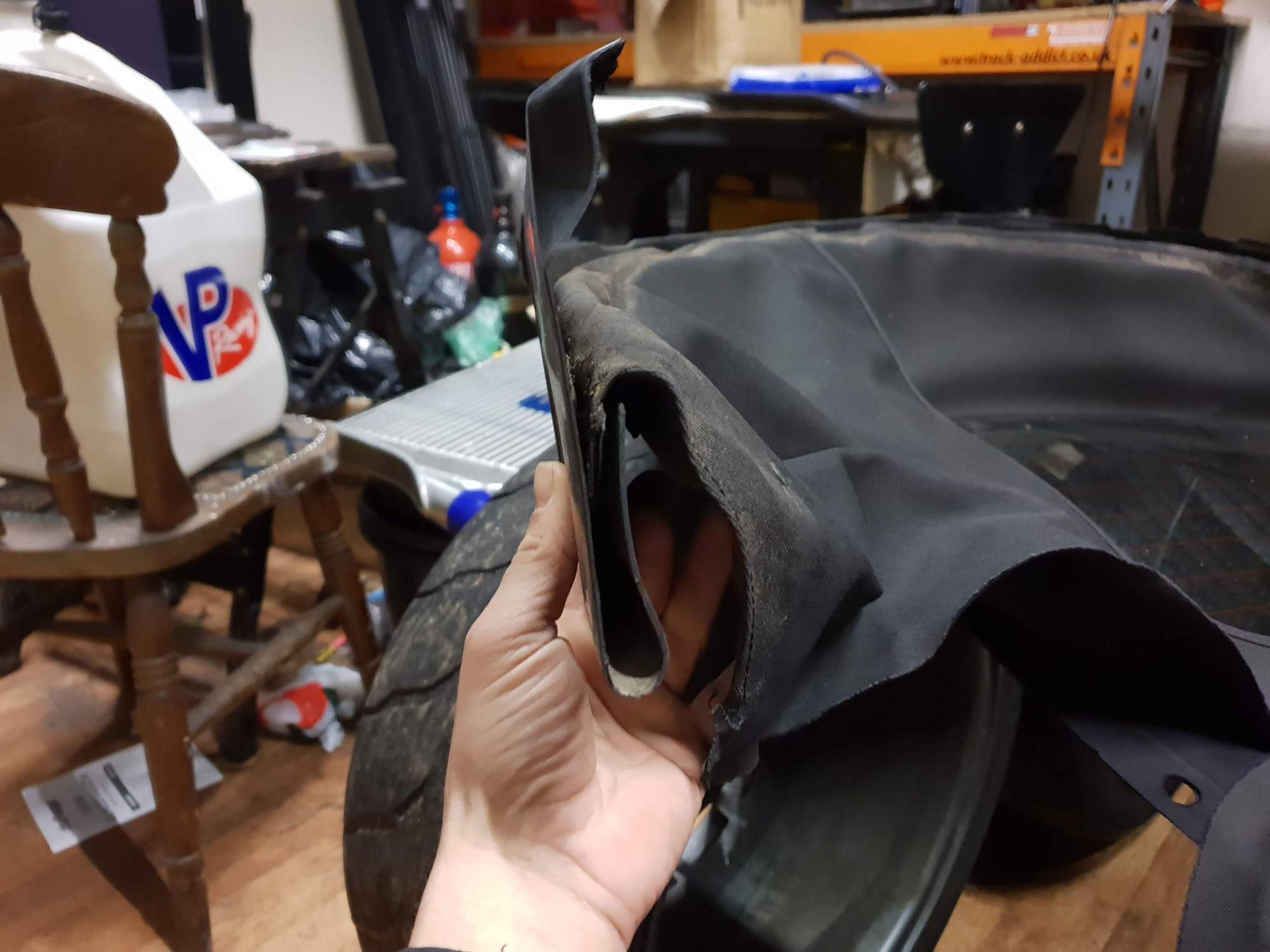

sorry for the late reply haven't been down the shed all week just been busy and crap pictures but should give you an idea of the roof drain
there is a plastic U formed and the fabric drains to the center of the U then drains around to the sides and down behind the plastic just behind the door jam, the roof is bolted to the rear deck using metal strips to hold it in place the coverd with plastic trim
this is the drain behind the plastics located just behind the door

The rain rail can leak after a new roof. For whatever reason when the rail is full, it can leak through the thread holes for the screws. Hence why in some rain it doesn’t get wet but other times it does. Bit of PU on the threads and nut back on should hopefully sort it (however it’s essentially refitting the roof).
The rain rail also needs to be tightly fitted under the recess of the body work to catch the water. One area which most replacement roofs have missed, is the front stud above the drain. The peg usually get broken and not replaced on install as it’s in a real awkward spot.
Drains. Keep em clean up top and below. Make sure the sill opening is clear. It’s not just the top plastic cup that gets blocked it’s the lower section from debris. I don’t have a picture of the location to hand, but I’m sure someone will.

Thanks Mike and mtunreal, the pics are a big help to understand how the roof is assembled and where the water is going.
It would seem that the water is leaking from the plastic u form somehow. Either way, i think it would need a complete roof overhaul.
