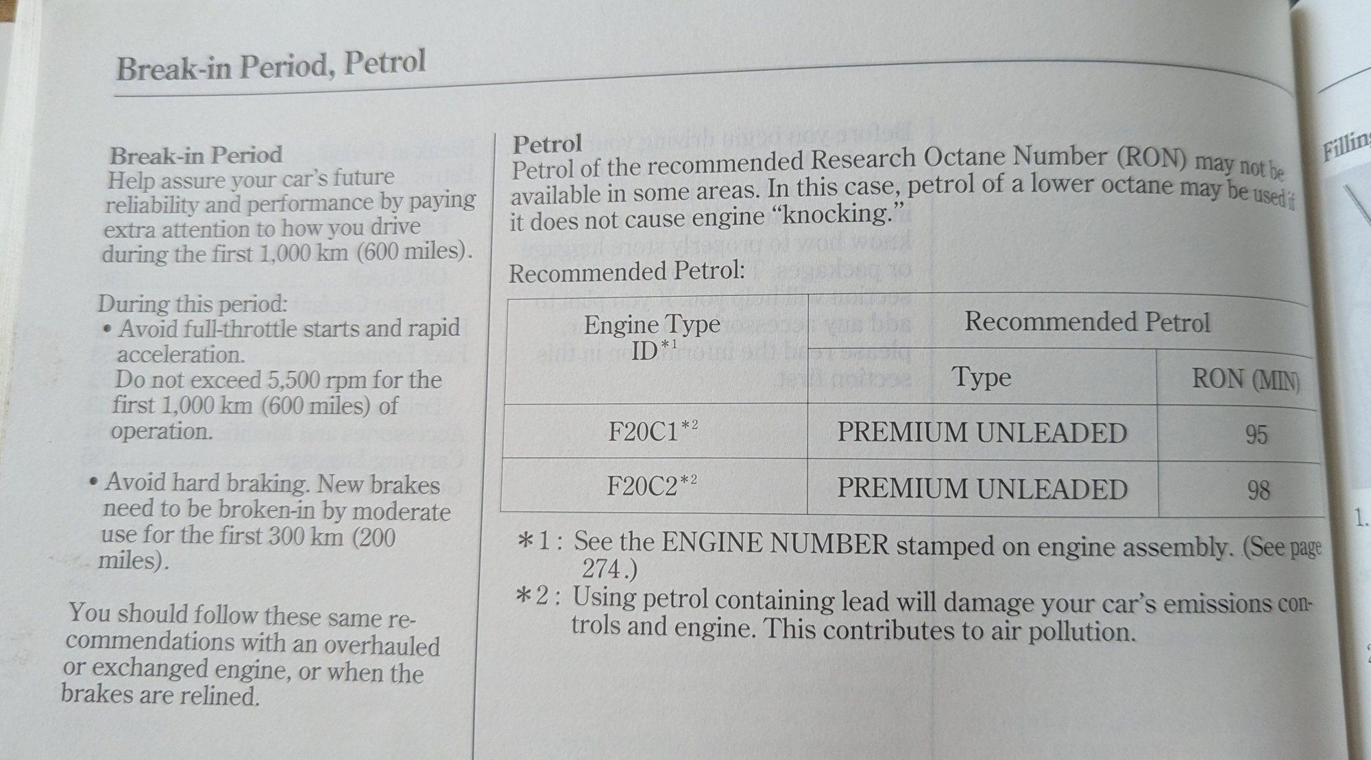

I got the engine version from the VIN plate, so I don't think it's a retrofit.
The fuel door says 98RON.
The manual:

Looks right, especially the fuel door sticker. (As noted mine just states "premium fuel.") I wouldn't know where my engine number is stamped on the engine assembly. Any idea where/when your car was imported to Ireland? Hard to put the proper fuel in the car when it doesn't exist! I see 98 ROM is recommended. Is there a "minimum" or "don't use below X octane"?
There's some discussion of the F20C1 vs F20C2 here. Looks like the C2 has a higher compression ratio.:
https://www.s2ki.com/forums/s2000-ta...-f20c2-688975/

It's a UK market car, as is most (all?) the other S2000s in Ireland.
I'm its first owner here, so the previous owners didn't have to face this situation.
I know there are a few of them here, so there must be a way. Or it will just run fine on 95, idk.
That's the only page in my manual about fuel.
It doesn't state an absolute minimum anywhere, just that note that lower octane fuel can be used unless it causes knocking.

It’ll run fine on 95. I run mine almost exclusively on 95 due to the nearest garage with 98 being 20 miles in the opposite direction to the good roads.
the one I had years ago got mostly 98 but when I had to resort to 95 there was no difference in how it ran.

Your car will run on 95 fine. If you come up to this end of the island you can put the rich stuff in her. There are a few on here from your end of the island. They always put the richer fuel in when they’re up for a spin.
