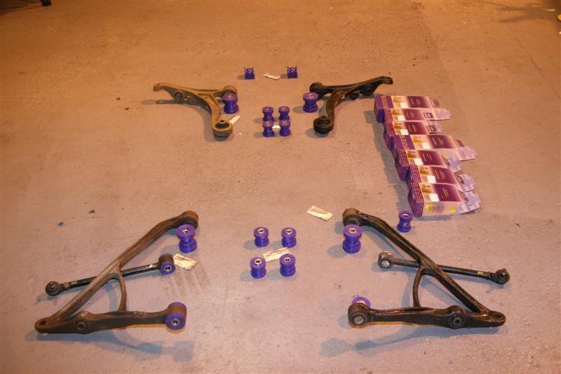

Chris had laid out a set of wishbones he'd sourced from Furbers together with all the poly bushes on the floor, in the shape of the S2000! This pic is from the rear of the car.
The bits in detail:
Rear O/S
Rear N/S
Front O/S
Front N/S

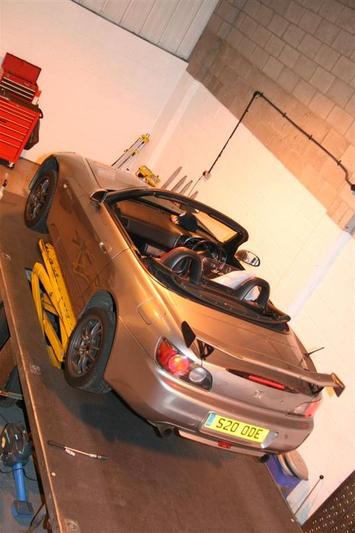

We got the car up on the Ramp:

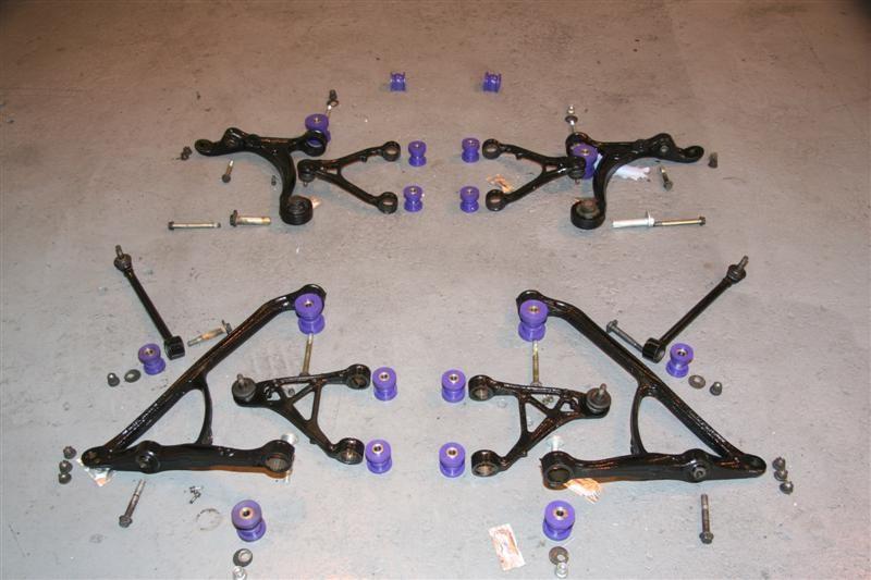

The next morning the arms were all nice and dry, and ready to have the new bushes put in them. We laid them out again, together with nuts and bolts...
The next job was to re-bush them all. Each bush is made up of the polyeurthane (sp?) outer, and a machined metal inner 'collar'. We coated each outer with copper grease and pushed them into place. Then the collar was copper greased and inserted into the purple outer. Each bolt was also greased and pushed in and out of the collar to grease the inner. (No squeaks required!)
We discovered that you have to be careful to have the thin side and thick side of each of the poly bushes the right way round... Thick part outside, thin part inside... A polybushed arm (this was before we noticed the thick/thin issue!):
And all of them complete:
