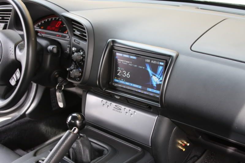

If you get the slim digital gauges you can fit them in the door like the Ricks. I can't remember the make of the original gauges - Nordskog Street Series digital they were awesome - these look similar
Depends on the ECU you are running - but you can get a windows tablet or something - and fit a JDM bezel like this one. This is the one I prefered as it then gave you full access to the ECU too.

Look at the Modifry dash mount here - minimal amount of cutting and a nice neat install. The mount would easily work with a larger tablet - you just need the right Brodit mount - here's one for an ipad mini: https://www.amazon.co.uk/Brodit-Passive-Holder-Swivel-Retina/dp/B00HVBC00E/ref=lp_1776802031_1_3?srs=1776802031&ie=UTF8&qid=1 499177266&sr=8-3 and here's the whole range: https://www.brodit.co.uk/
