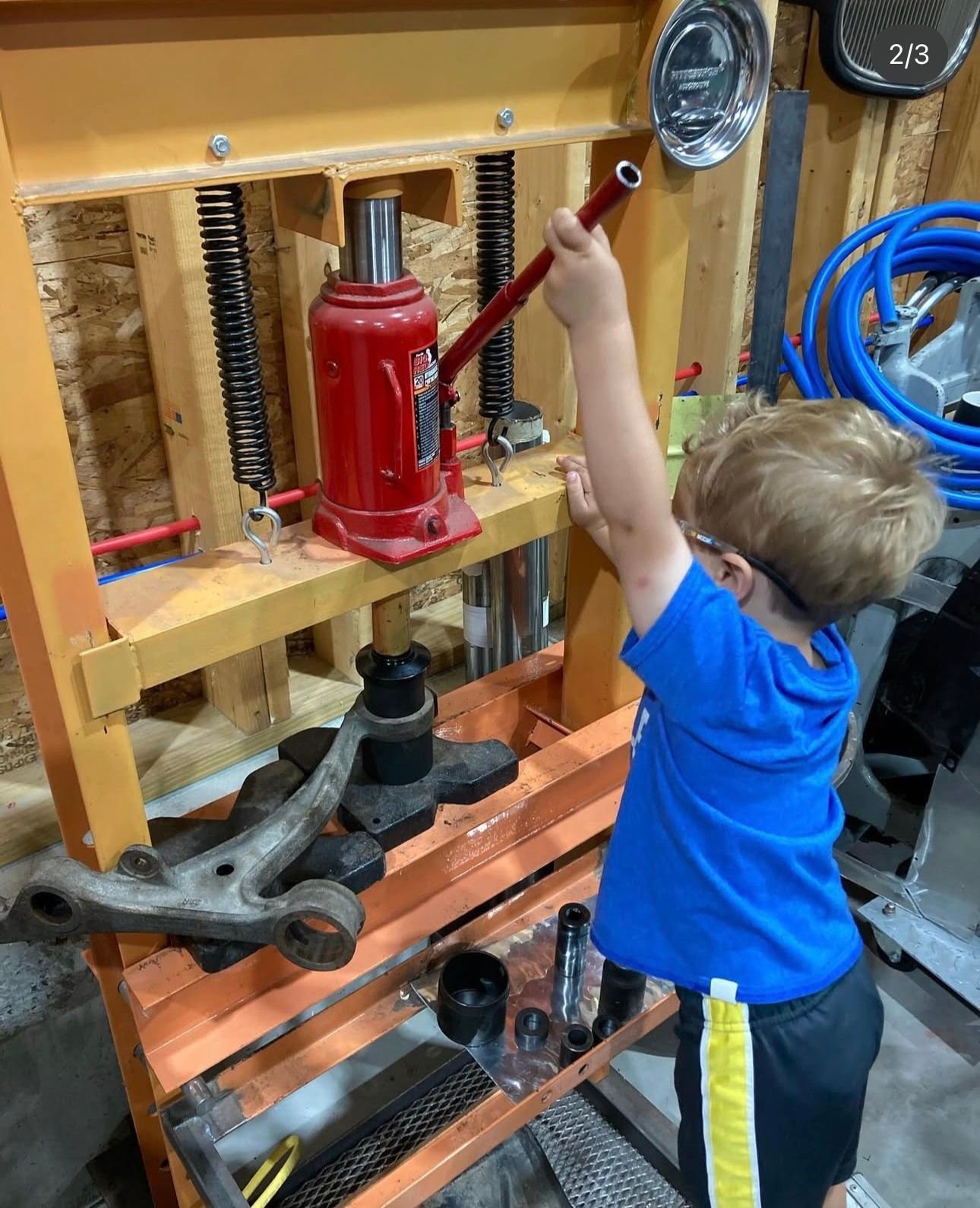

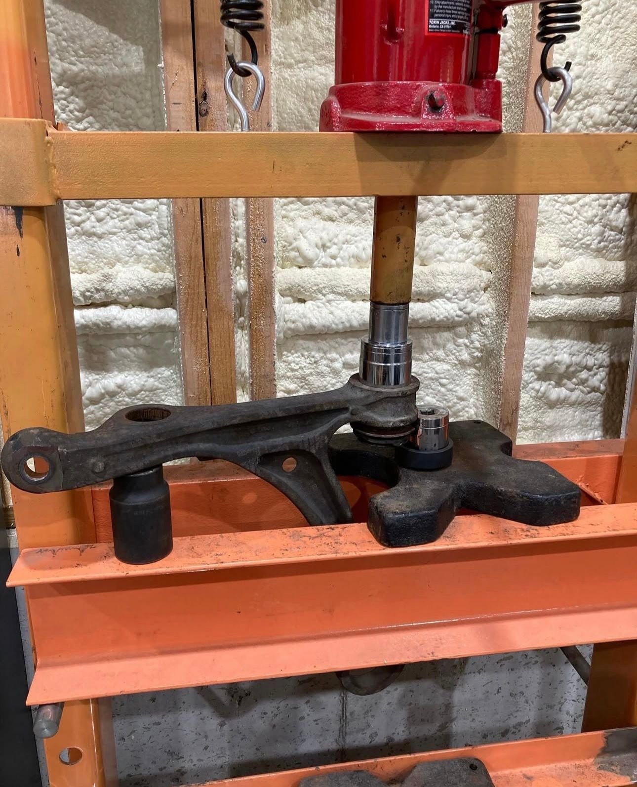

This is how i do the bushings using a press and what i use to space them up / press them in/out. Use a chisel on the front bushing to pry up the lip so you can get a socket under it to space it up (1st pic). As others mentioned use a little grease when pressing the new bushings in.

Thanks for the chisel tip. Good pictures too. I think the wife might have something to say if I gave my kids the first go on a £70 press from Temu. Maybe let them do the second side.
I was planing on using either aluminium or ceramic grease

Superb pictures them, child's play and easy eh?!
Good installation here, but those sockets are imperial ones. I'm sure however some metric / cylinders from bushings kit will fit.
