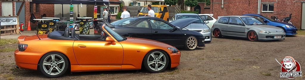

This is how it was, now it's 1 cm higher:
Bubbels** is offline   Reply With Quote

This is about the most you should lower your car before it starts to adversely affect the handling or start to cause you problems on bumpy roads:
lovegroova is online now   Reply With Quote

^ Mine was actually already lower than that when it handled so good.
It also felt better in every way compared to the original shocks and springs once I installed my KW V3 kit and lowered it the first time, that's why I was having trouble believing 1.5 cm can make such a huge difference.
Nice wheels btw
