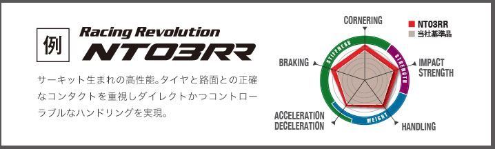

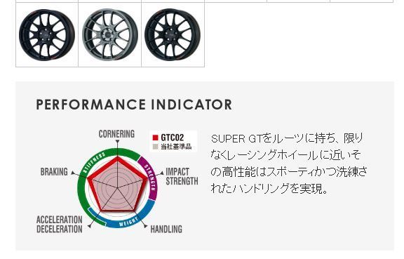

In addition to the RPF1 being a bit bendy it is also not a very rigid wheel. Sacrificing a bit of weight to increase rigidity is worth it as you'll lose less camber due to wheel flex when cornering. There is a reason you don't see the RPF1's used often in Japanese time attack even on Enkei sponsored cars. Enkei themselves don't list the cornering performance (stiffness/rigidity) as particularly high on the RPF1. I think in order to hit the target weight of 17-18lbs in a cast 17x9.5 wheel you'll have to make the same sacrifices and by doing so a heavier 19-20lb wheel may perform better
Not scientific but..
RPF1:
Compared to the heavier but more rigid GTC02
