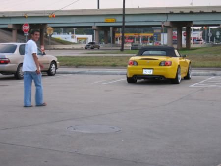

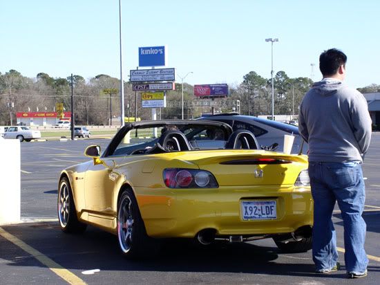

This may not be exactly what you are looking for but here are the pics I always post:
The wheels are 18x8 in the front and 18x9 in the back. Rear offset is +55 and the rear tires are 255. Hopefully the pics will help. The wheels are not all the way to the edge of the fender but they are close. I think if I was lowered more than an inch and a half, I would rub.
--Mark
