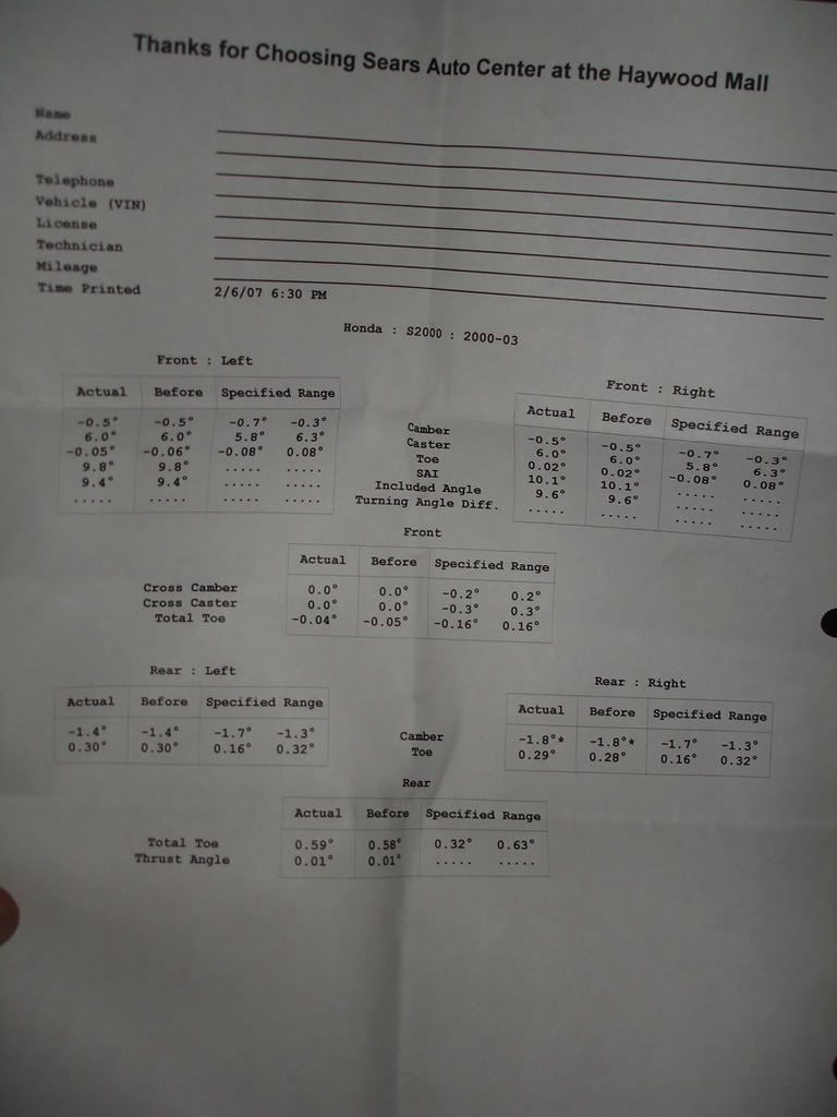

Okay, please bear with me I will try to explain this as easily as possible. I have Tein S-Tech springs (approx 1 inch drop) and now I got my new 17 inch wheels mounted, 245/40/17 in back and 215/45/17 up front. Big deal right. So I go to where I work at Sears and get an alignment and I ask the guy to put it back to factory specs thinking that would be the thing to do. So he does but I leave and now when I accelerate it pulls to the left some, and my steering wheel was off a little bit as well. So when I came to work today I dropped it off and the guy said he would do it again. So he did fix the steering wheel. But it still pulls to the left! I don't know what else I can do. I'm going to take it somewhere else now I guess but what do I tell this next place? Should I be asking them to put it back to stock or what? All I want is for it to drive straight lol! I need this figured out by this weekend as I'm going out of town and I'd like to have it worked out.

do you have the alignment spec sheet from the alignment?
Old Feb 6, 2007 | 08:00 PM
AndyThomason's Avatar
Joined: Jun 2006
Posts: 3,924
From: Greenville, SC
yeah here is the before and after from the first time...

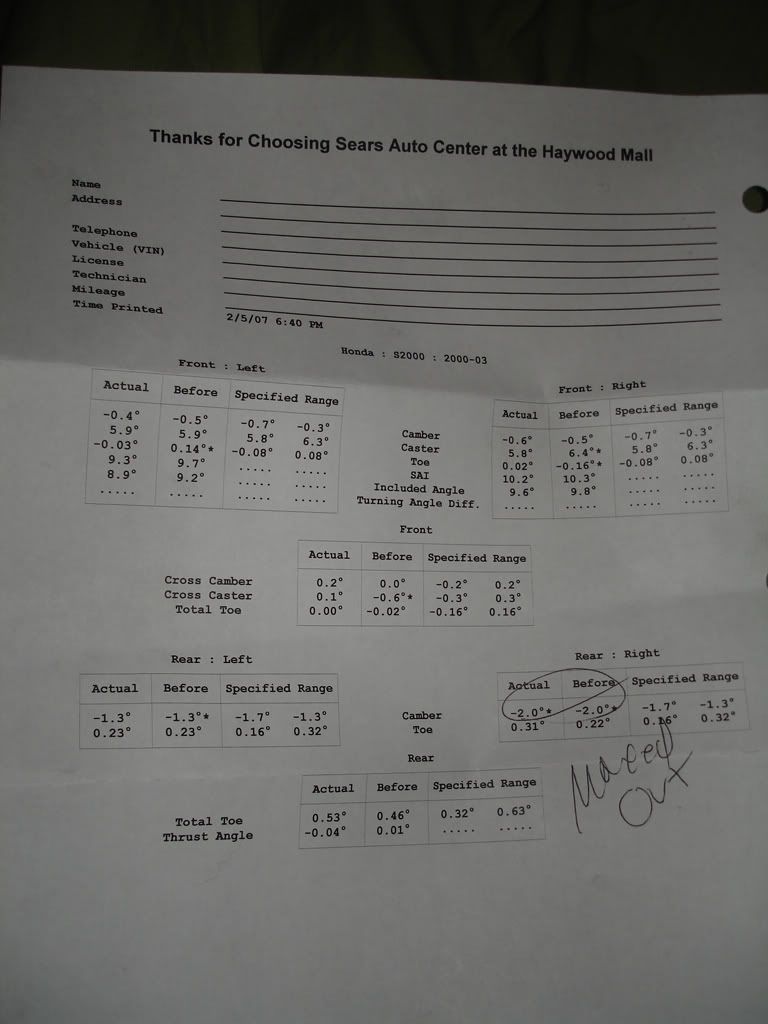

and here is the one from today...

everything looks good, except for the camber on the right rear. doesnt make sense how they couldnt get it any closer, doesnt make sense how they left it uneven from left to right also.
i would try going to a alignment and chassis specialist to see what they think, i'm out of ideas

so you think that could be why it is pulling to the left then...hmm ill take it to a perf. shop tomorrow hopefully. thanks for the help

really, i'm not sure.. it just looks funny, especially since on the first one they said it was maxed out at -2
