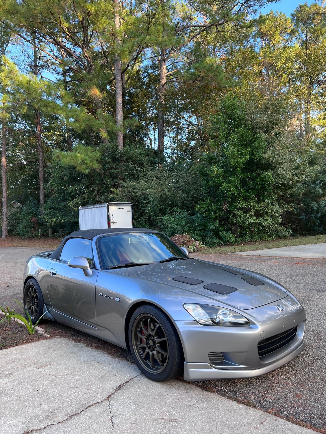

I have the exact same set up. They are for sale too bad you are in the EU
