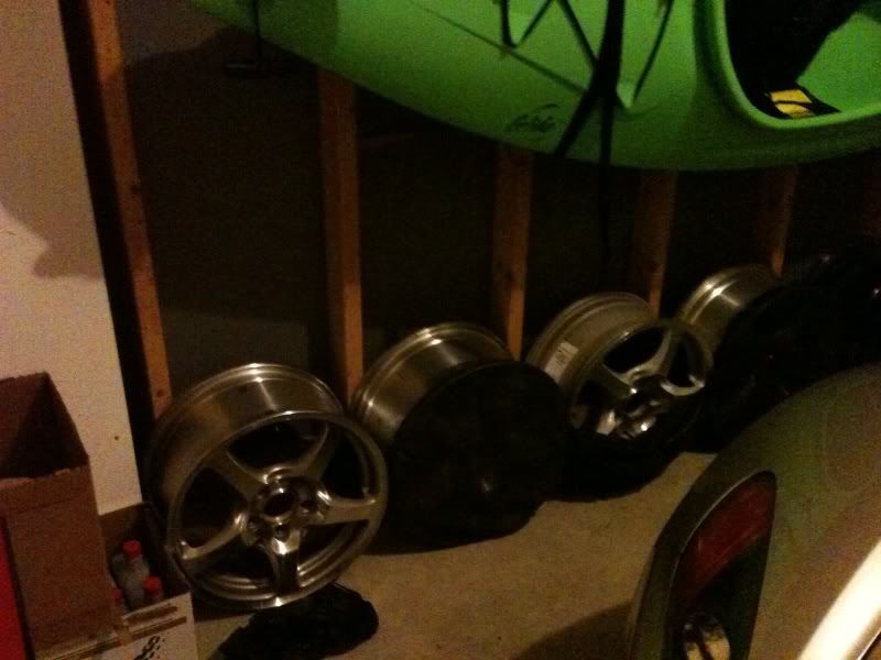

Quick pictures with phone. sorry for bad quality. But here's proof.

Ah ok, so if yougo but "the book" they are 6.5 and 7.5
But through a tape on there like in the pics, they are 1" wider

Want to make another staggering discovery? Measure AP1 wheel diameter and you'll find that they are 17" or a bit more.
The standard convention for wheel dimensions is diameter at the bead seat (not the outer rim lip) and width from INSIDE lip to INSIDE lip (clearly 7.5" in the pic above).
So it's not shocking that the maximum outside dimensions of a 16x7.5 wheel are 17" in diameter and 8.5" in width.
