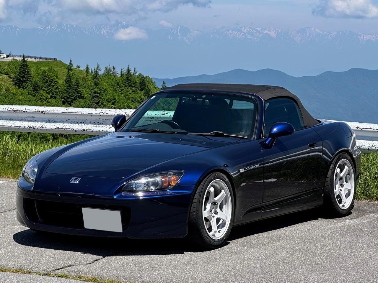

I am looking for a set of staggered 5-spoke wheels that are similar in style to the 5zigen FN01R or Gram Lights 57C in gold or bronze. Is there anything currently on the market in sizes that actually work with our car? I am not interested in fender mods or anything like that. I don't want the wheels poking out the side of the car.
I came across the Advan TC-4 which look promising since you can get offsets in the 50s and 60s, but I don't love the colors available especially with the shiny lip detail. I could refinish them but that adds another $800-1000 to the cost. Seems like too much for cast wheels.
I was thinking about the Mita MS-10 because the sizes are so good and they're forged, but they almost look a little too overly-styled for my taste. I just want a simple 5-spoke with a lip.
I have Regamasters on my FK8 type-R which I absolutely love, but I don't see them offered in proper s2000 fitment. The spoon wheels are cool but I can't stomach the price for a set of matte black wheels, and I don't seem them offered in any other colors.
Are there any options that I am overlooking? Appreciate any feedback!

The 5S ins't bad, I was hoping for something with a bit more lip profile, like the Enkei TS-5 for example. Not a fan of the flared spoke on the AP2V3
