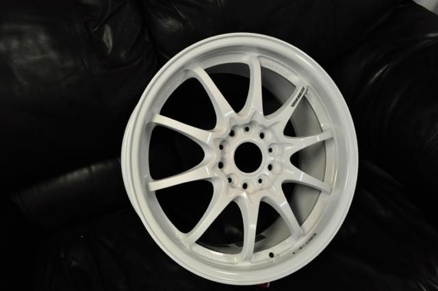

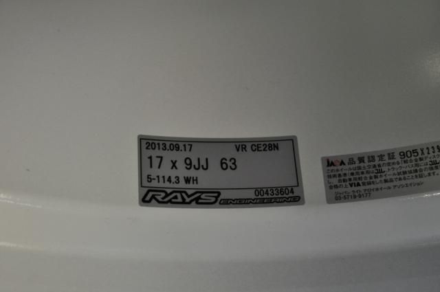

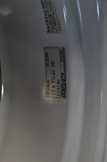

i know you are interested in a red set but i have a brand new set of in box CE28N in white in 17x7.5 +50 and 17x9 +63 no fender rolling or anything needed for this set up and i have these in my hands. no wait time if anyone is interested
