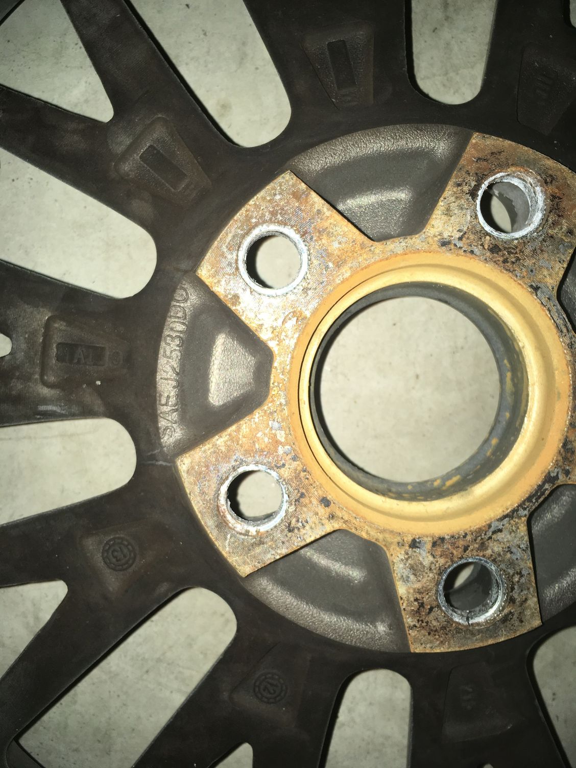

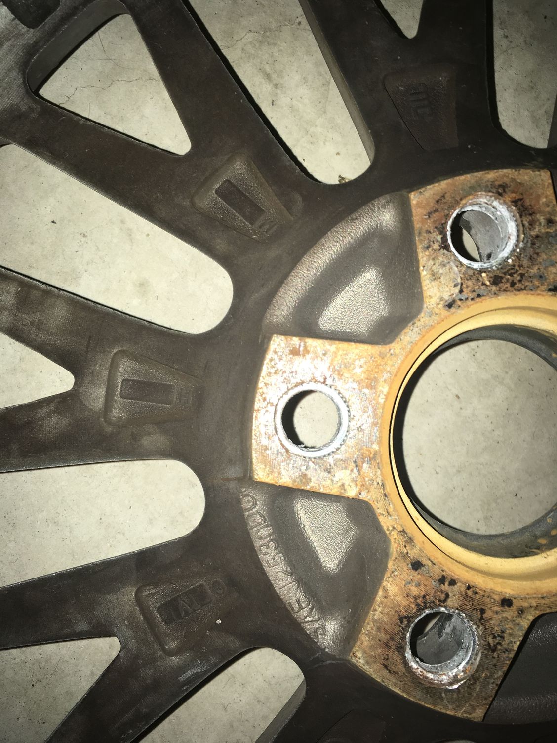

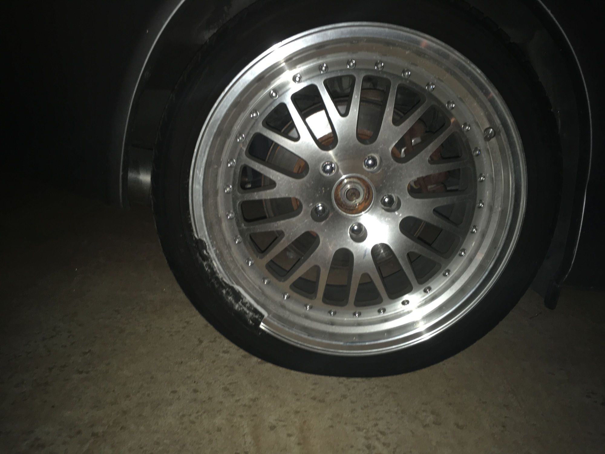

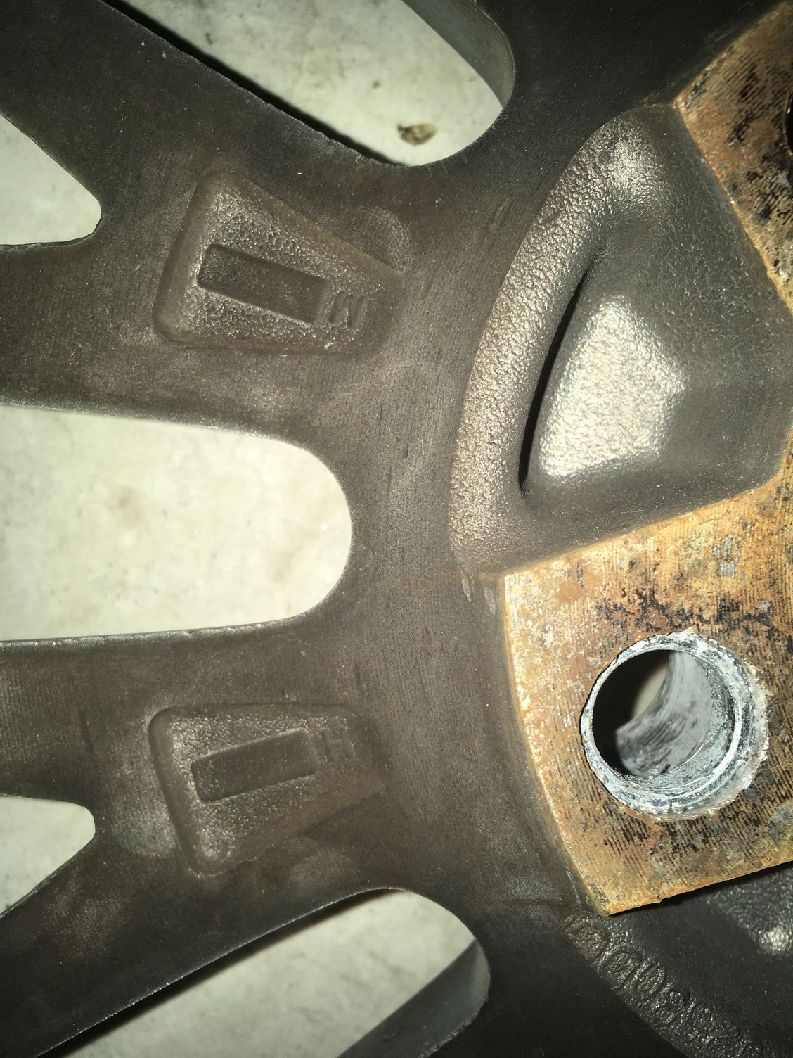

This why i need a new set, I can't find who makes this... been looking around for a while now. It had a CCW cover on the middle part, but it's just a replica, I bought it with these wheels, and now it's been two months and I haven't driven it once since and I'm starting to need it near the holidays. The best guess i have for these wheels are an older version of the STR 520, but really have emailed a dozen or so companies and it's not theirs. Here's all the inside stamps for that wheel. And I don't currently have more than 500 or so to spend on the wheels, so I'm in a sticky situation. My CURRENT fenders aren't rolled.https://cimg9.ibsrv.net/gimg/www.s2k...07450406d1.jpg

Manga_Spawn Dec 19, 2016 05:04 PM
Damn. Ok that makes sense. It looks like the offset is 40 possibly from your pics and thats what you were thinking. No matter what with unrolled fenders you shouldn't be running those wheels or anything with a lower offset. Your best option at this point is to find someone local with a set of OEM wheels with some usable tires. Those will fit and not run the risk of damaging your fenders like these or other low offset aftermarket wheels. You can then save for a quality sent of wheels and tires. AP1 OEM wheels are the cheapest and can often be found with decent tires. Sometimes you can find AP2 OEM wheels with tires for around $500.

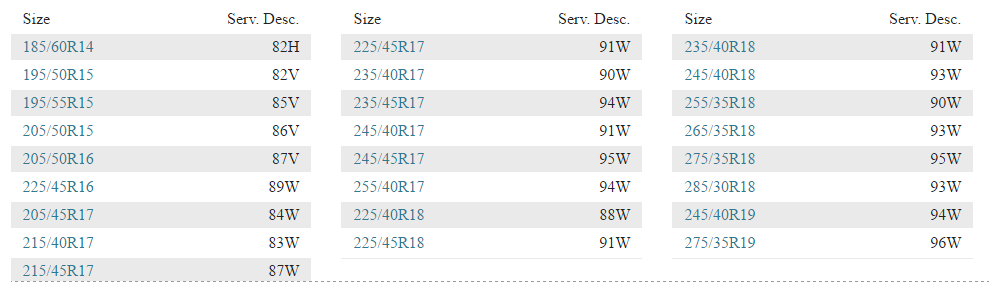

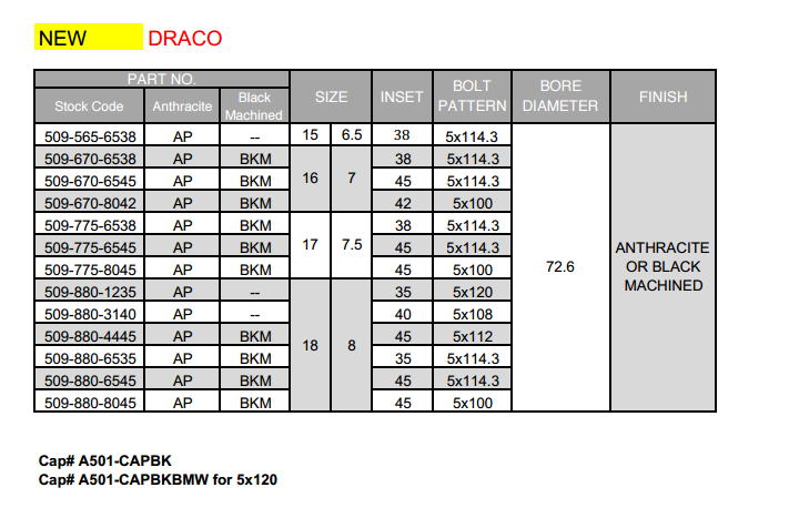

I'm looking into a new set of rims and wheels still and am looking at the Enkei Draco wheels and I want to put on Direzza ZII Star Spec. Here is a screenshot of the Enkei Draco wheel sizes - https://cimg7.ibsrv.net/gimg/www.s2k...7acfb8a0cc.png
And here is a screenshot of the Direzza ZII Star Spec sizing -
https://cimg6.ibsrv.net/gimg/www.s2k...5b4eaf066f.png
What would be the most optimal sizing for a autoX focused s2k?
