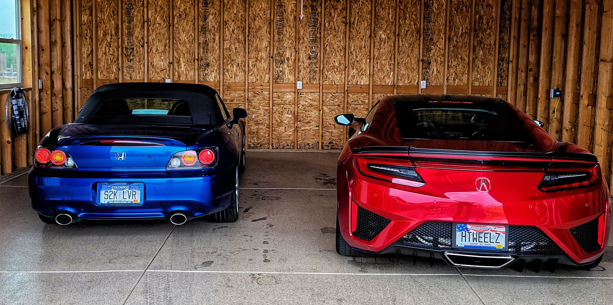

I had the same issue with my 2007 Laguna Blue but I hated the front tires so I replaced all four with Michelin Pilot Sport 4Ss. Yes, it was more expensive but SO worth it for the super grip of the new tires, in warm weather.
I also have a 2017 NSX and have the same issue once again; the fronts have lots of tread left but the rears are at the wear bars. I ordered all four Pilot 4S's on Tirerack and am currently waiting for them to arrive at the installer's. It does cost much more but I decided it was worth it for my driving experience pleasure. At one time I had different fronts and rear tires on my 2001 Silverstone. Never again! It wasn't intentional but was due to a screw up by America's Tires in Lancaster, CA. It was damn scary just driving in a straight line. So unexpected, too.
^Just for the NSX rears. The fronts were le$$ and in stock.
