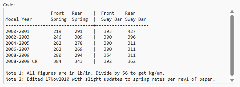

Well, you just got some Ohlins DFV in standard 10k/8k as well, right? You can fine tune the handling balance with the coilover knobs. Since you already bought them - i would say just run the coilovers and see if you can tune-in more of the tail happiness that you desire via the shock settings. If you desire more - then it's time to go square setup.
As far as stiffer swaybar, you don't need to go much stiffer. You can pick up an AP1 or CR front swaybar for cheap (like $50 on ebay cheap) - the stiffest of all generations. You shouldn't need to go much stiffer than that.
If you're curious about the different generation OEM suspensions - twohoos did a very very very comprehensive analysis of all of that. See this link.
https://www.s2ki.com/forums/s2000-br...prings-818884/

Debatable, but definitely for the 2000-2005 generations without traction control, it was just too much chassis for the average driver.
In the linked thread, there's a lot of discussion regarding engineering choices and hypothesis on why the suspension was revised so much over the different years including why the s2k is staggered in general.
