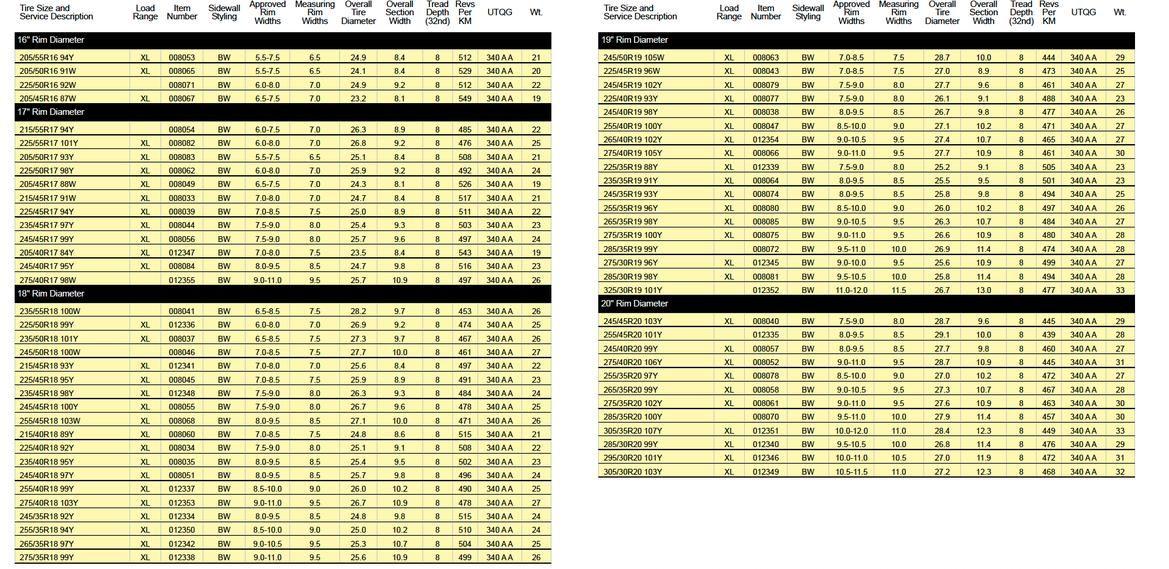

There is less on an AP2, stock was 215/245. CR was then what, 215/255 I think. which went back to AP1 stagger difference. They did beef up the suspension on the CR, and the stock tires on that were sticky.
Still goofy either way.
Actually, CR rear was actually closer to 245. Honda wanted the stickier RE070 for the CR. But it didn't come in a 245 size, just 255. But the actual width spec was barely any wider than the 245 RE050 on the regular S.
So Honda wasn't trying to have a wider rear tire on CR, just stickier all around.
If you're replacing tires on a CR, and you want to stay close to what it came w stock as to real stagger, you probably should choose 245/215, not 255/215.
