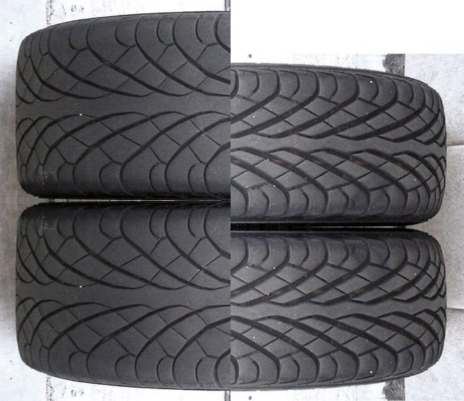

Now, the front tire was officially a 205/55R16 tire (205mm section width, 55% sidewall, 16" rim), and the rear was officially a 225/50R16 tire. Therefore we'd assume the rear tire was nominally 20mm (9.8%) wider than the front. The problem is this wasn't even close to being true. To see the real difference, let's digitally duplicate each tire and compare the two pairs:
And just to drive the point home, here's what they look like stacked flat against each other:
Folks, that's a lot more than 10% difference -- in fact, it's actually about a 15.3% "width advantage" for the rears! Again, this is not a photo editing trick: those of us who ordered new sets of these tires from Tire Rack can remember that they really did look like that when stacked side by side.

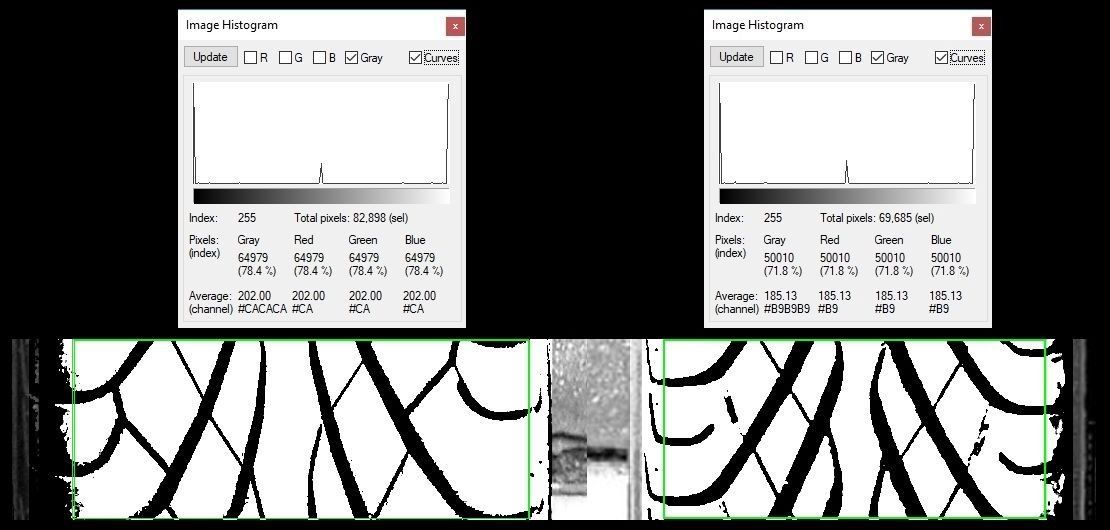

Finally, notice how wide the tread *gaps* are on the front tire, and how narrow the gaps are on the rear tire. This means that a bigger percentage of the rear tire's contact "patch" is actually touching the ground. So even if the front tires were the same width *and* the same shape, the rears would STILL put more "rubber on the road". I actually tried to quantify this by processing the tread images so that the rubber was pure white and the gaps were pure black. Then I simply measured the percentage of each tread pattern that was pure white. Here's what I found:
In the left side of the image, we see that over 78% of the rear tire's contact patch is actually rubber; but for the front tire, the percentage is less than 72%! That's a "tread pattern advantage" of about 9% for the rear tire!
So let's put all this together: The total "grip advantage" of the S02 rear is the product of all of its advantages: grip advantage = raw width adv. * shoulder shape adv. * tread pattern adv ~= 1.15 * 1.05 * 1.09 ~= 1.32. So the rear S02 actually put down a little over 30 percent more rubber than the front!

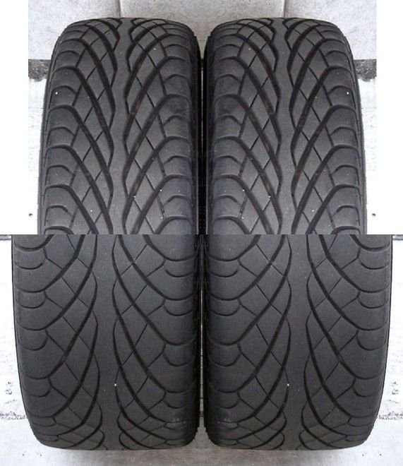

Finally, there's one more bit of danger inherent in the rear S02s: that narrow tread gap only got narrower as the tire wore down (and Honda advised owners it could wear in as little as 10K miles!). Here's a photo of a new one vs. a worn one:
That worn tire was fine in the dry, but it was a genuine handful in the wet. I vividly recall a white-knuckle highway drive on worn rear S02s in a rainstorm: I was hydroplaning at 45-50mph, while traffic around me passed serenely by at 70+.
