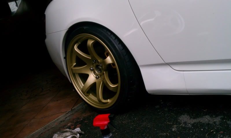

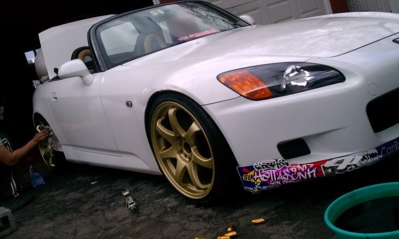

Old Mar 12, 2011 | 09:23 AM
s2k809's Avatar
Joined: Aug 2010
Posts: 148
My boy bought da same tires i have and we put them on and this is how it looks im thinking i will have to just roll and maybe pull a little.
