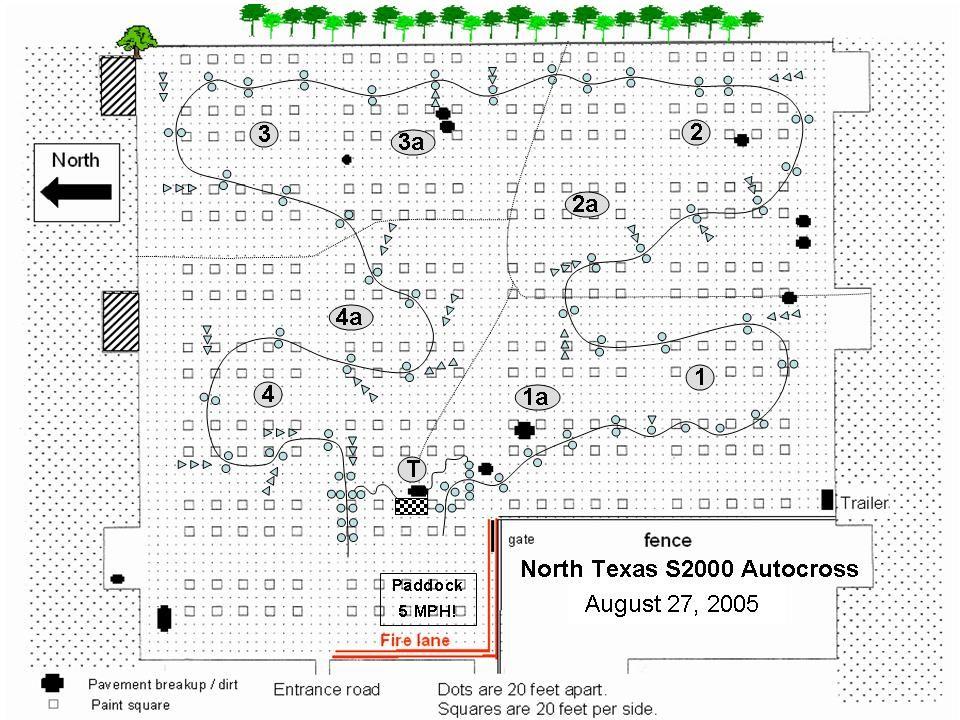

My gf and I did eight runs each in a 100% stock MY03 S2000 on new Hankook RS-2s this Saturday. We were both very unhappy with how the tires performed. The surface was 40 year old asphalt, and the course map is below.
The problem was immediately apparent - anytime the car was asked to transition from one direction to the other, it took an eternity to take a set and stabilize. It felt like the car had MUCH softer suspension. The rear was very floaty. I tried higher pressure (41psi) for runs 4 and 5, which just made things worse. Bringing it back down to 34psi for the remaining ones helped some, but the car still wasn't nearly as responsive as when it's on S02s.
Overall grip seemed good enough, and break-away was progressive. Neither of us had any spins the whole day.
