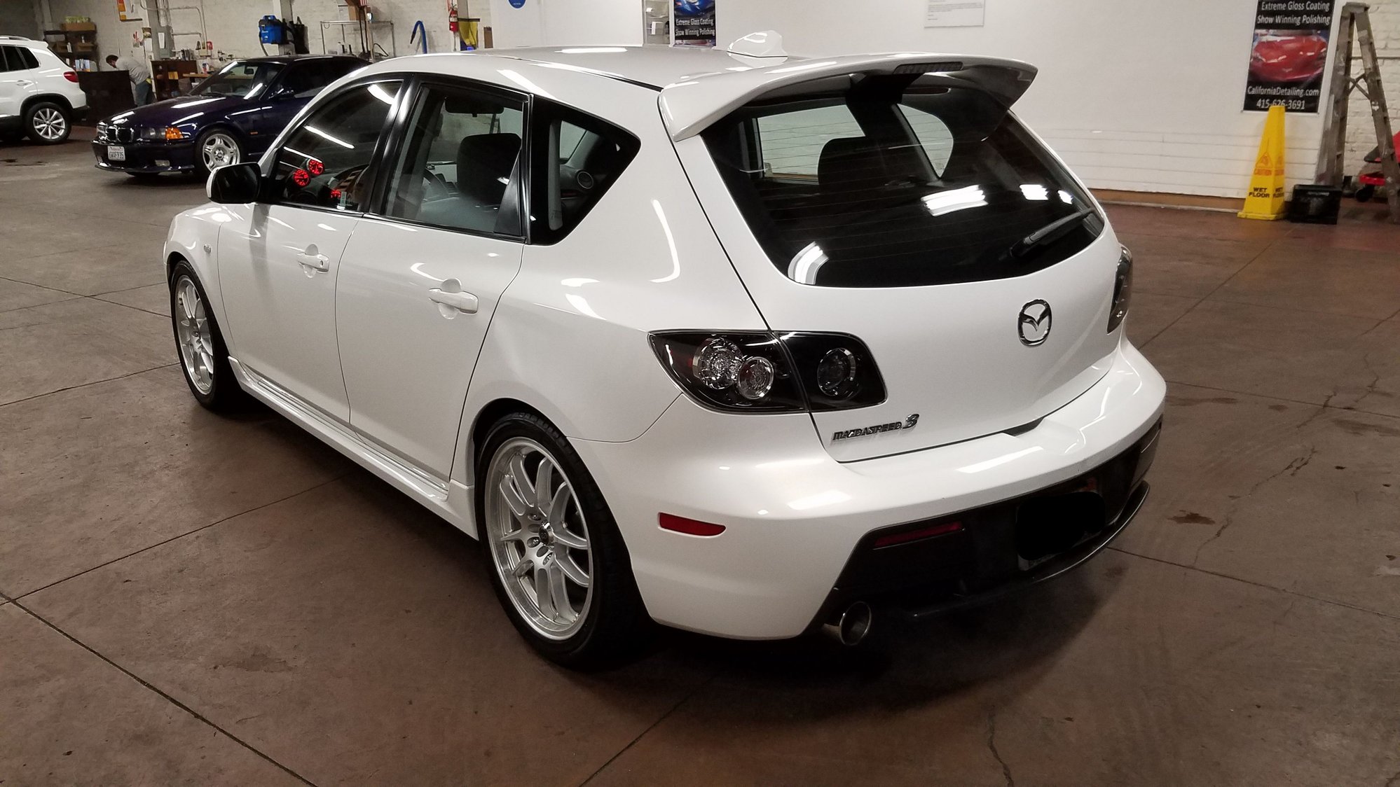

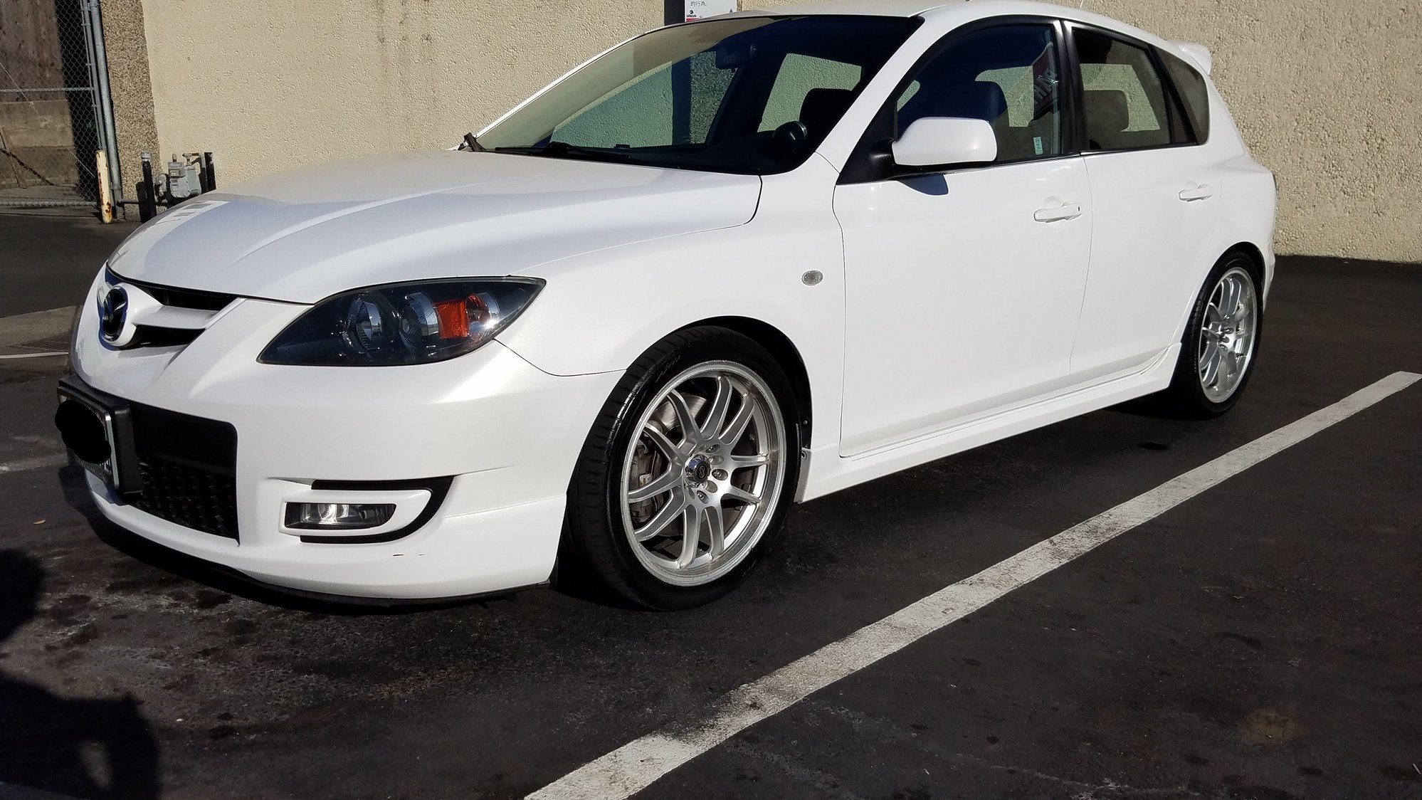

I can speak a little about KW's rebuilding process, outcome, and overall quality of the rebuilt coilovers. Granted, it was on a different car, but I think it applies to KW and their general craftsmanship.
Mazda contracted KW to build a set of V3 with specific spring rates and dampening force specific for the Mazdaspeed 3, these V3 were rebranded as "Mazdaspeed Accessory Coilovers"
I purchased a used set and put them on my Mazdaspeed 3. Unfortunately, shortly after I installed them, they had to be rebuilt.
- Contact KW support / [email protected]
- Fill out the tech sheet to your desire
- Ship your damaged dampers in. They asked for the dampers only as the shipping will cost less, and there are less parts for them to lose.
- Depending on your location, takes about a few days to get to their USA headquarters, in Southern California.
- They kept me updated on the rebuild process, and will promptly answer any inquiry along the way.
- My rebuild took ~1.5 weeks, round trip shipping... so the whole process took about 3 weeks.
Here's an example of the tech sheet they'd ask you to fill out:
At the time, my car had 64,000 miles. It's approaching 5 years and 43,000 miles since the rebuild, and I have had zero issues. Car currently has ~107,000 miles. This car is daily driven on the streets of San Francisco, with its expansive collection of bad roads and pot holes!
I believe the rebuild process should be similar with other major manufacturers, and they should be equally competent as well!
