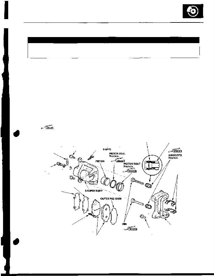

this is a picture of the front brake assembly. Doesn't look like there is too much to it. The rear looks a bit more intimidating due a lot more small parts, but I think I can handle it. I looked up the price for the "caliper assembly" which is all the rubber bits. $17.98 per caliper=$71.92 This is assuming that they cannot be reused. I guess if you have it all apart though it would be a good idea to rebuild them with new rubber.
I could use some advice from Chris, or Will right about now.

HRm... better news than I thought. I think it is a PIA for some reason I remember discussing that but they should chime in this evening to give some more info.

If you wan't to get the calipers powdercoated, you will have to remove them from the car, and completely disassemble and clean them. All the machined surfaces and threaded holes need to be taped off, and protected. Otherwise, you'll be removing powdercoating from where it doesn't need to be.
Expect to get a rebuild kit for all the calipers, as you'll need to replace all the o-rings and seals when reassembling.
Powdercoating the calipers will be time consuming, and not a 1 day swap.
This is the reasoning why Rick's stopped offering powdercoated calipers, and the fact that nobody was returning there original caliper cores.
Any part that you want coated has to be clean, and free of all old paint, or other coatings. OEM wheels have a very tough clear powdercoated finish, which needs to be removed in a industrial bead blast cabinet. My small home bead blaster won't touch the OEM clear'd wheels.
Figure part prep/cleaning before the coating is done.
