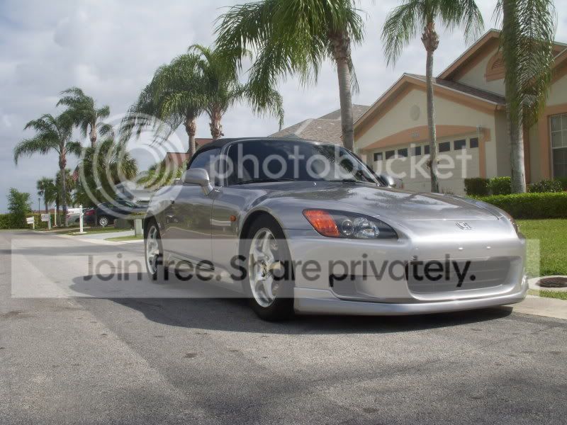

Early 2009: Purchased a 2000 Silverstone S2000 with 60k miles.
Mid 2010: Purchased ASM 04 Front Bumper, Front Fenders, and Rear Overfenders.
Finished Result. Molded FRP extensions on the side of the bumper to sit completely flush with the fenders. Molded rear overfenders as well.

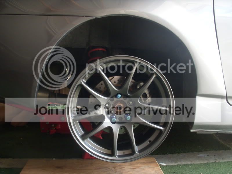

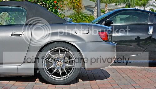

Work CR Kai's FR: 17x8 +25 RR: 17x9 +22:

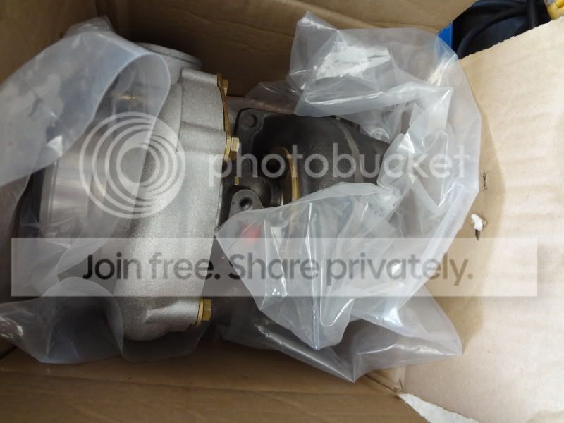

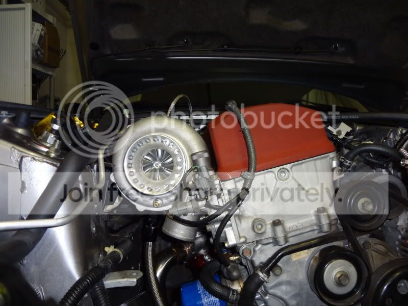

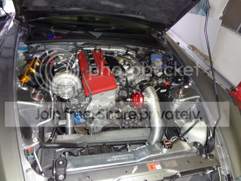

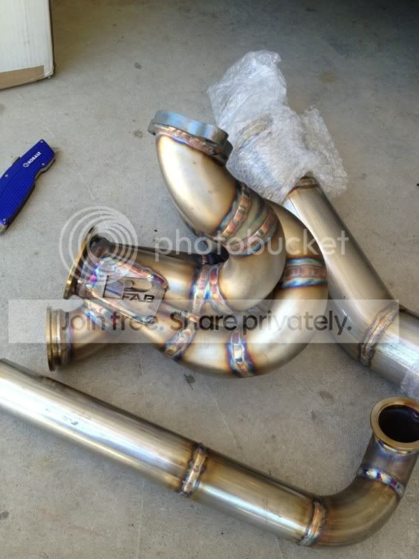

2012 and on: Started my turbo build. Purchased Supertech Dual valve springs and retainers for peace of mind. Fullblown Stage 1 turbo kit. (Log manifold, 38mm Tial wastegate, Precision 5857 JB Turbo.) I was only looking for around 300whp.
That lasted about 6 months. I then upgraded to a Pfab ELT vband manifold along with a Precision 6265 DBB vband turbo. Also, finally got rid of AEM Version 1 and replaced it with Haltech Platinum Pro Plugin.

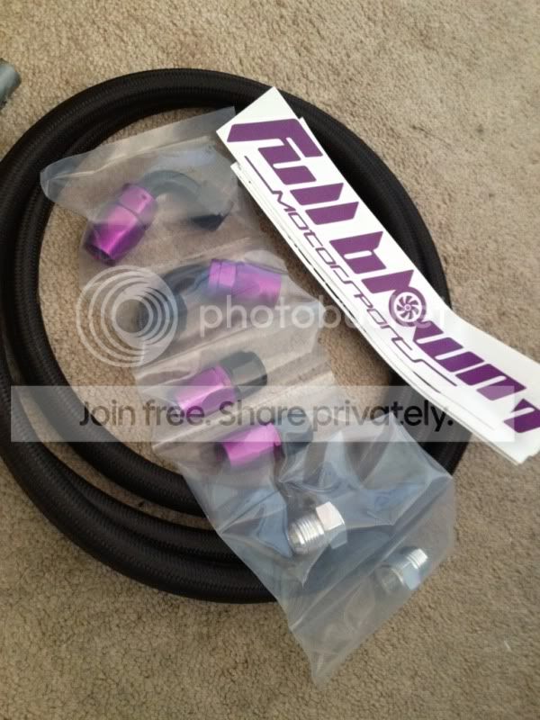

Fittings for the new catch can setup:
The car was first tuned on 93 Octane by Angel @ racelab. It made 450whp @ 15 psi on a dynojet. I was happy with the numbers but decided to go E85 since there is a station close to my house.
Final numbers on E85. Car was tuned by Kenny @ Turbogixxertuning. 550whp/376wtq was made on e85 and 22 psi. Still more room to go but I didnt want to push the stock block even though it could handle it. I was more worried about drivetrain. This was on a mustang dyno.

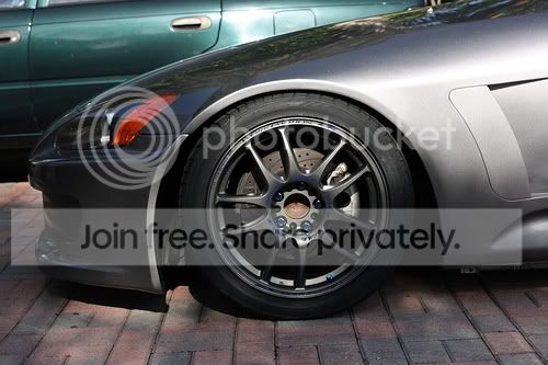

Start of 2013: Spoon Monoblock Calipers
Mid 2013: Parted out the turbo setup.
Volk TE37
