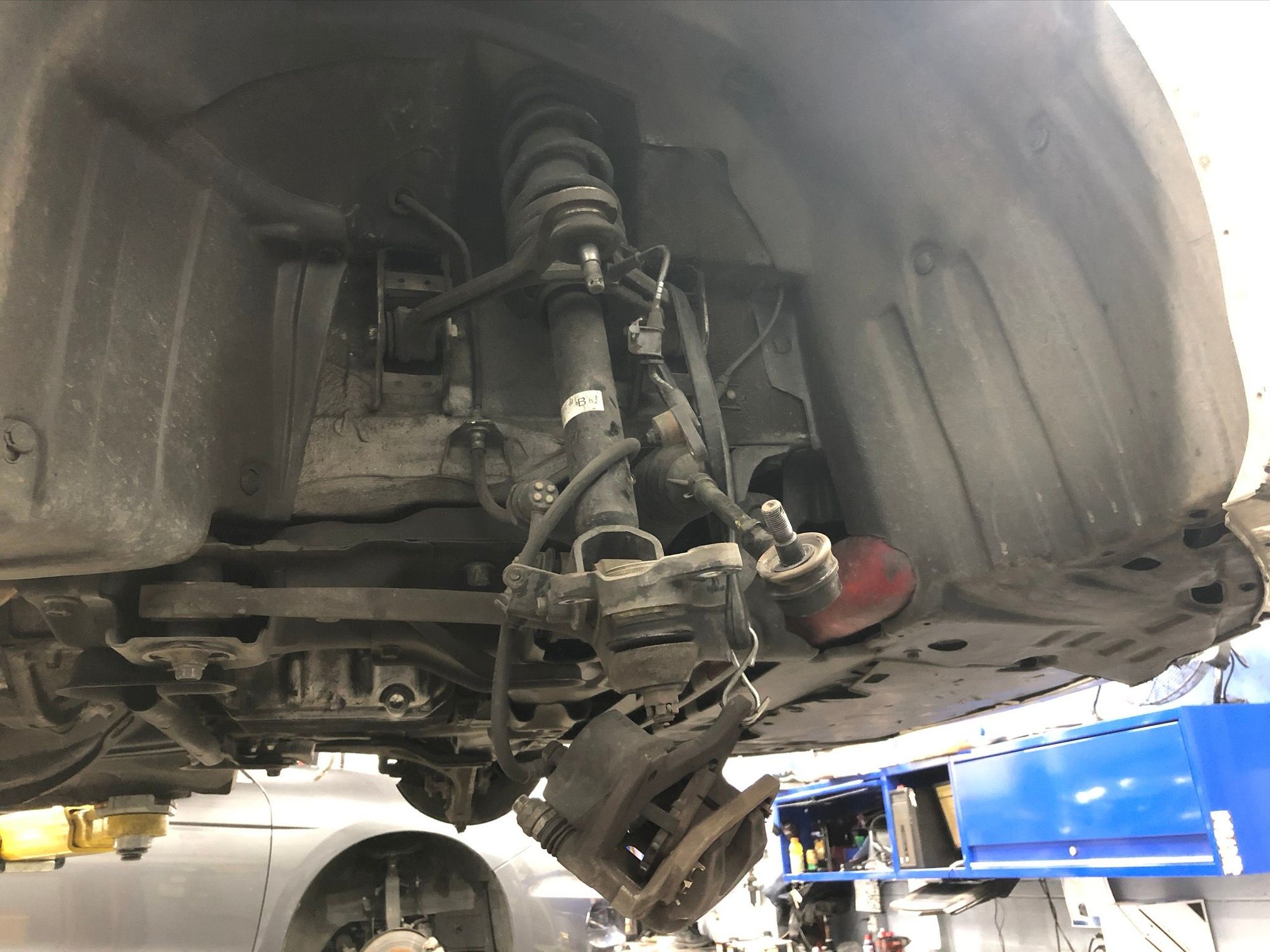

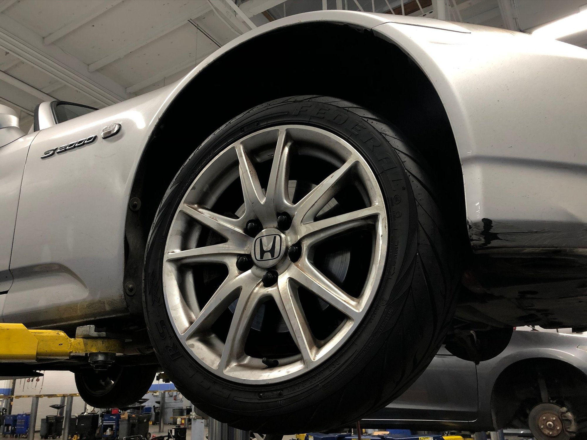

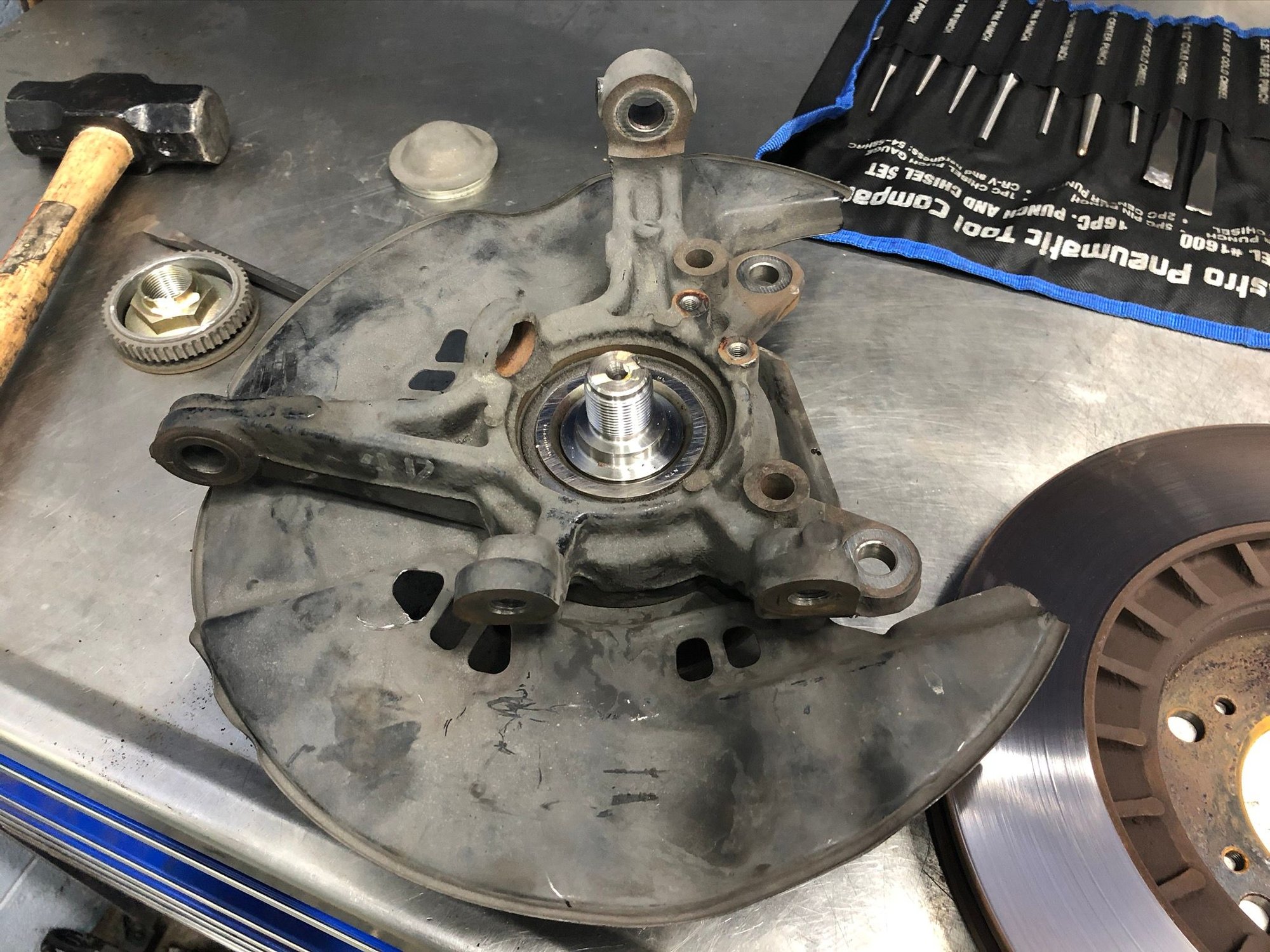

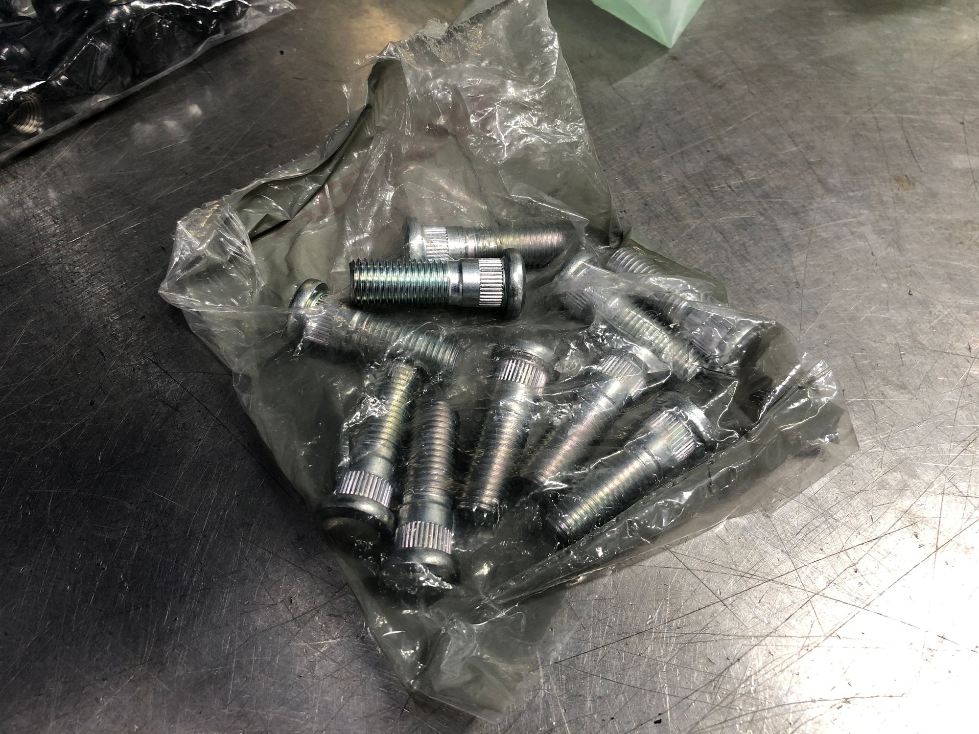

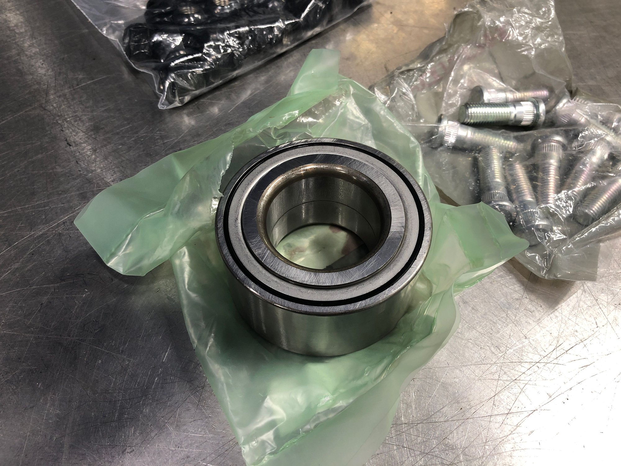

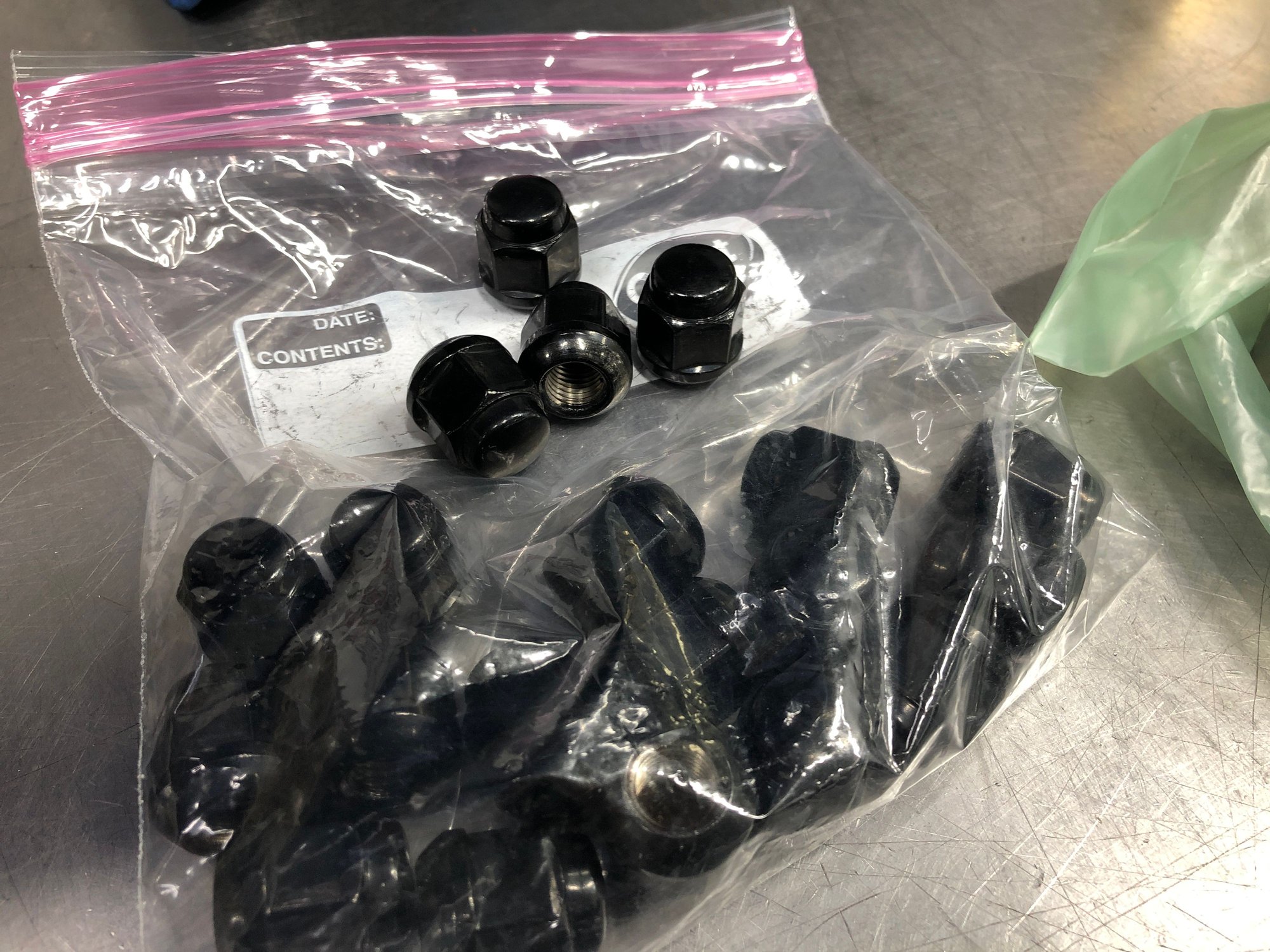

1/16/2020
Today's update includes replacing the front wheel studs and front wheel bearings. The reason for the replacement(s) is because one of the lug nuts on the passenger front wheel was cross threaded which resulted in the accompanying wheel stud shearing off upon removal. I took this opportunity to replace all of the wheel studs along with the wheel bearing since it would be a good time. I replaced both front wheel bearings along with the wheel studs on each side just to have both sides matching and fresh. Given my intended usage with this car, I figured it would be good preventative maintenance.
Right after we removed the hub assembly from the car...
Getting ready to remove the wheel bearing from the hub...
I also went ahead and swapped over to black lug nuts; I think they look better than the chrome lug nuts. What do you guys think?
Passenger side all done and black lug nuts installed...
