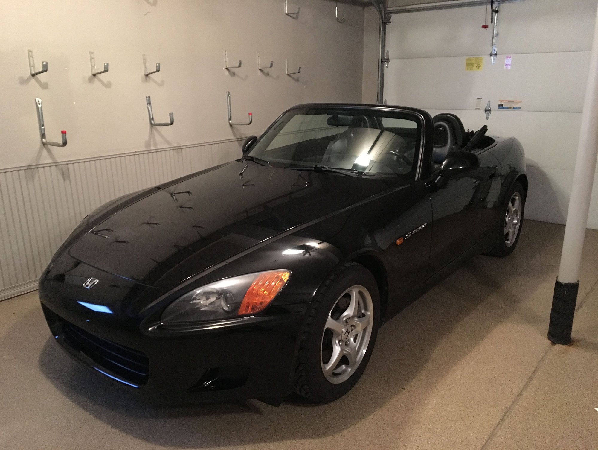

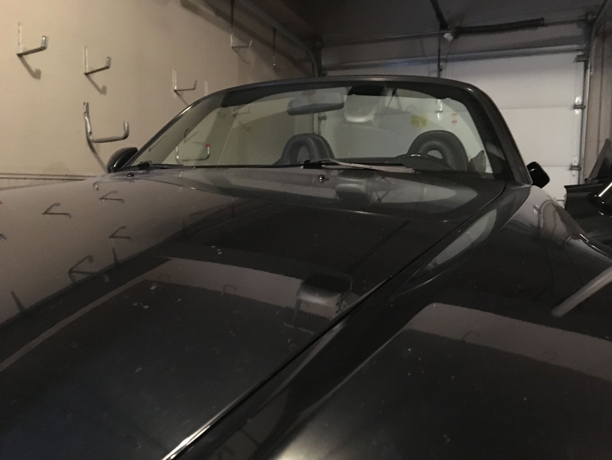

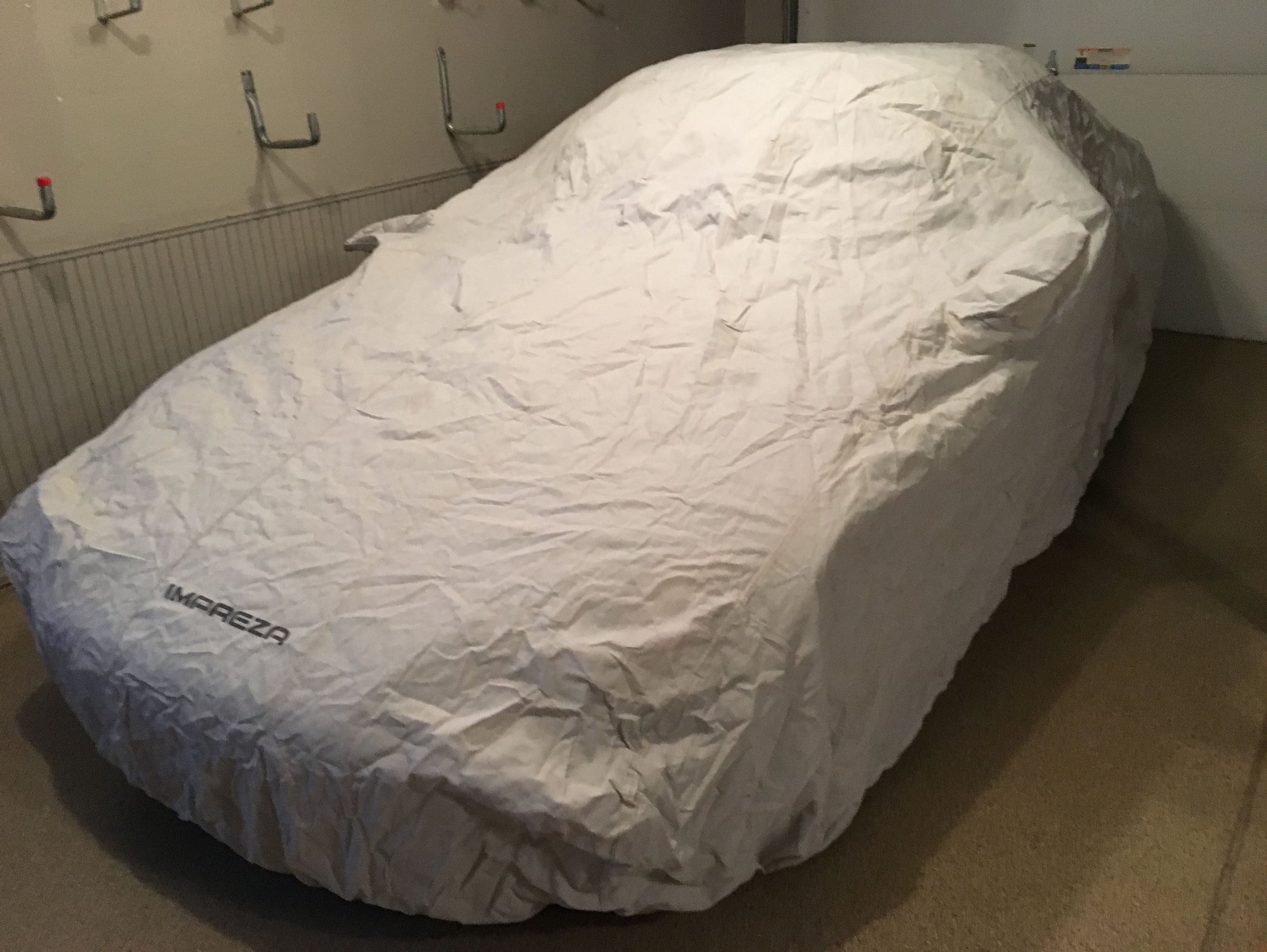

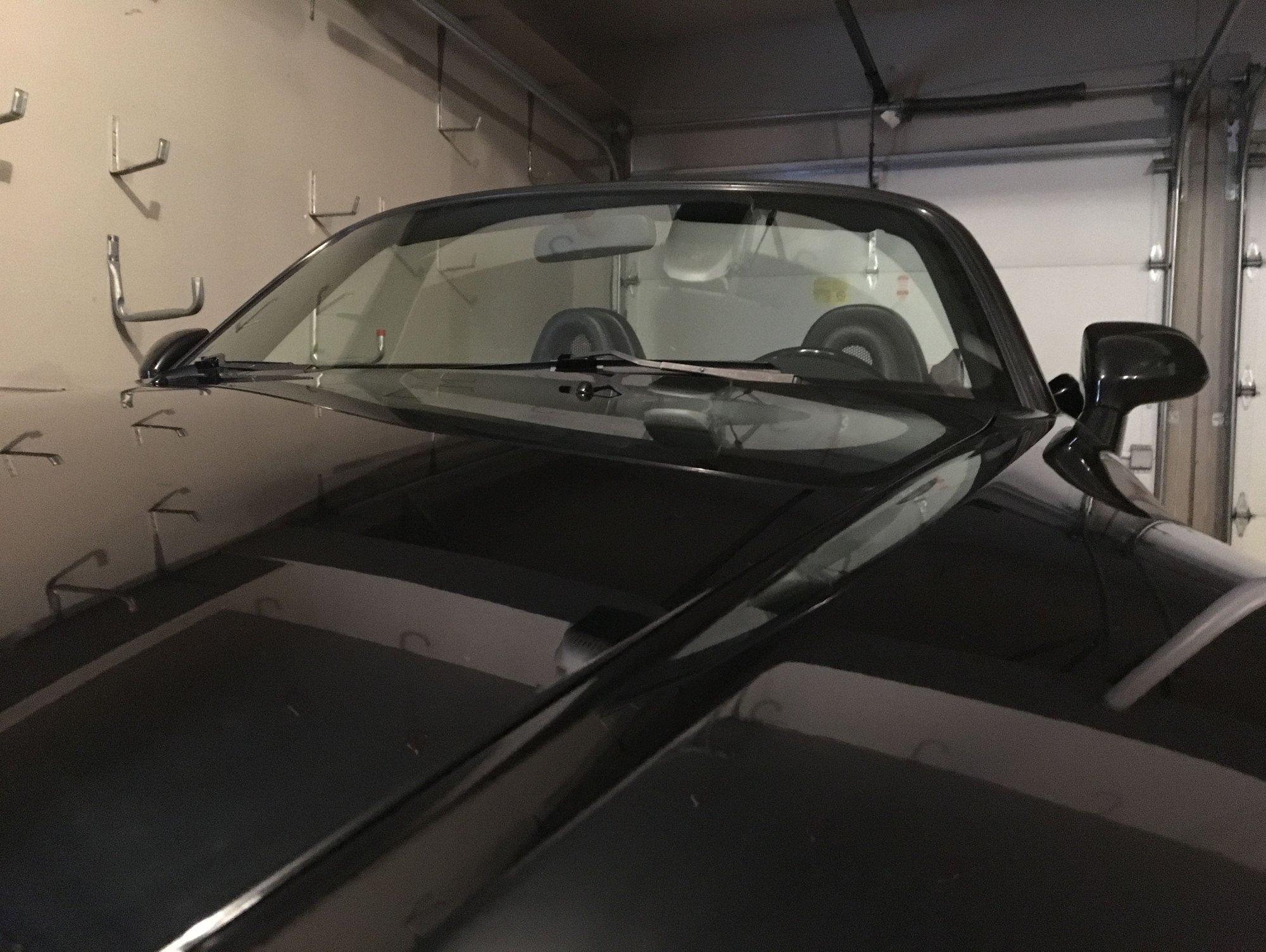

Put the car in storage last weekend... got it there just in time, we've gotten over 5" of snow here and there is salt everywhere now.
Wiped down the exterior with Chemical guys Ecosmart RU Waterless Wash, interior panels with Aerospace 303, and seats with CG leather cleaner and leather conditioner.
I was planning to do the soft top too, but the 303 says it needs to be clean and dry in order to use. So I guess I'll need to wait until spring for that. There are a ton of leave and gunk in the crevices on the sides of the top when it's down. So I'll need to address that.

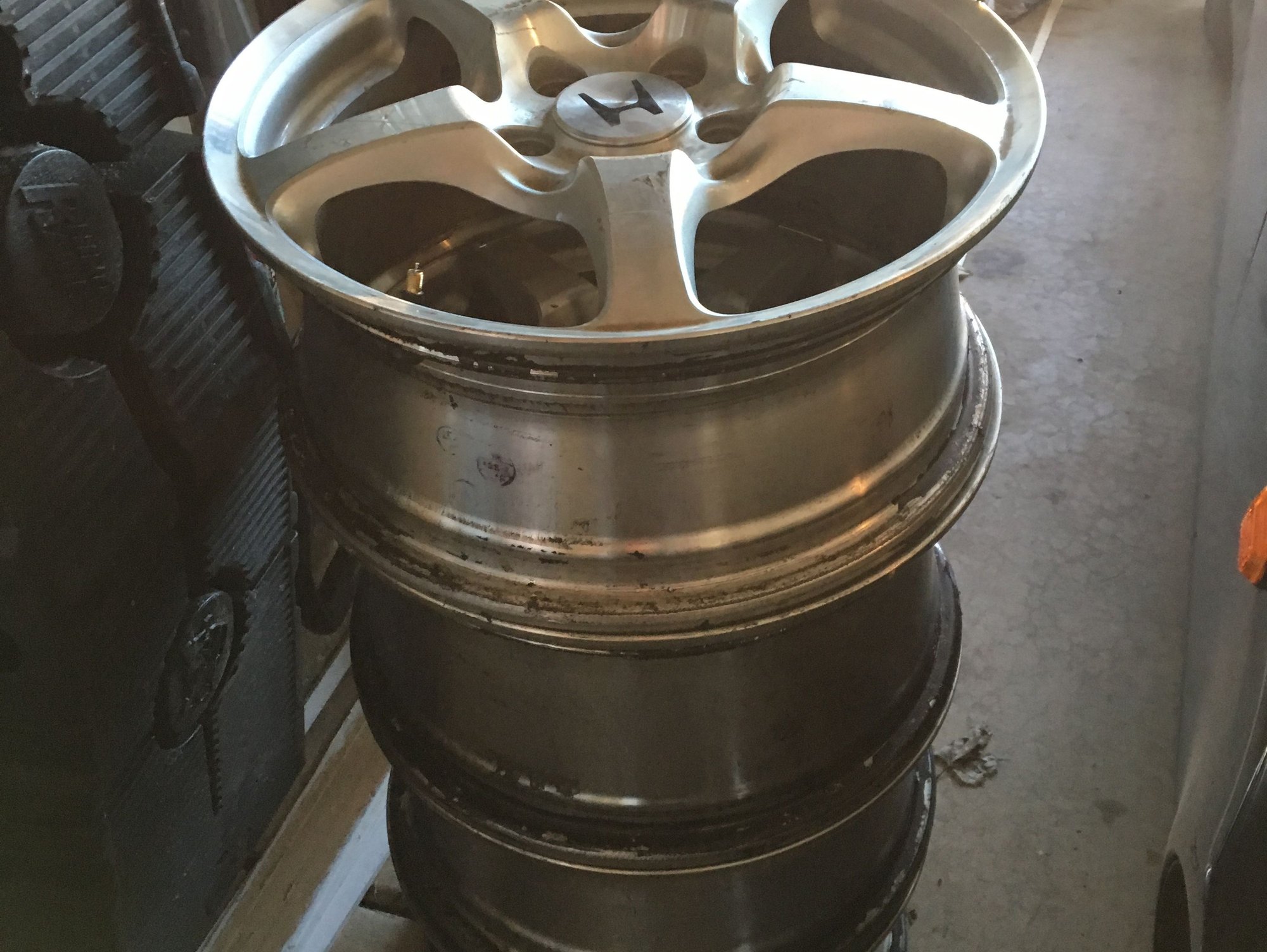

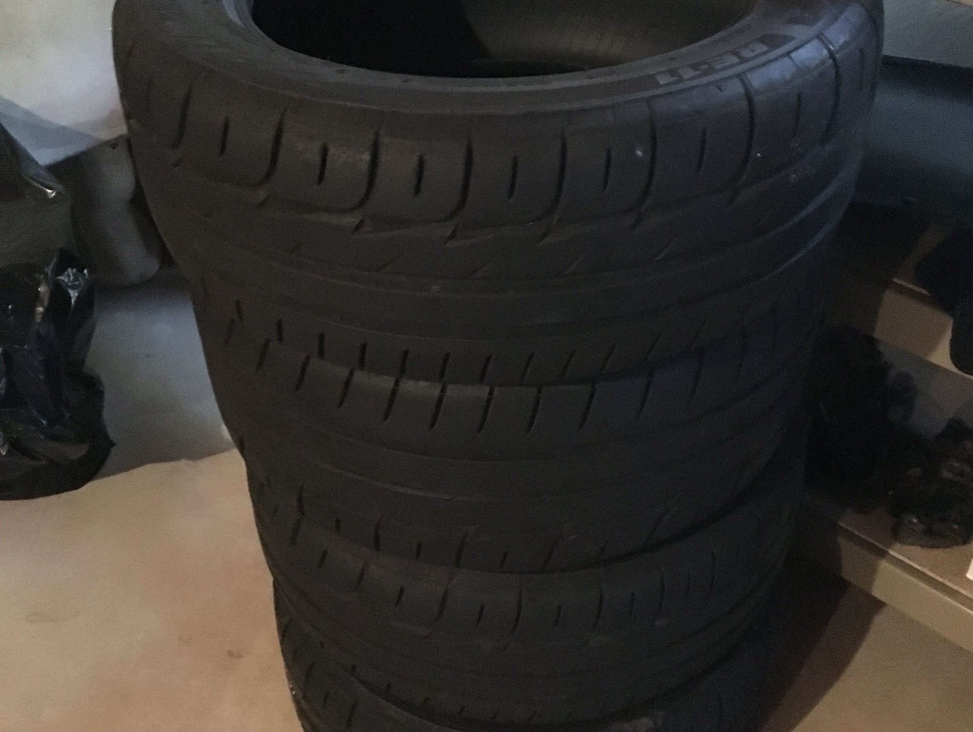

Picked up some other goodies for the car. Porter Cable 7424XP polisher, second set of OEM wheels, used RE01R tires, among other things.
