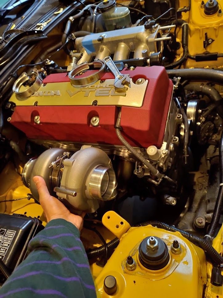

I wouldn't call the flow rates close on the overall flow... You're talking about 50hp difference. I do believe the exhaust wheel is bigger, but the flow of the compressor is ultimately going to make the power and your A/R is a decent size. If you have a flat 8 PSI, you'll looking at near 400whp on E85.

If you're still stuck on how to run the coolant lines to the turbo, you can run it from the radiator and then back into the block through the freeze plug on the side. I'm not sure if your running a aftermarket rad tho. I can post some pics of how I did mine.

Thanks man. I think I got it figured out. I was really just debating between using the coolant TB line vs the oem oil cooler lines. I'm decided on the oem oil cooler lines, and just have the oem fitting/water pipe w/ a -6an fitting welded on. This gets rid of a rubber->braided/hardline transition piece. I measured the port coming out of the head and it's pretty small at 1/4" or less (roughly -4 an). While I think it would be *ok* (apparently the water lines are really only needed for hot shutdown), I'd prefer it having a little more cooling (the fittings are -6an, roughly 3/8").

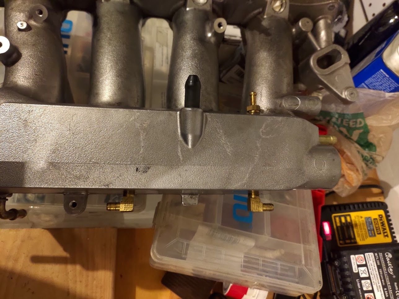

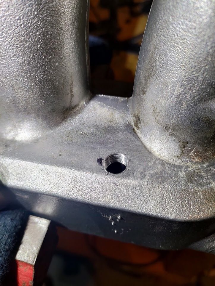

Pulled the intake manifold and drilled and tapped it with 3 1/8" npt ports. Vacuum blocks work fine, but it wasn't much more work to pull the intake manifold at this point so why not drill and tap the manifold. This gives plenty of ports for things to have their own dedicated vacuum line. I also got the Radium rail and fpr installed with the ID1050x's. The radium parts are nice. They have some fancy swivel fittings which are very nice. I still need to crimp the new pins for the ID injector harnesses.

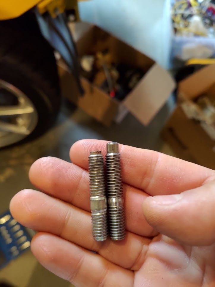

Installed the ARP studs. These are the 1.75" length ones. They're actually only a tiny bit longer than oem. I have nordlock washers as well I will use. Thx for the tip Jason.

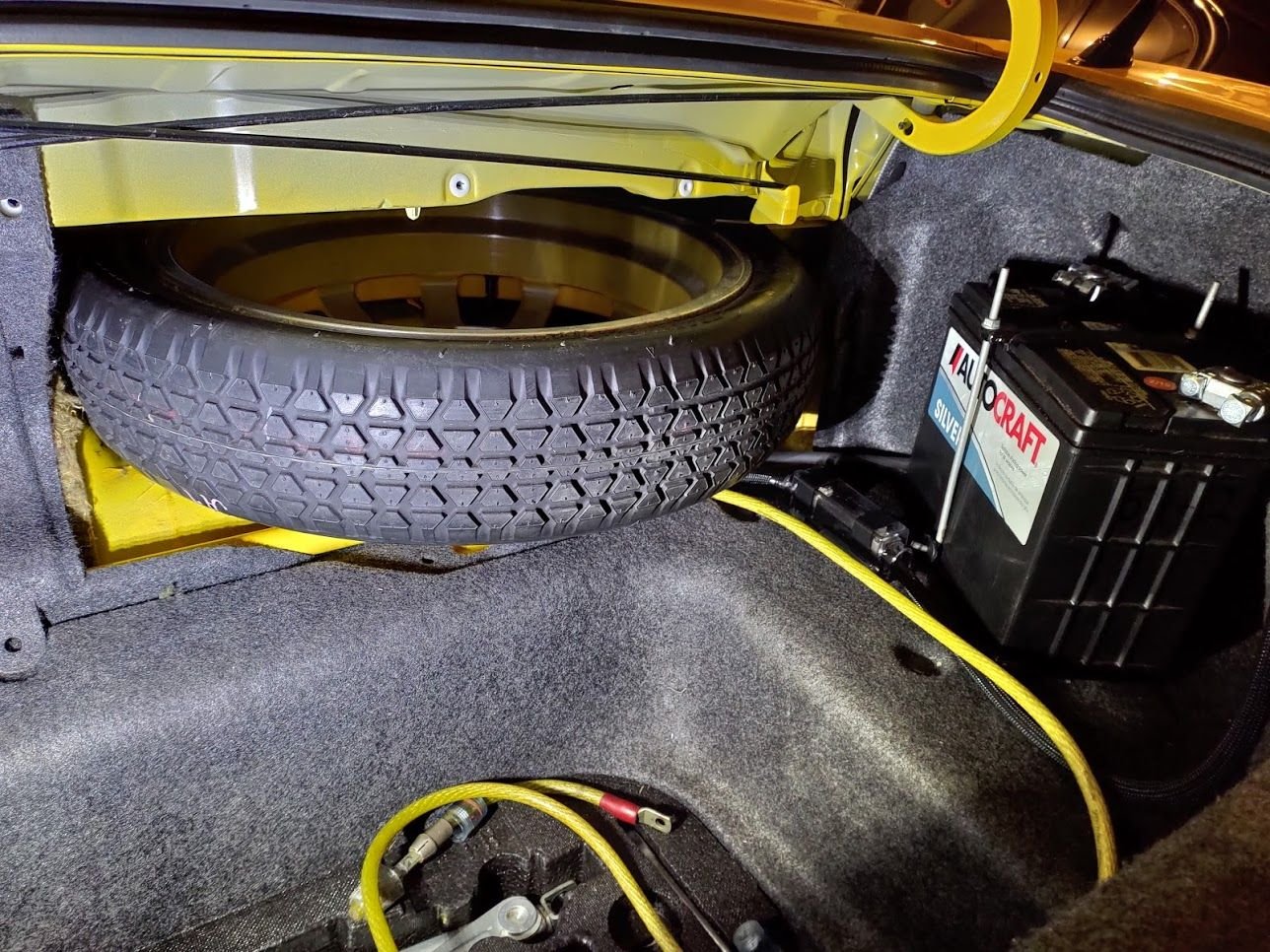

One thing I was finally able to get done is the battery relocation. I'm pretty happy with how it turned out and everything fit nicely. I used a 2 gauge welding cable for the relocation and a nylon braided sleeve to provide a little extra protection for the cable.
Got the wiring all finished in the trunk and everything fits nicely. It was designed with the spare in mind. I can still easily remove it (this is a DC5 type-r spare so it'll clear the bbk). I have a cpl more little things to do, like probably cut the threaded rods down but it's just cosmetic type of stuff. I have a 4 gauge wire that runs to a dist block behind the seats that powers the 2 channel amp and the heated seats.
In the engine compartment I just used a dist block to make the connections. With the battery in the trunk I wanted a charging post so I can easily hookup the battery tender when the car sits and I find it handy to charge my phone at the track in the engine bay.

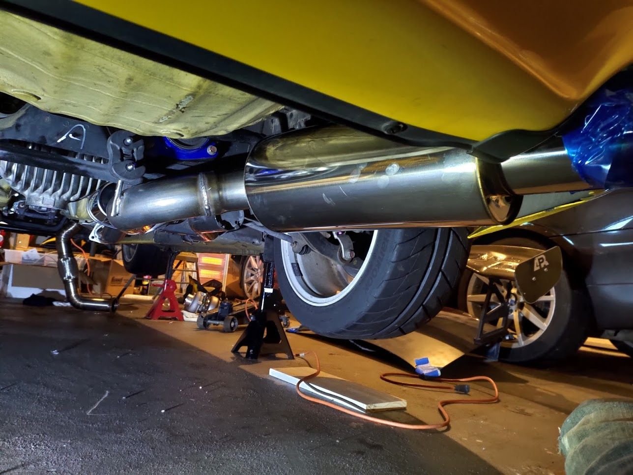

Got the HKS Hi power single exhaust. Was super easy, took 30mins to install including the unboxing.

I have a long list of things still to do. One area of concern for me is the turbo coolant lines. The plan is to run them on top of the compressor housing but I noticed this makes them I think the high point in the cooling system. Could this pose a problem of air getting trapped in the system here? A friend suggested using a funnel to raise the point up but I'd love a 2nd opinion. Worst case I can figure out a different solution for the coolant lines but really liked this approach. Please chime in if you have some thoughts.
