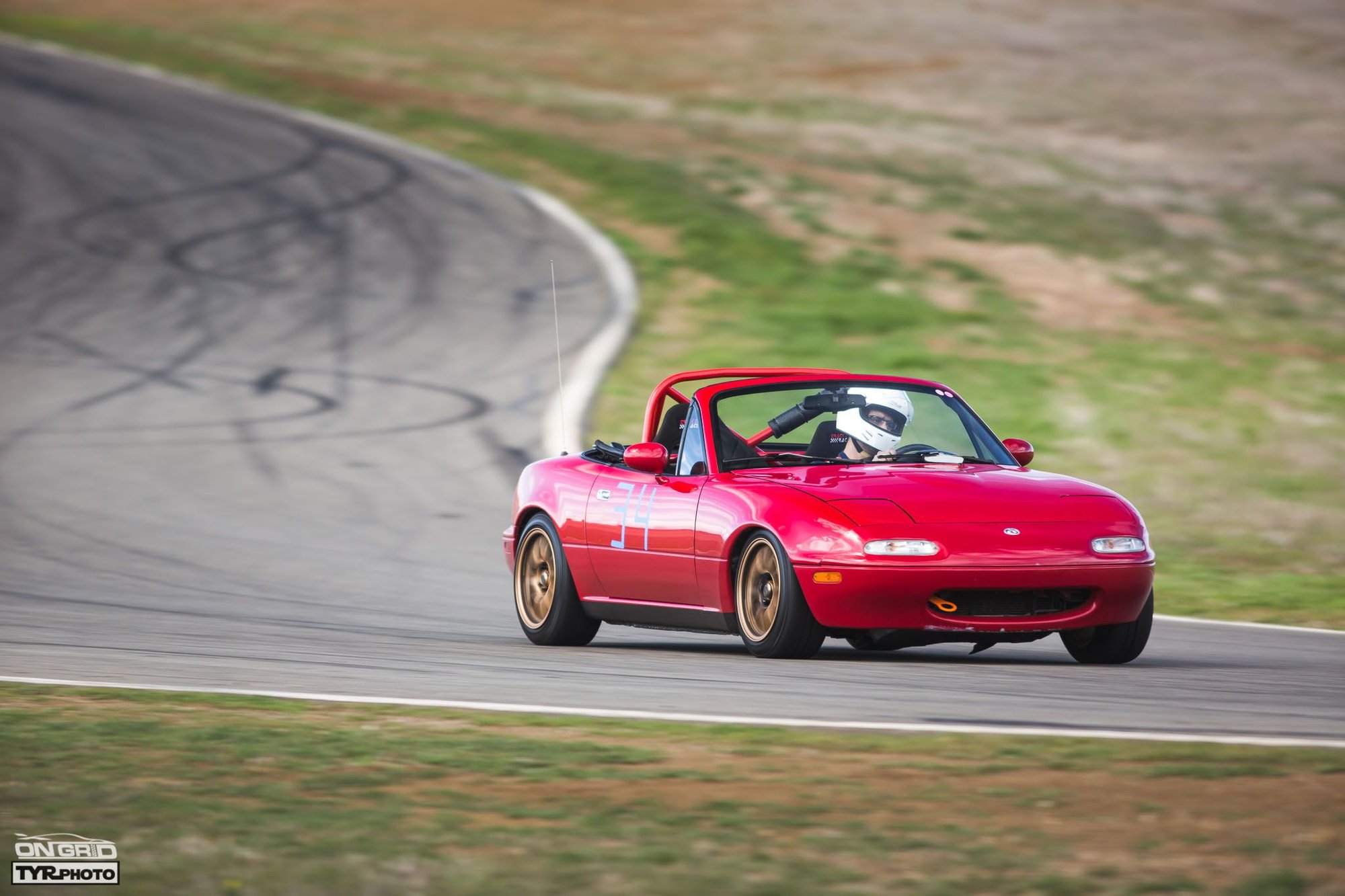

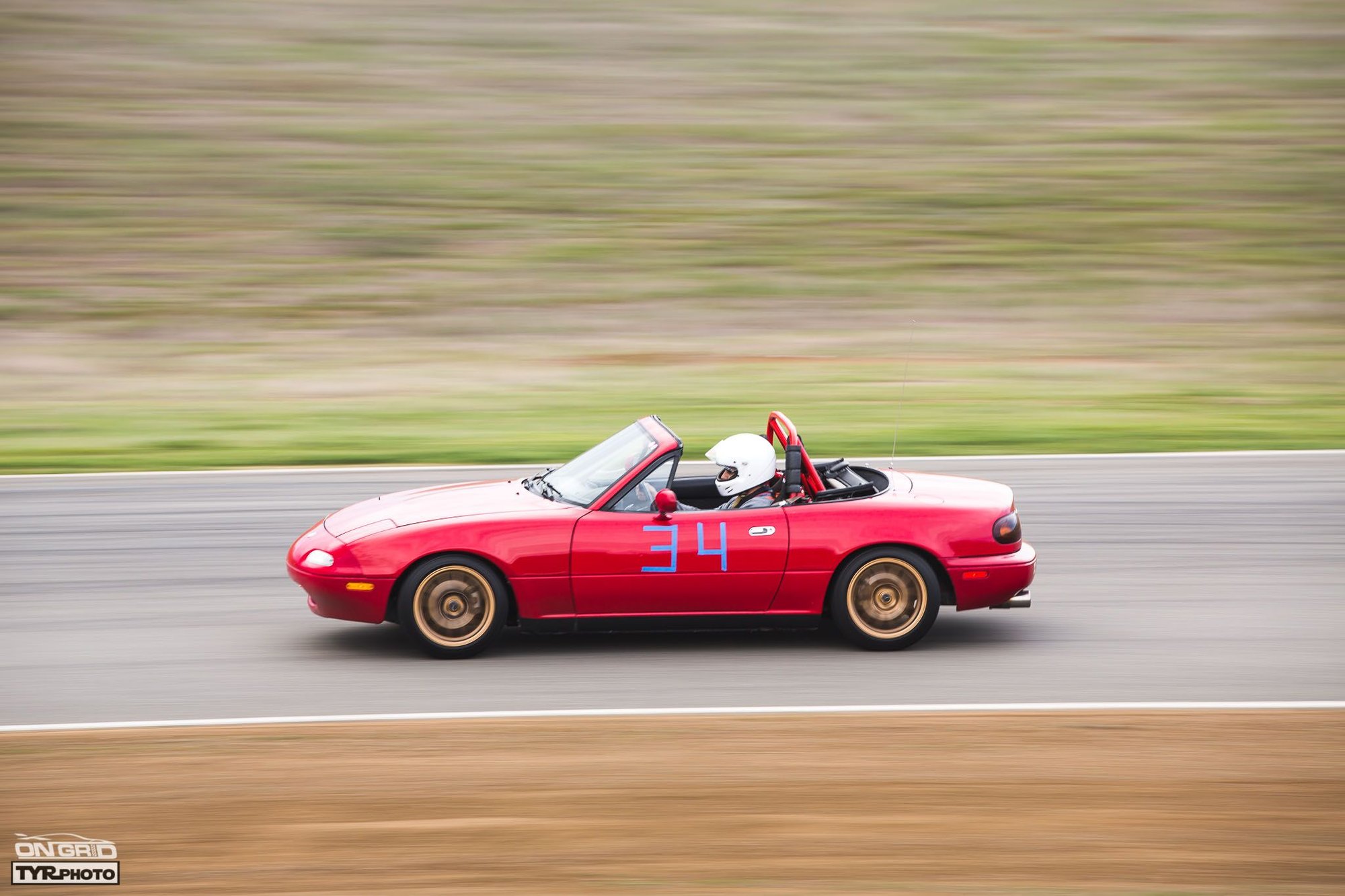

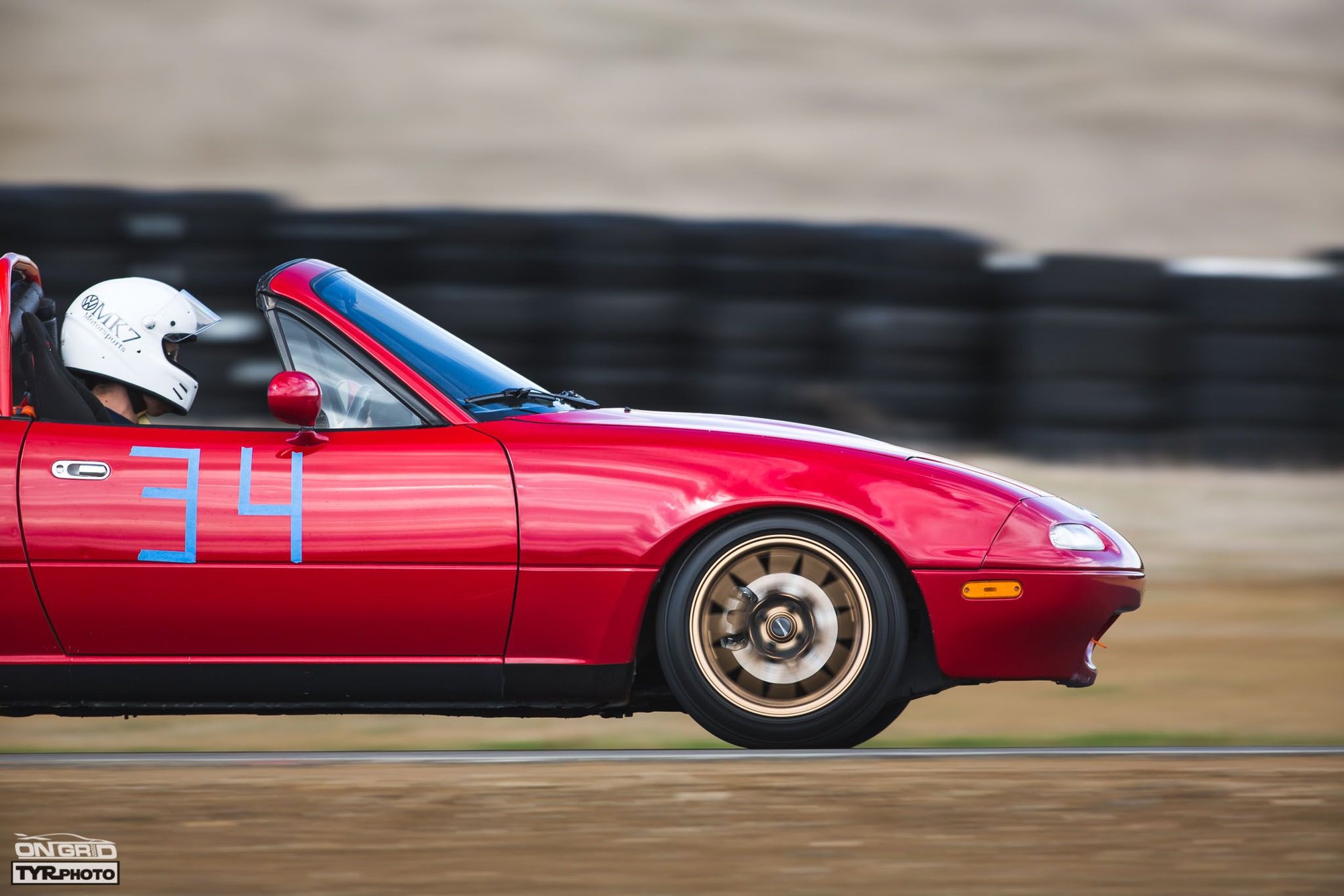

I guess I never posted these, got my first track day in the books (Thunderhill West). Nothing went wrong, had a good time, hung out with friends, would do again. In fact, doing again on Thursday for SCCAs Track Night In America. Hoping this time I will feel confident enough in the car to stop lifting/braking in places where my light, slow, grippy Miata doesn't need to. Hard to get used to not having a lot of power. Pretty much need to relearn the tracks.

Awesome long lens photos! Love the compressed shot of that S-curve.
