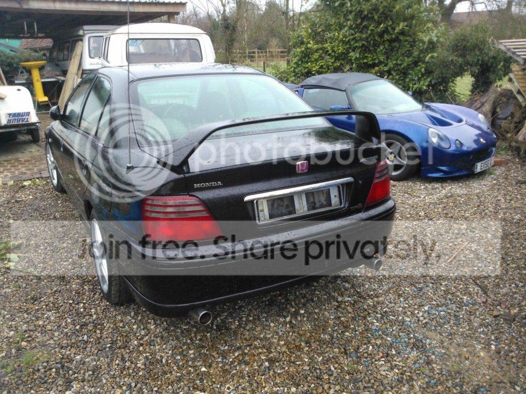

Just picked up a Accord type r to turn in to a track day car, Has any one else had one and know any good tuning advice. will probably start by striping all the interior and fitting some elise seats.
Any advice is appreciated
