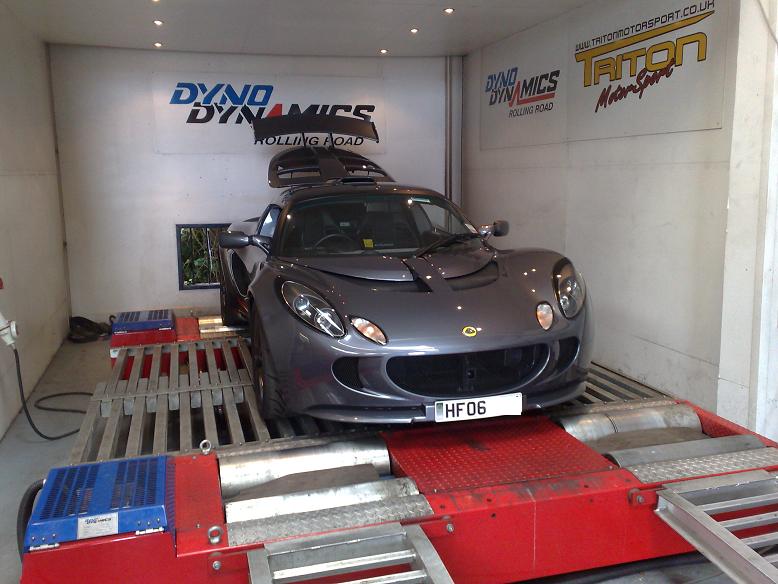

Also just had it dyno'd and the AFR looks fine which means I fitted the injectors properly and the ECU is working well.
It came out as 206 ATW or 245 AFT which is a bit lower than expected, but the ECU is still learning and these cars HATE being on a dyno. Each run was dropping about 3 bhp due to heat. If there was a feed to the intakes and the top feed to the aftercooler I would think 260 was realisitc
We moved the ramps and got the fan right upto the nose, but it's not enough really.
