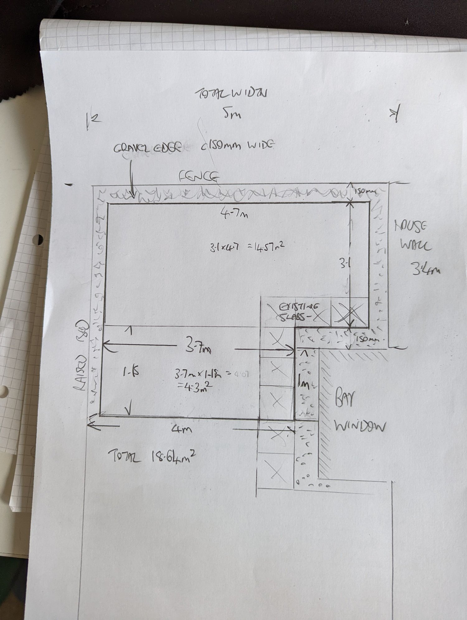

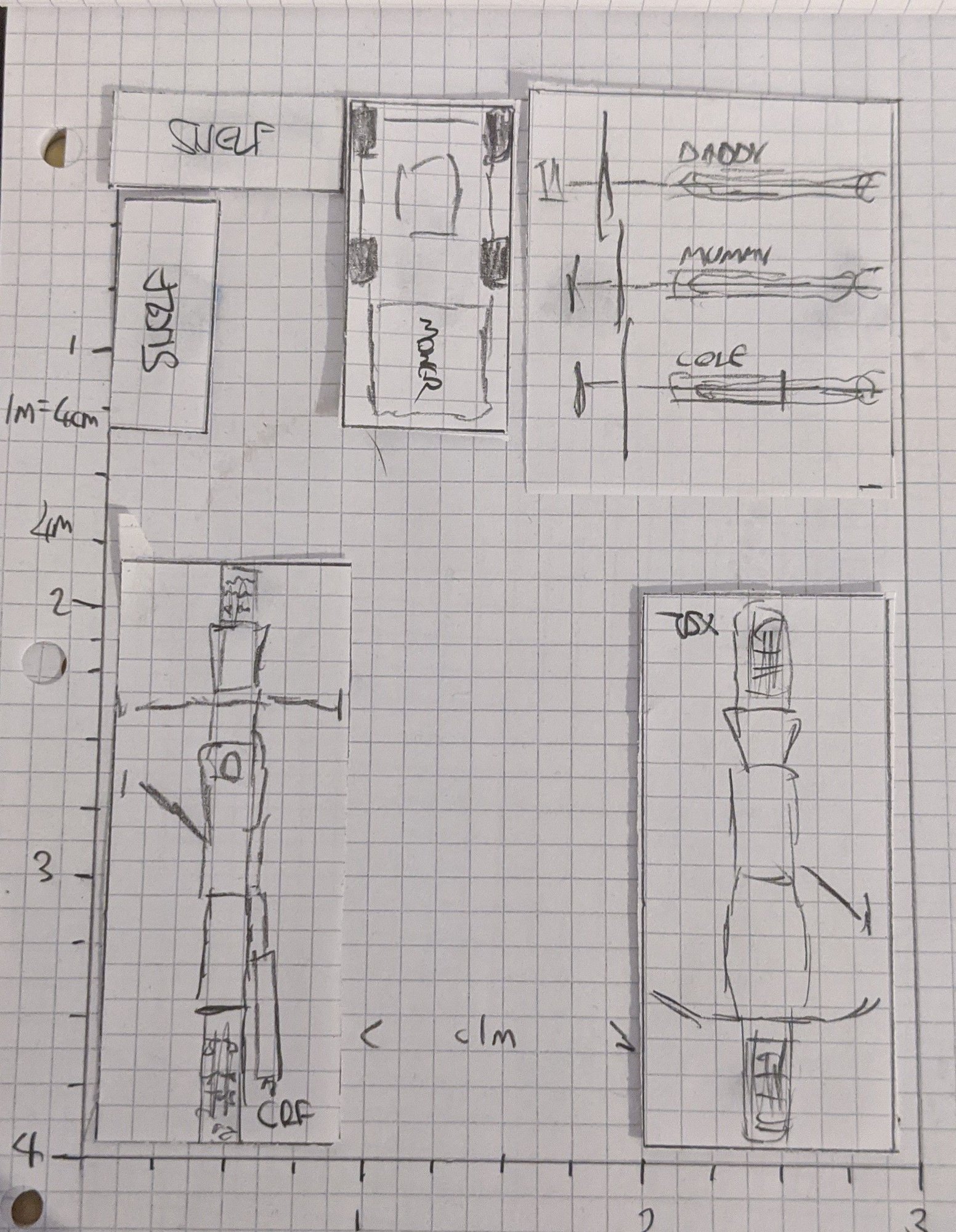

Doors at the end are because it's fitting in a relatively narrow bit of my teeny tiny garden
here is a plan, I need double doors on the end so I can wheelie heroically in after a hard day catching baddies (in the office)
It could be longer to accommodate a single door at the non motorbike end
excuse my scribbles

If you fancy going more modern than the graph paper, I've found floorplanner.com really useful for doing room layouts.

Bit of a first sketch
it will fit here (our garden is tiny)
Putting slabs in as a base then nicer slabs for a patio
