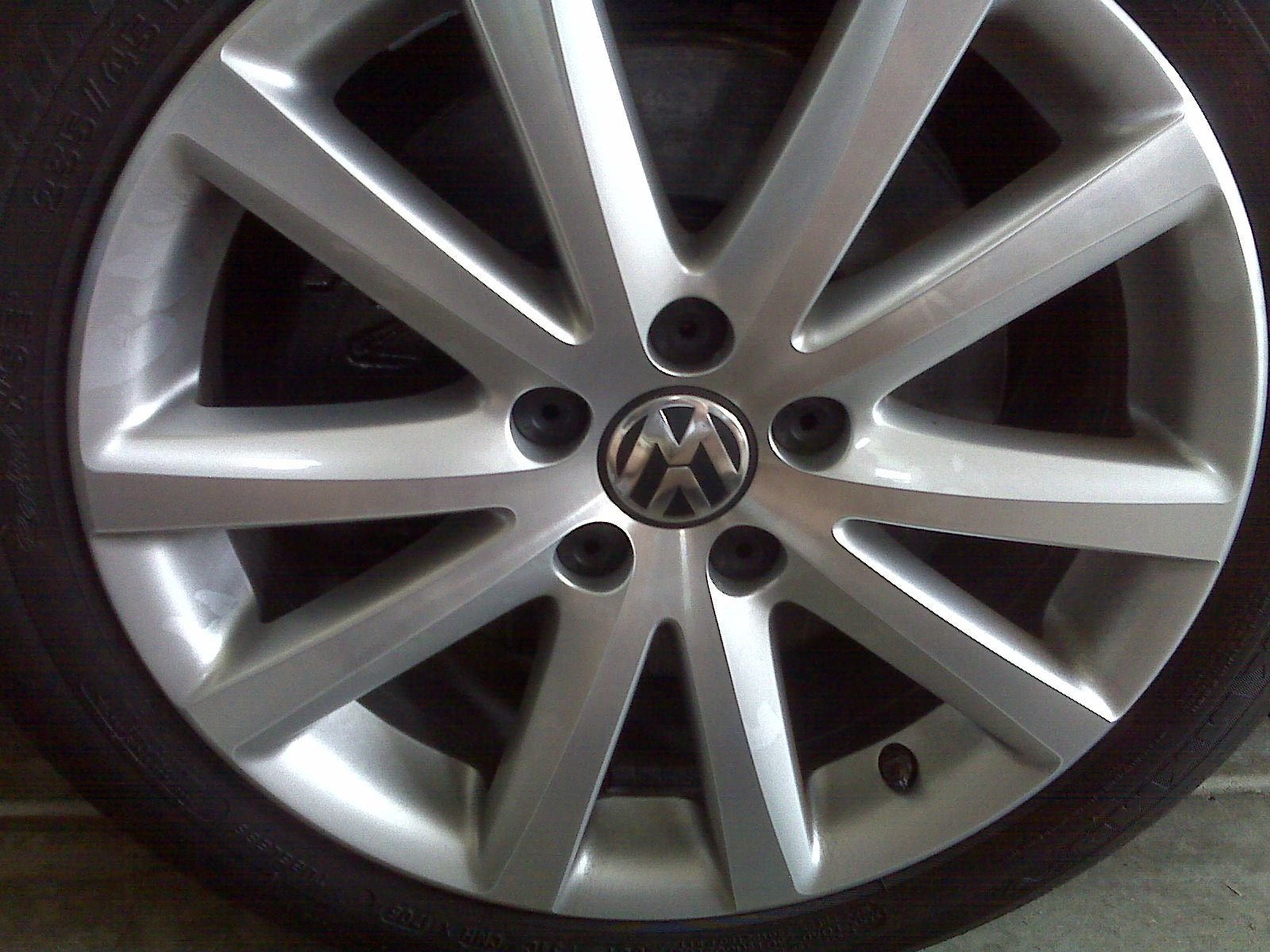

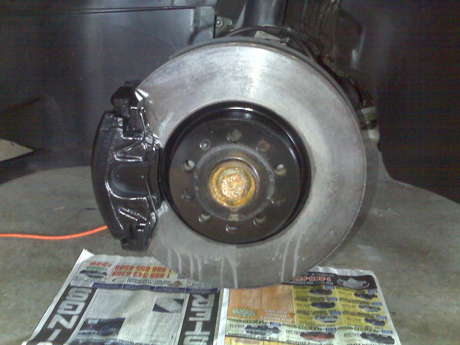

My vote too. Black calipers FTMFW!!! That's what I have on my S2000 and on Anna's Accord Coupe.
Hell, I recently painted my calipers on the VW Passat...Gloss Black. It's super easy to do and maintain. I hated that nasty, dirty look of 'em. They look great now!
The process was pretty simple...I first used some Rust Remover spray...then wiped it clean...I then used Brake Cleaner for the caliper. I sprayed a light coat of hi-temp primer. Then 2 coats of Hi-temp Gloss Black.
If you want...we can set up a mini-Tech Day at my place to do it.

I'll also add that I painted the hub on the rotor as it was silver and had parts that looked rusty...I cleaned the rust and voila, primed and painted...

Looks good Did you just use the Duplicolor spray kind?
OOOOOOOO I'm in for a mini tech day!!!

No...IMHO...don't waste your time with DupliColor... I just use Hi-Temp paint...it's something like $5~6 a can for the color and about the same for the primer...no brush on stuff...

I know I'm opening a can here...I've seen people use the Duplicolor...and even the G2 kit...they work...and they look good...but IMHO, what I use is "just as good." If you know me, you know I don't like to cut corners or do things "on the cheap..." but this method works really well and lasts a long time with minimum upkeep.
Someone on here recently used the expensive G2 kit and well...I saw they had chips on their calipers... I just think if you use a kit like that, it should hold up really, really well... I touch mine up every year or so and it's super easy...a quick spray and voila, done.

Well any method will chip if its not prepped properly. The can of duplicolor paint was only $5. The g2 kit on the other hand is $36 on ebay.
But either way I might just go with black.
