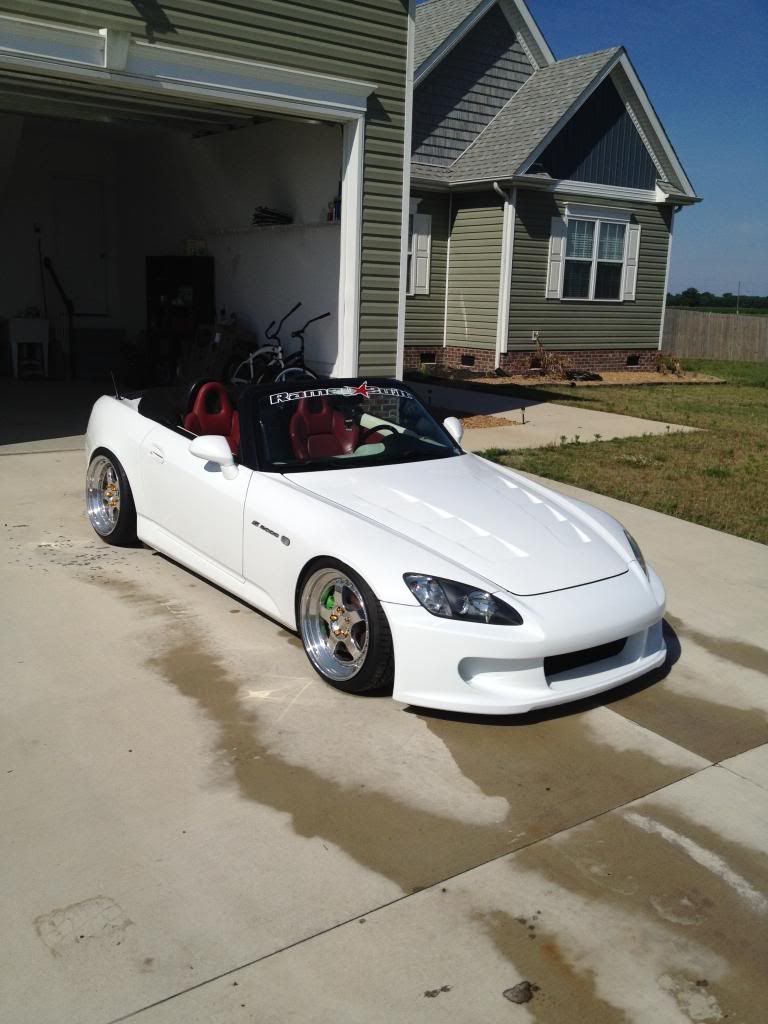

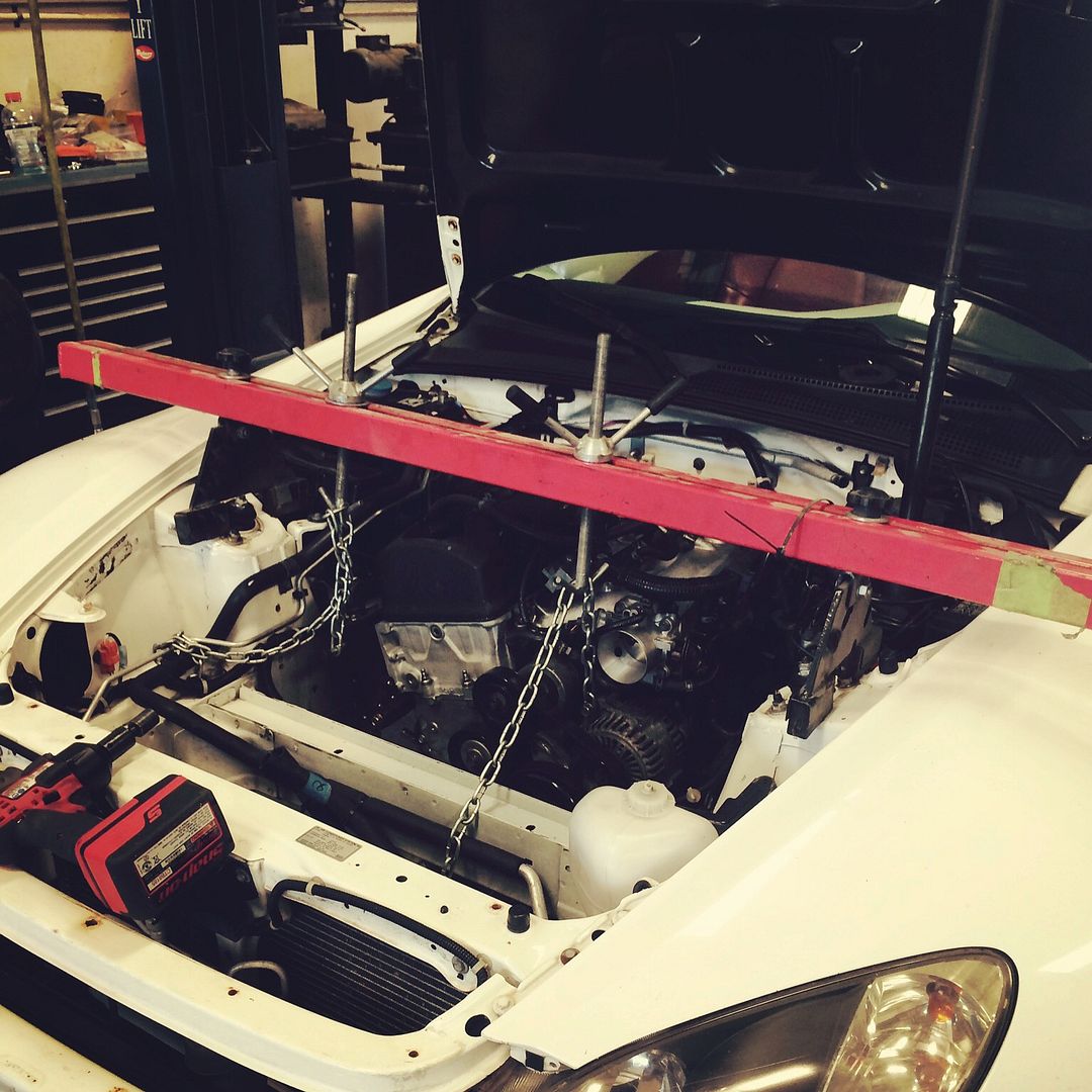

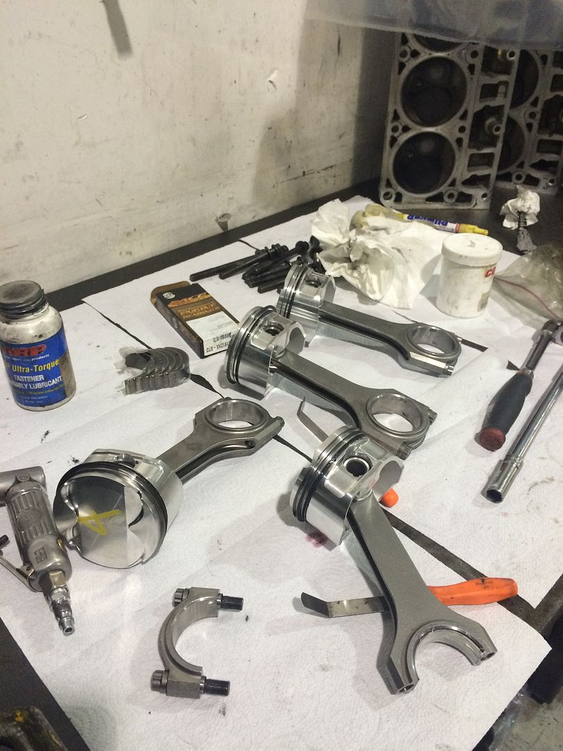

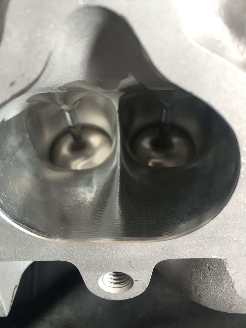

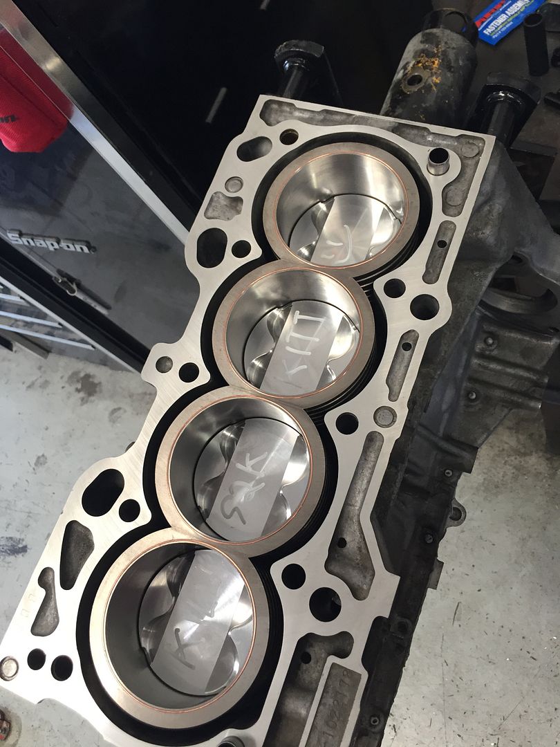

So Ole Girl has been on the Disabled List for about 2yrs now.
An now after what seems like a decade and "$100,000 under the hood" thanks to my boy Shawn Ramey ( RameyBuilt ) superior Engine Building Skills. The S2000's new motor was fired up for the first time yesterday. Should have her back on the road in the next couple of weeks. I can't wait.
IG: @S2Kitt
***New Motor***

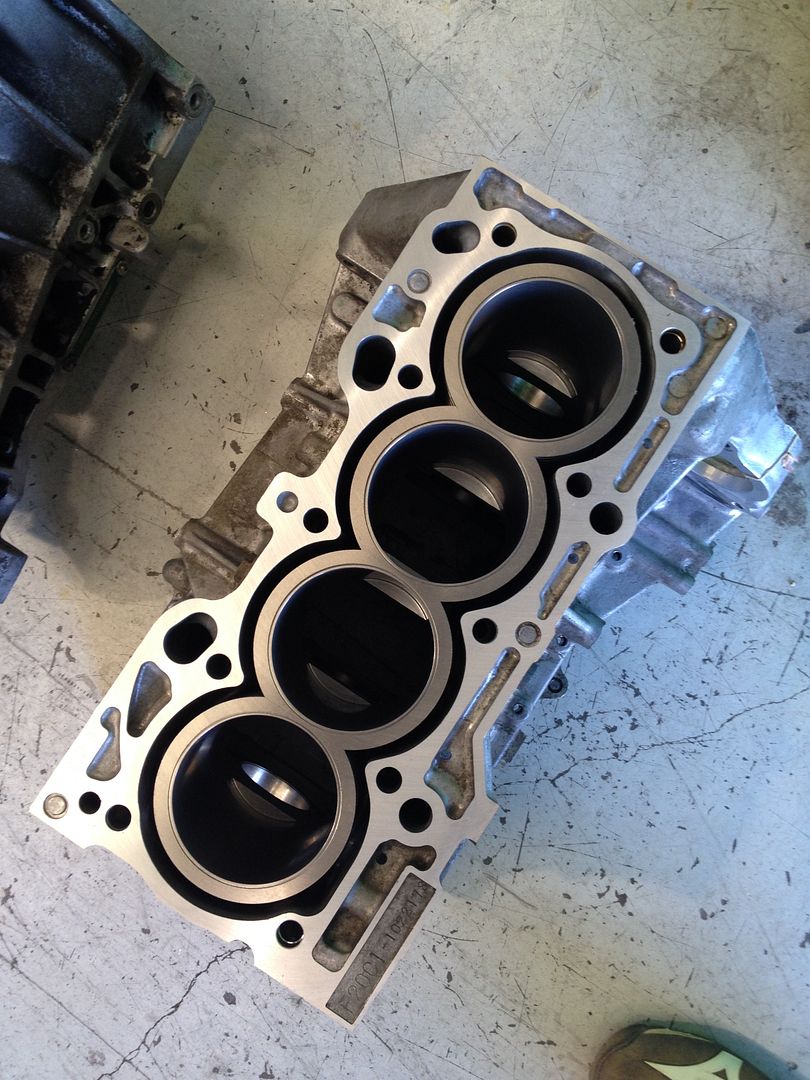

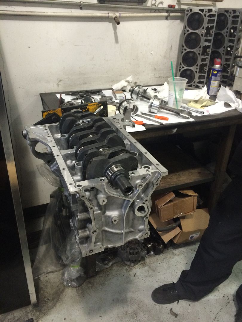

L.A. Sleeves
CP Pistons 10:1 88mm
InlinePro Rods
ACL Race Bearings
Micropolished Crank
ARP Head Studs

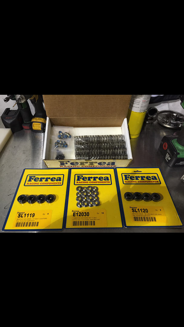

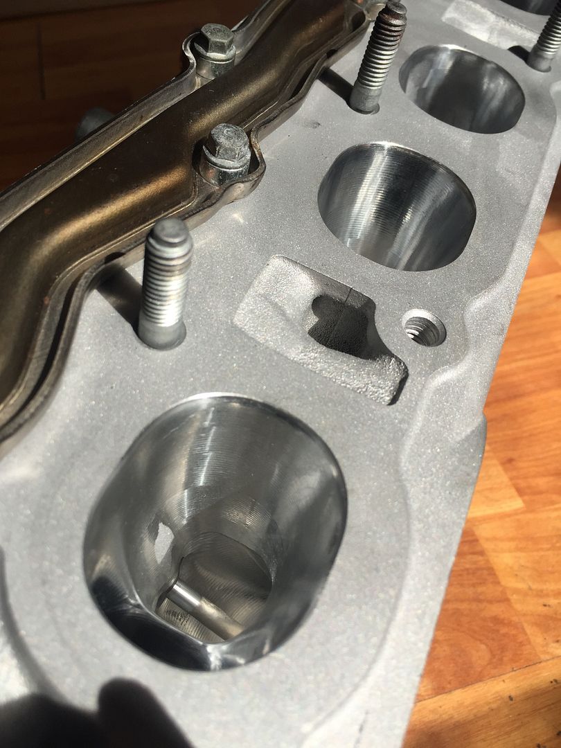

4Piston Pro S2K CNC Head
Ferrea Bee Hive Valve Springs
Ferrea Titanium Retainers
Ferrea Valves
Supertech Valve Guides and Seals
InlinePro TCT
Port-matched Intake Manifold
SOS 70mm Throttlebody
ID 1000cc Injectors
Science of Speed Stage 2 Kit w/ Paxton Novi 1200 blower
Science of Speed Upgraded Heat Exchanger
Science of Speed 3.2" 16psi Pulley
Science of Speed 3 Bar Map Sensor
Tial Q 50mm BOV
Private Label Header
Powerhouse Amuse R1000 70mm exhaust
