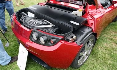

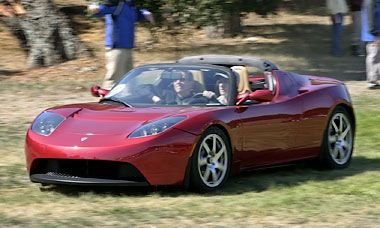

The upcoming TESLA...an electric sports car !!
Some Pics
