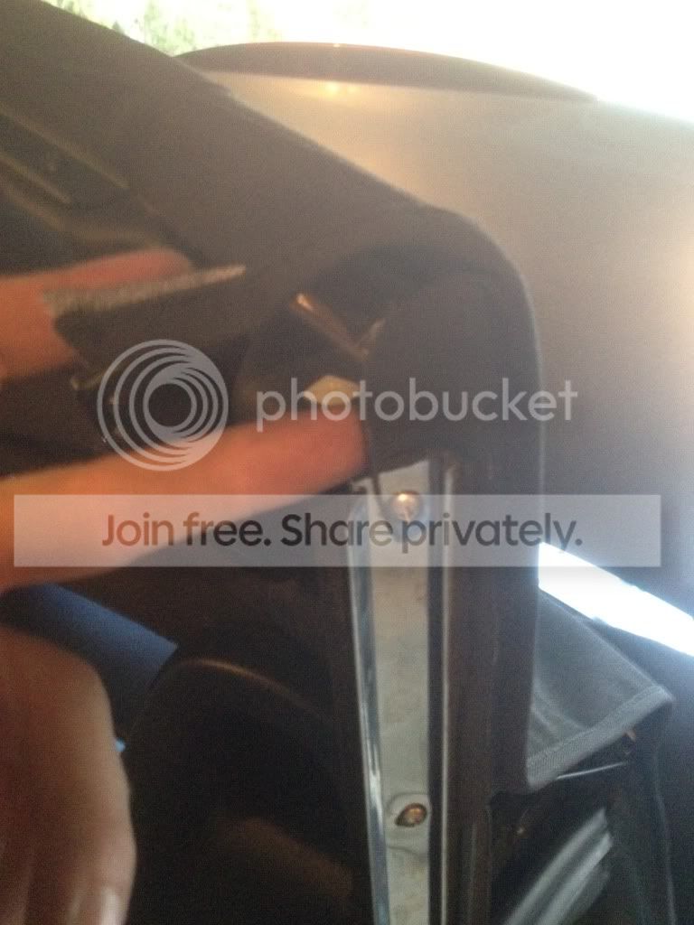

So after spending way too much in a way too short period, I said F-it I'm going to try and install my soft top. I don't need it to be perfect, I'm top down 95% of the time. I'm at the end of installing the actual top and can't figure out what to do with the edges... Its an EZon Top need input. Check pics in link above.

you have to take off the weather stripping, there is a screw in the front of the top, then there will be a metal plate that holds down the top. i have some pics of mine.

ok so fabric goes under the metal brackets!

yea orginally i think its glued under there. i didn't glue mine @ all i just pulled it tight and put the screws in

The metal bracket helped me secure the front of the top, but how did you get the corners to stay? There is no metal bracket for the corners just the top of the molding and I do not have enough material to screw in. I'll snap some shots of what I have

This part
may try to glue it, but will it hold? I bought 3M molding adhesive

they are just glued down, if you look at my second picture you can see how i have the end of the ribbing pulled across to the left. infront of the hindge latch

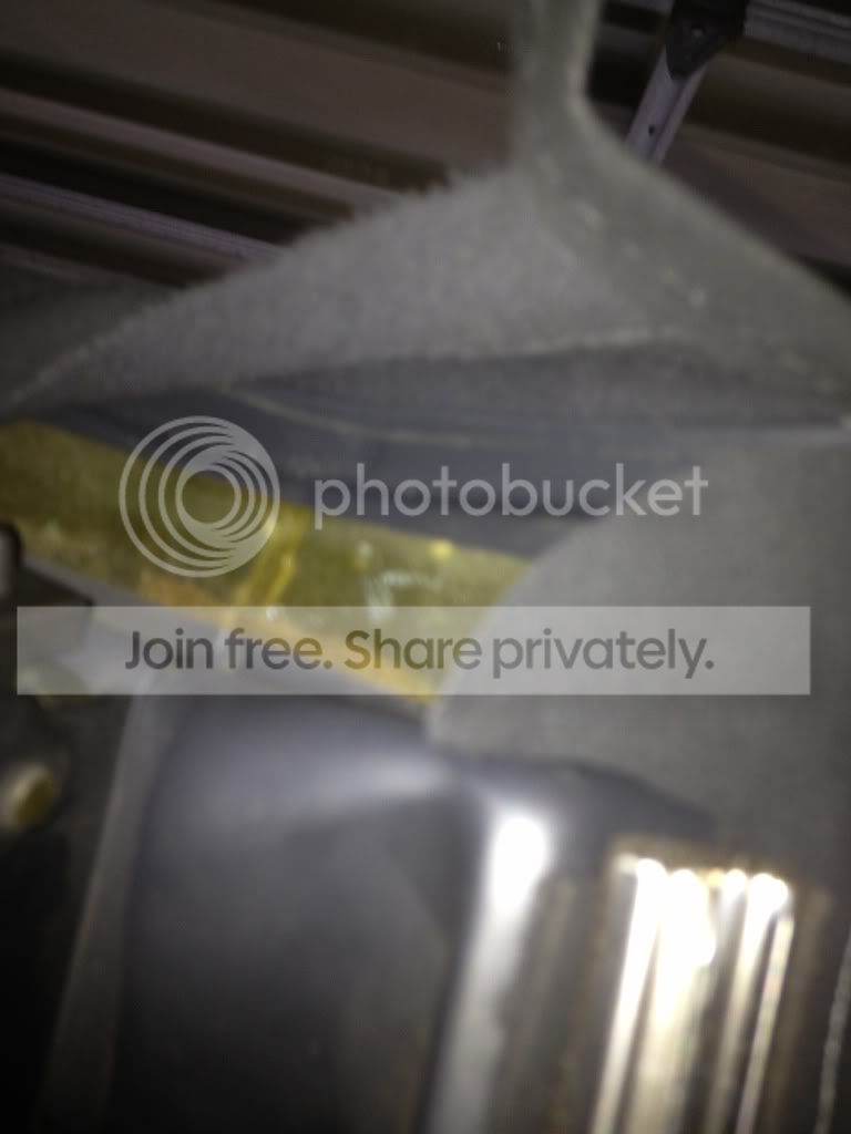

How in the hell do you get the rear tray (that covers the spare tire) and the panel that attaches to it. Do you install this before the roll bars and any other piece?
this area

it should go in first, but i did mine last i just snaked it through the trunk but i had my spare and carpets out already

Ya I can't get the bastard to stay in place with those white clips. I think I need the surrounding panels to help hold it up
