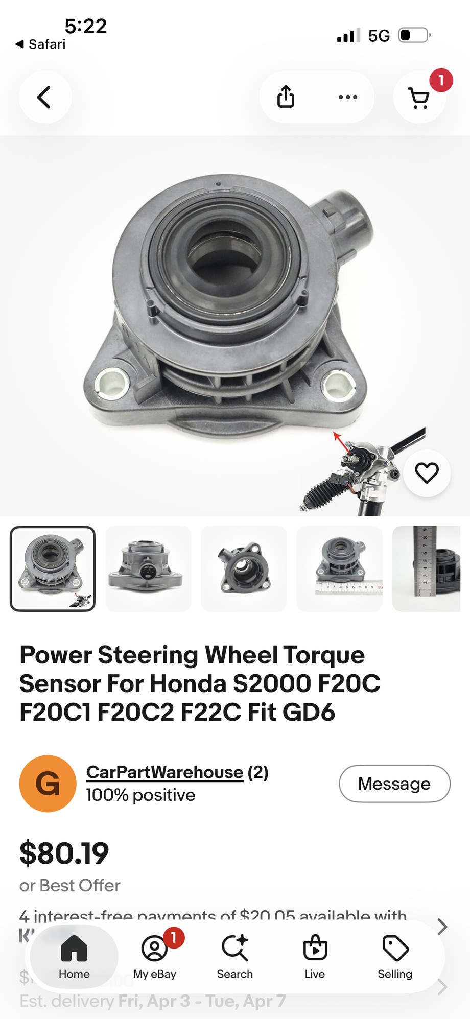

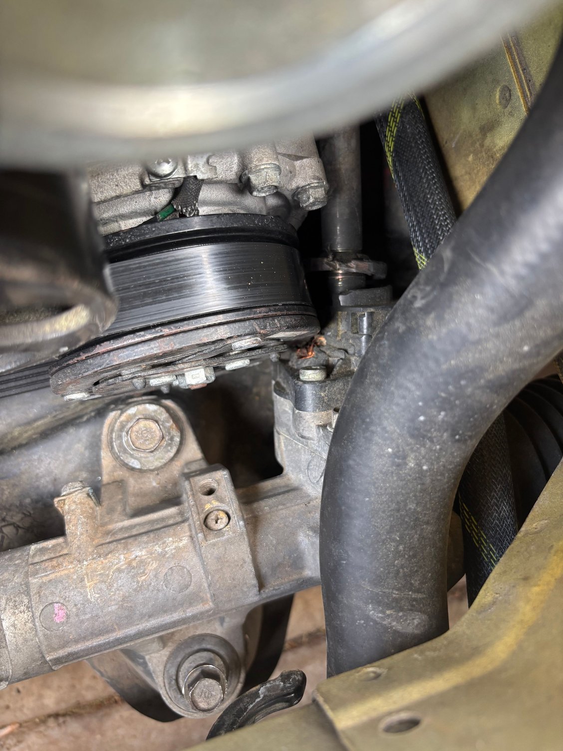

I tried shaving the k24a2 for the ac compressor to fit in the 01 s2000, I end up accidentally shave half of it off, and it look barely enough space for the ac compressor, anybody can guide me on this? The right way to shave them ? , and I’m trying to get the broken piece from eBay , or should I get another steering rack, or another torque sensor,? They cot quite a lot and I’m trying to avoid getting that if I don’t need to

man... the one part that is damn near impossible to get..

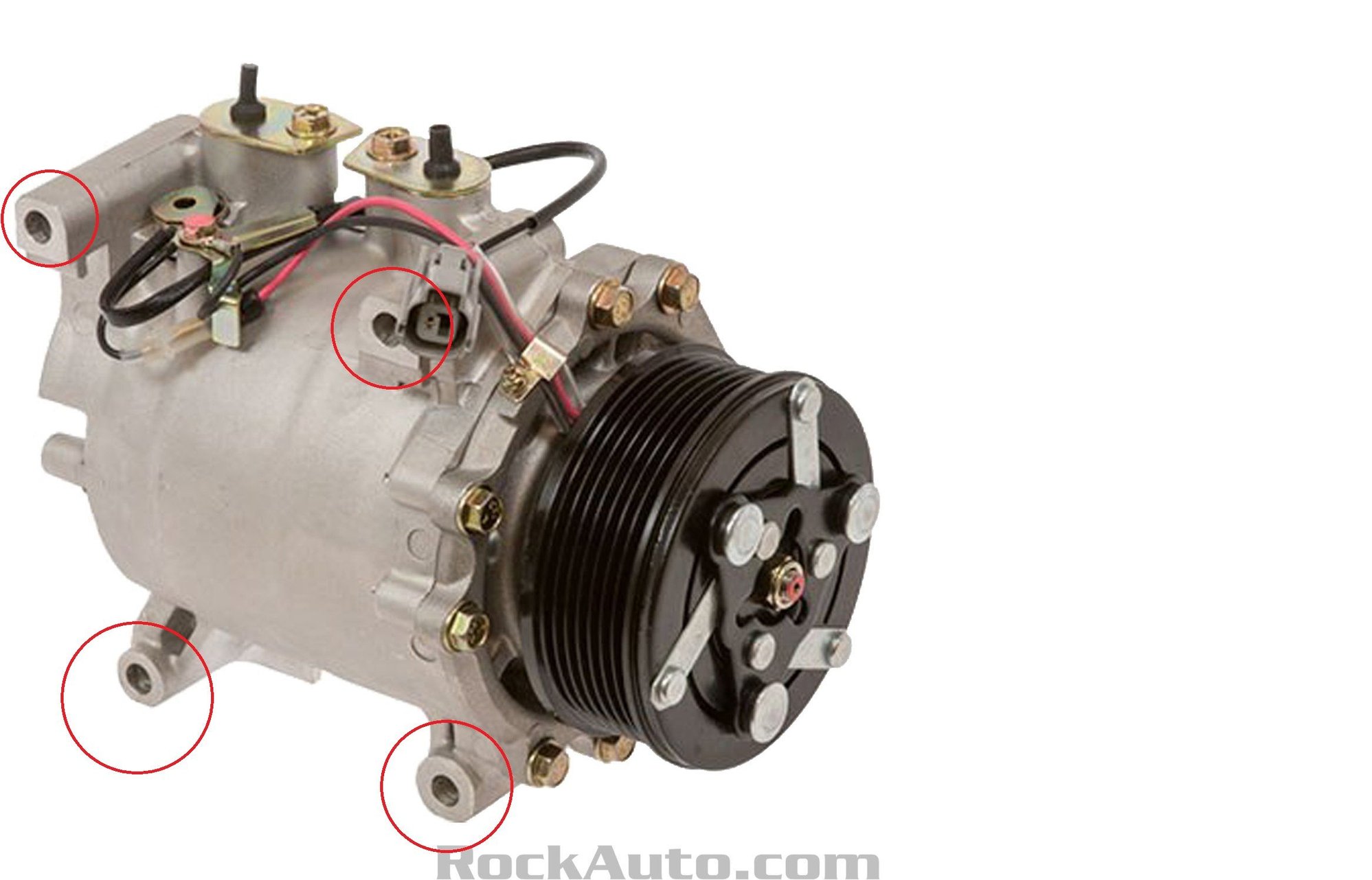

you need to "mill" down the mounting bosses on the AC compressor. I used a flap disc on an angle grinder. idk how far to tell you to go but just make sure its an even amount across all four bosses.
