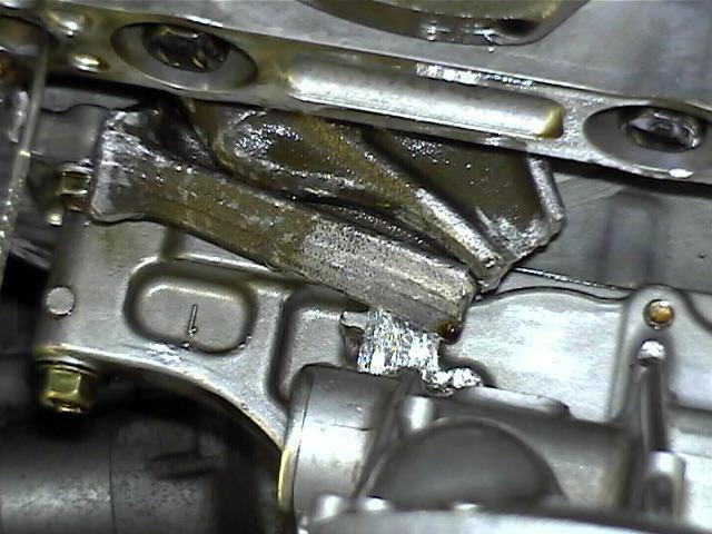

The mechanic told me that the short-block will be replaced and also the valves will be replaced, Tomorrow I will take pictures when the head is off.

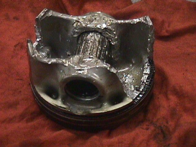

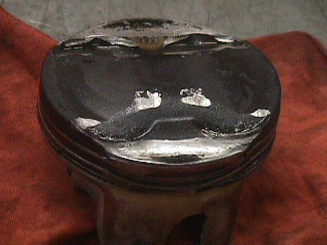

Nice pics, I think that camera is a nice toy.
Did Honda Benelux of the service dept check for the new 4 jet oil bolts. Were they fitted as expected ?
Is there any damage in the cylinder walls and pistons comparable as in the photos published earlier with the nr4 cylinder problem in USA ?

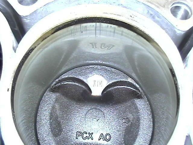

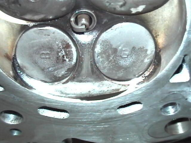

The Honda guy didn't checked the oil bolts, but he told to the mechanic that he must check it on the new short block if they are fitted correct, here you see the other cylinder walls and also the first cylinder, New short-block arrived today, must also order new valves, it is yet not for sure if I receive also a new head.
Rgds Danny
