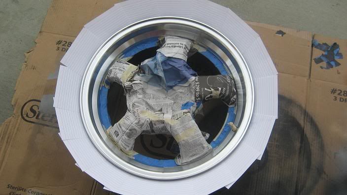

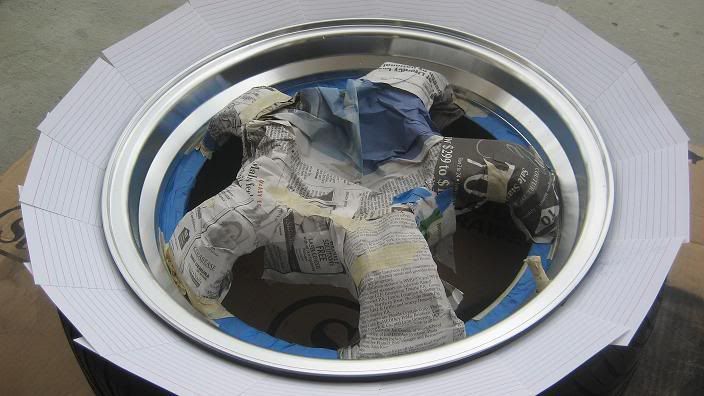

step1. Clean the wheels with rag, remove everything make sue you get into creases!
step2. Mask off the center wheel with newspaper, then with masking tape go around the wheel
see the chrome!
Step3. spray the base over the wheel you dont really need to sand the wheel i never have and every wheel ive had never chipped!
cans used!
step4. Spray the anodized blue, light coats, 10 min wait in between coats, 3 coats of blue!
once blue on base!
STep5. do all wheels, wait an hour or 2 for dry time, take off the masking tape, clear the whole so everything can be on the same level (less probability of chips)
