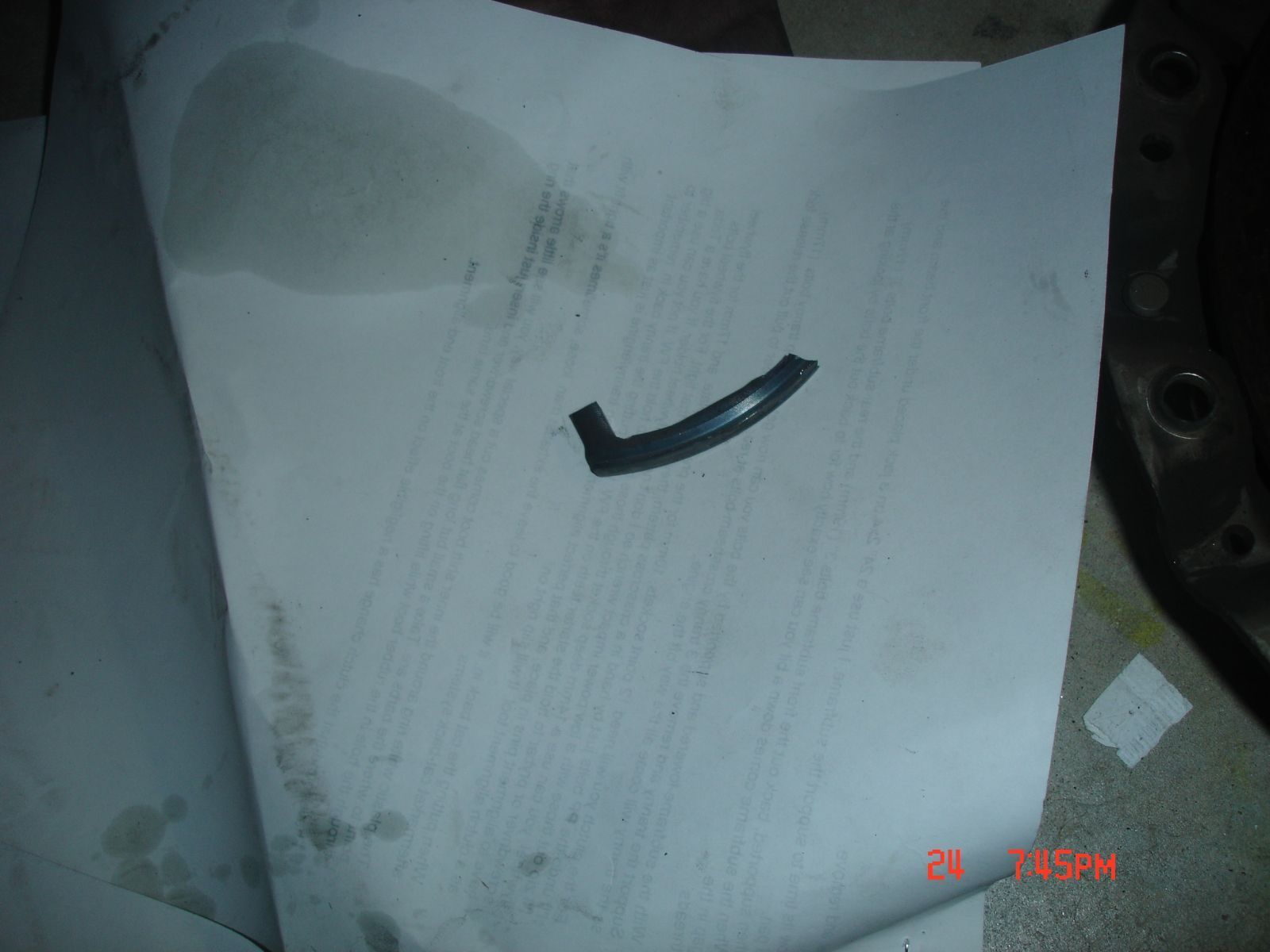

If it isn't the axle nut, it could be your clutch. I had a similar noise. When I slowed down with the clutch pedal pushed in when coming to a stop from ~3 mph to stop I would hear this noise. It was like the clutch wasn't disengaging. It sounded like it was coming from the rear as well.
This is what the disc is supposed to look like.
This is the broken disc
Broken part causing the problem
