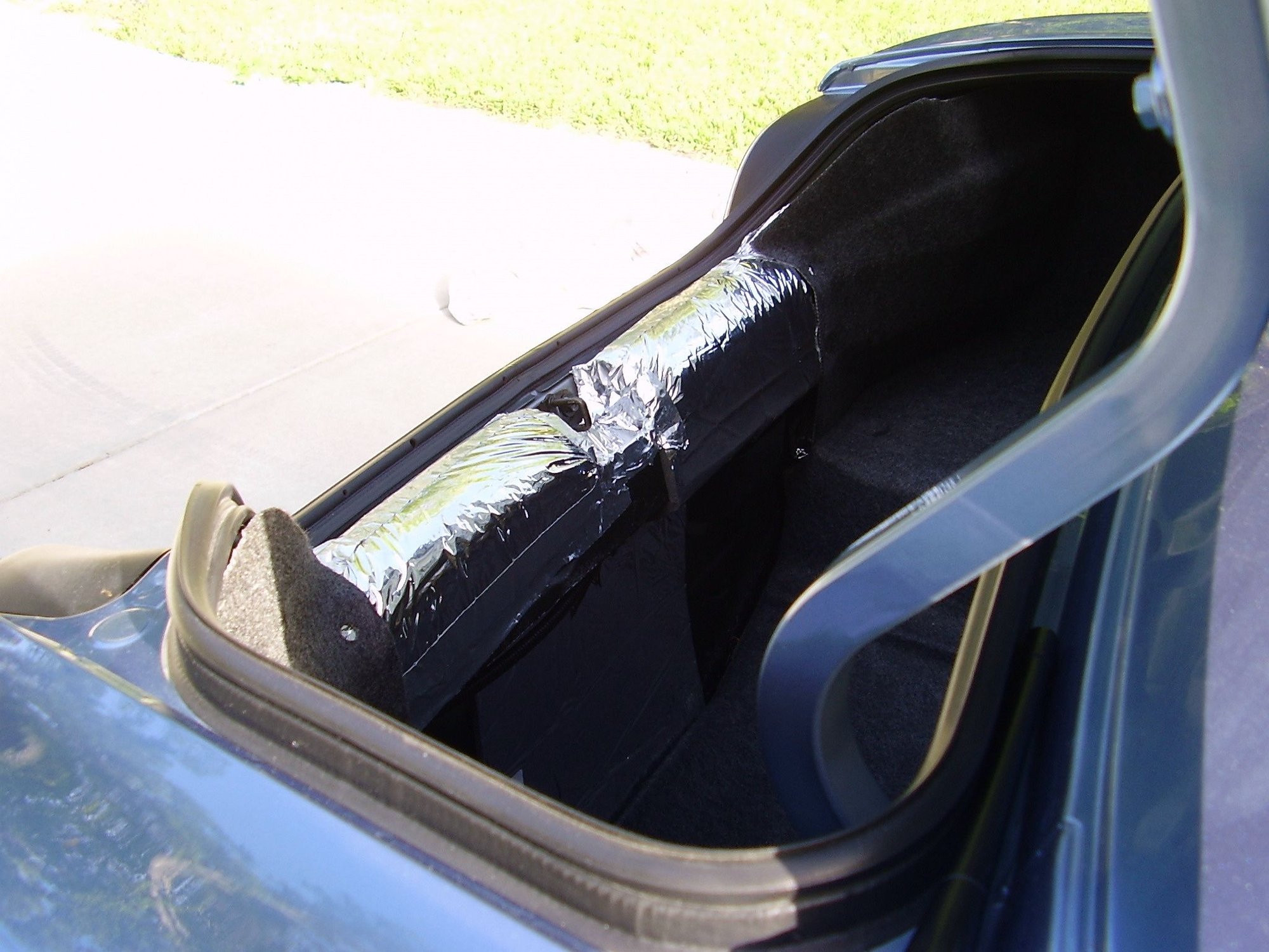

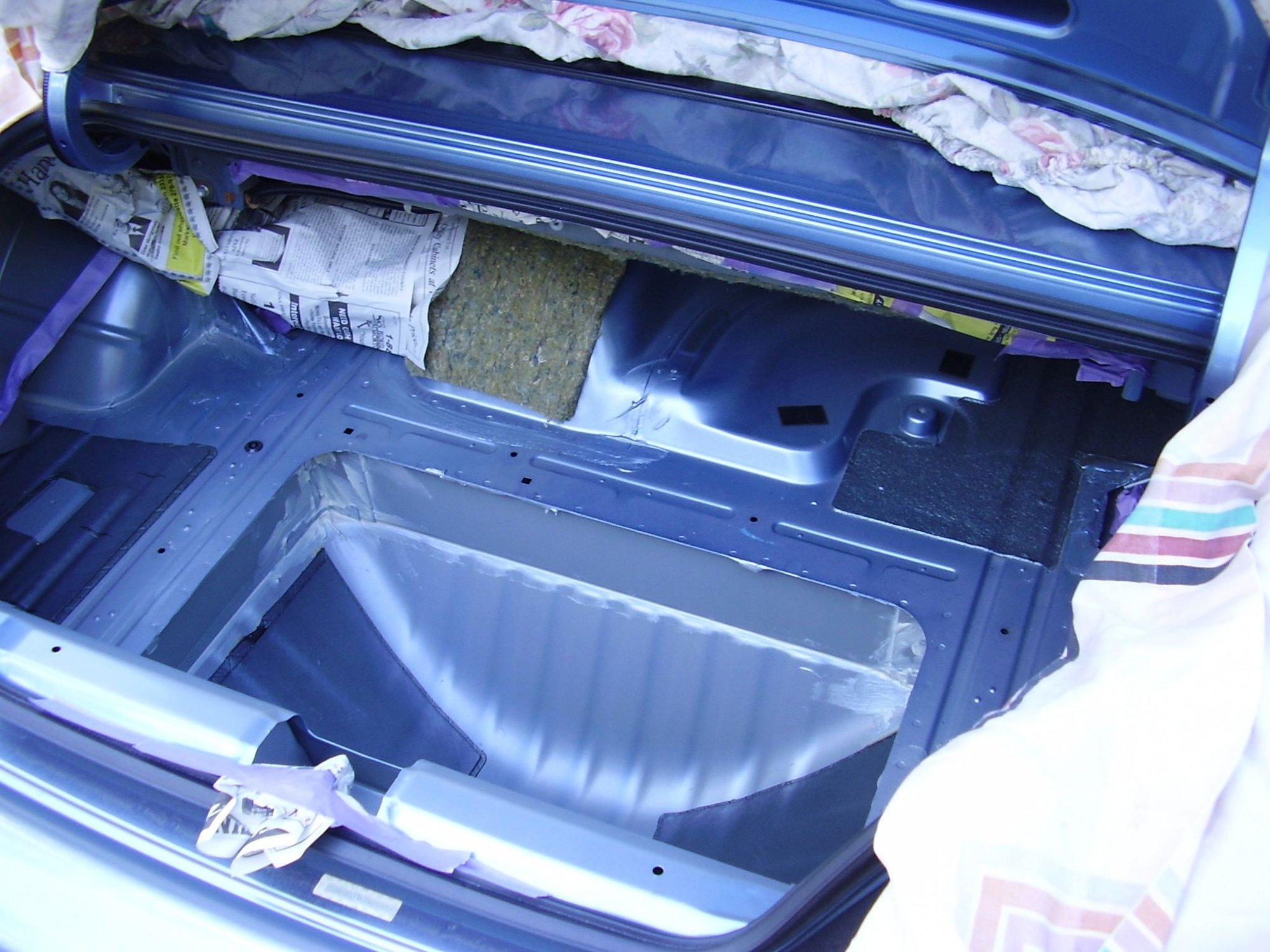

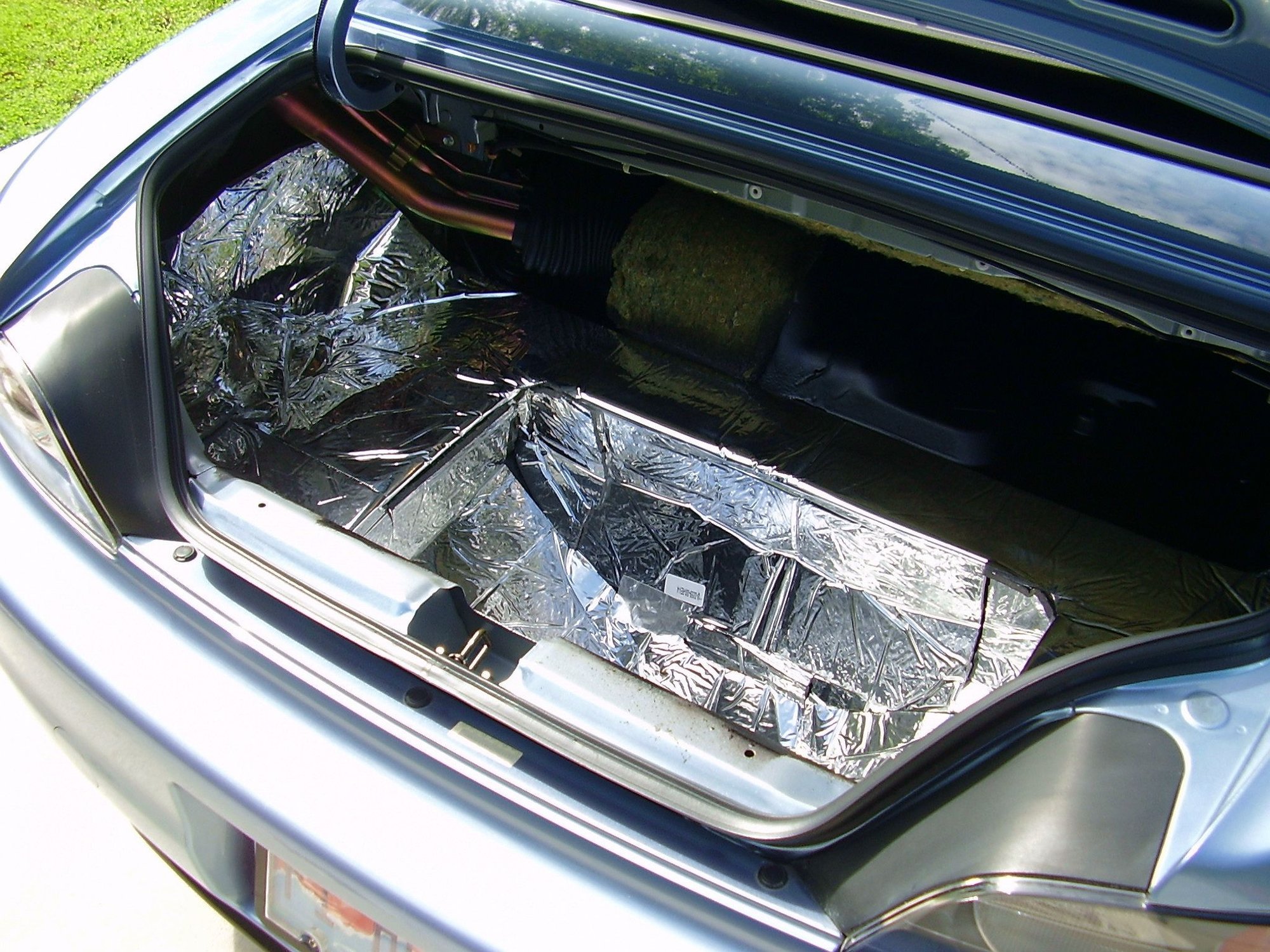

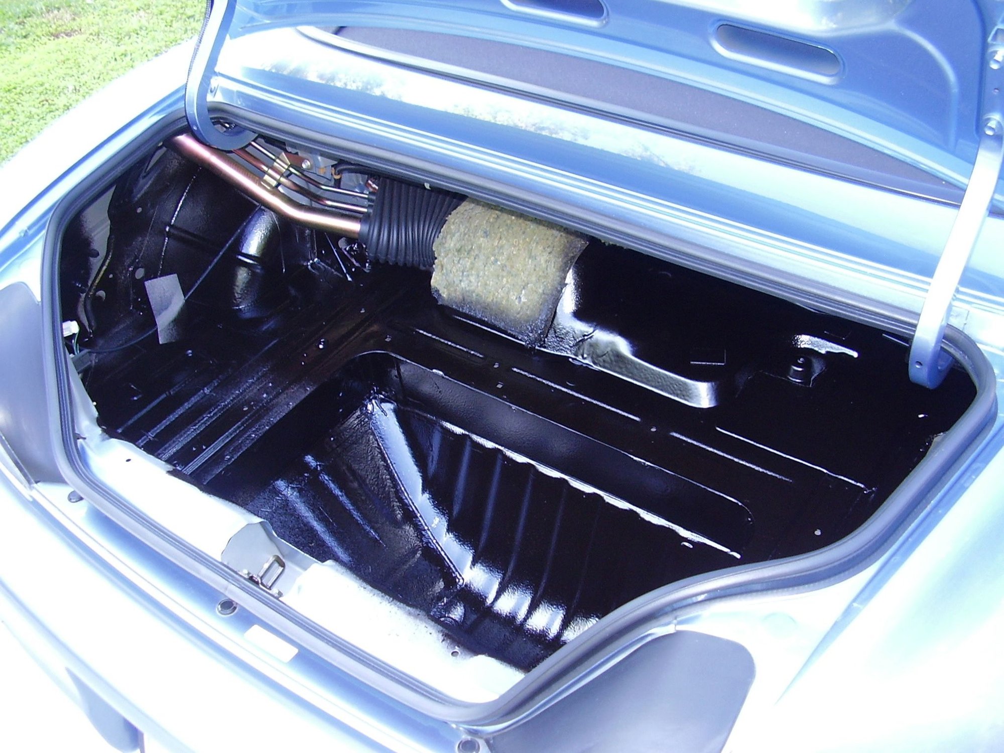

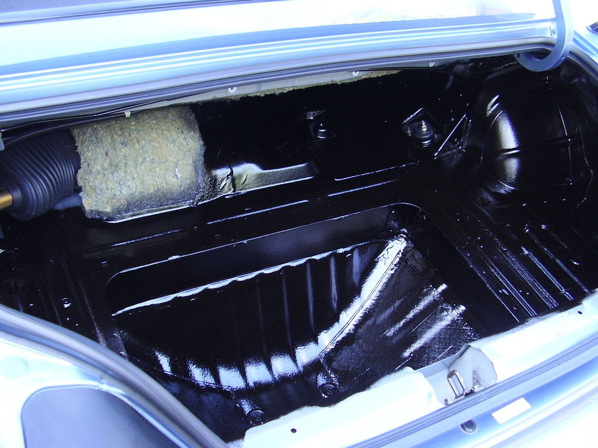

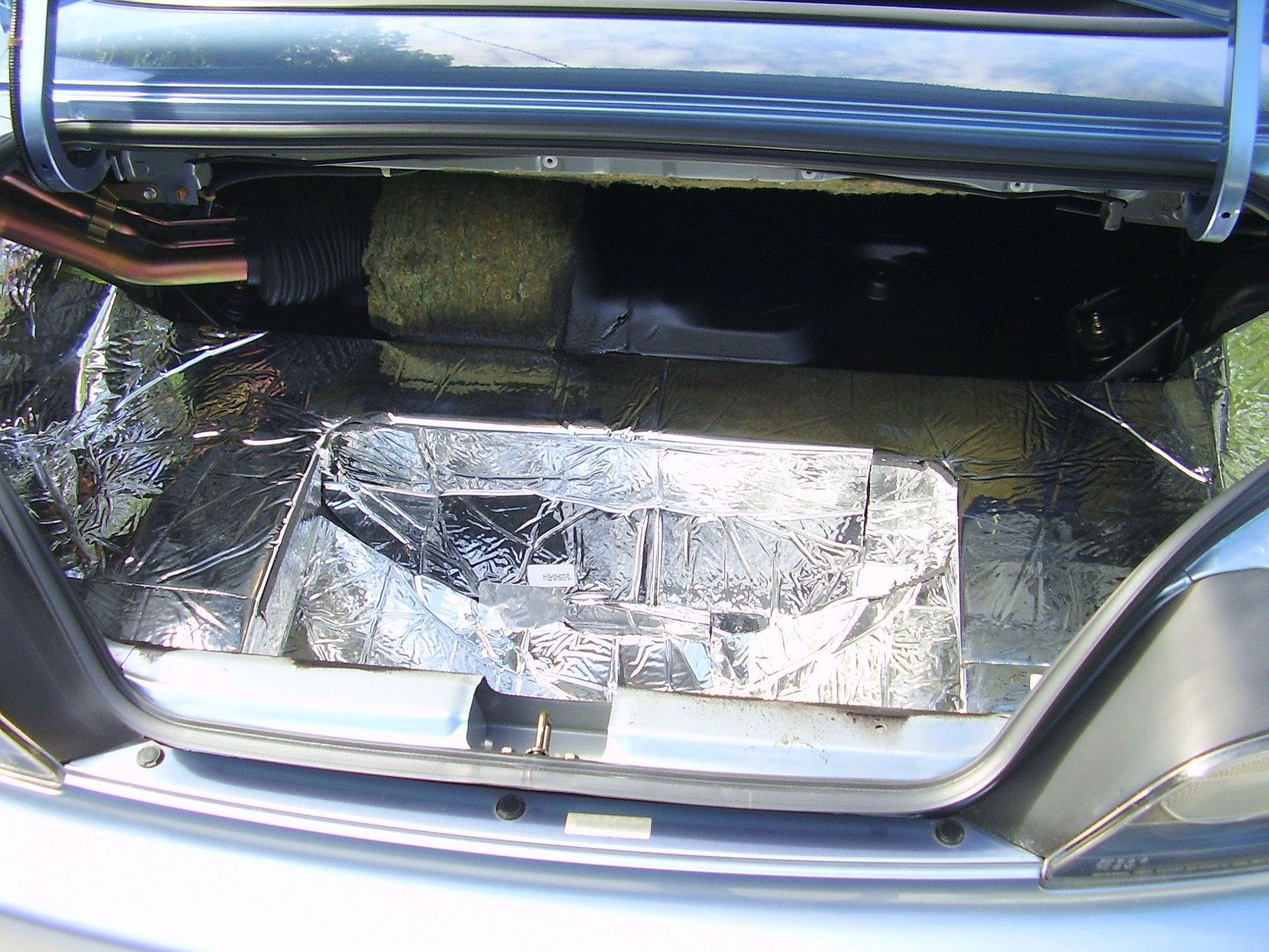

I started the trunk, had a day off LOW lack of work
The mess

The best thing you can do is put insulation above the gas tank and in front of the spare. I can't even hear the 4.57s.
I have plenty if anyone wants some.

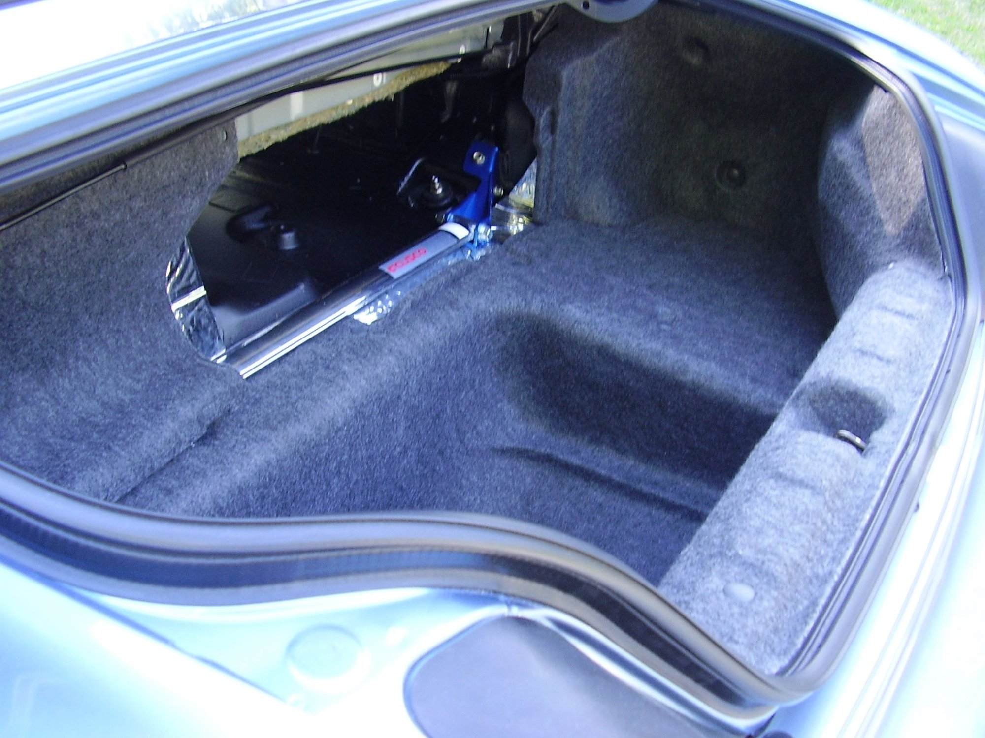

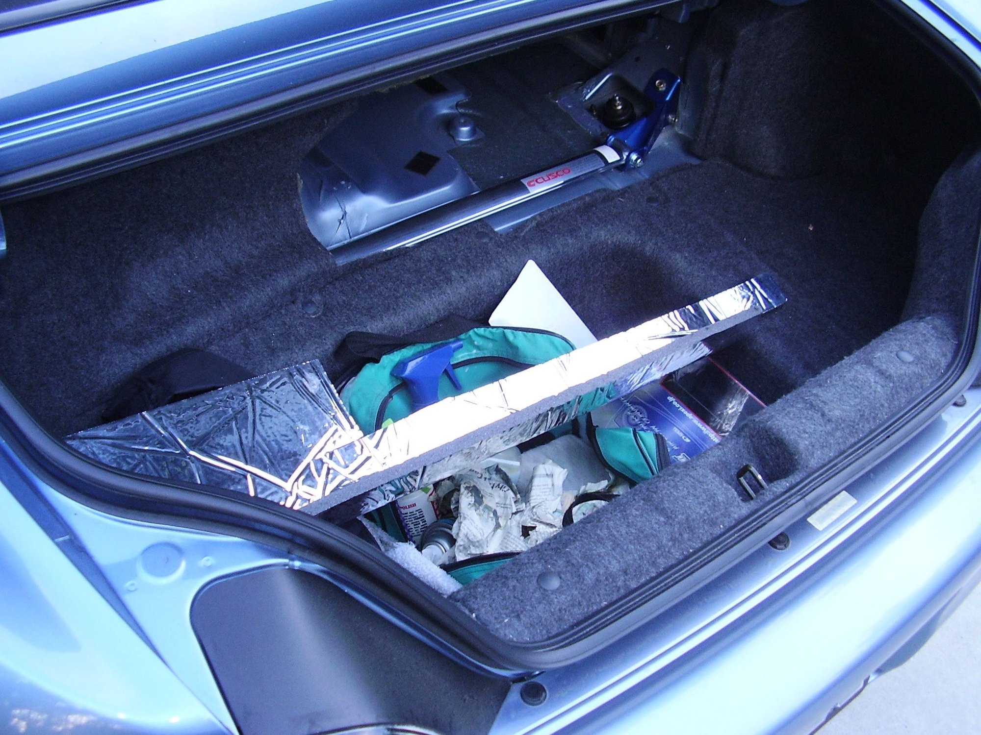

No hang ups with the rubber but, the drivers side door lock/unlock button is a little stiff because I did not put a slit along the metal rod that makes that function. I did on the passenger side and it works fine. All panels went on fine just a snugger fit

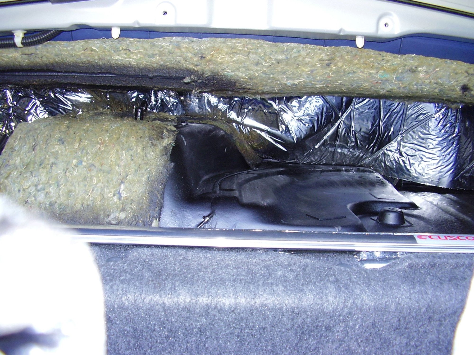

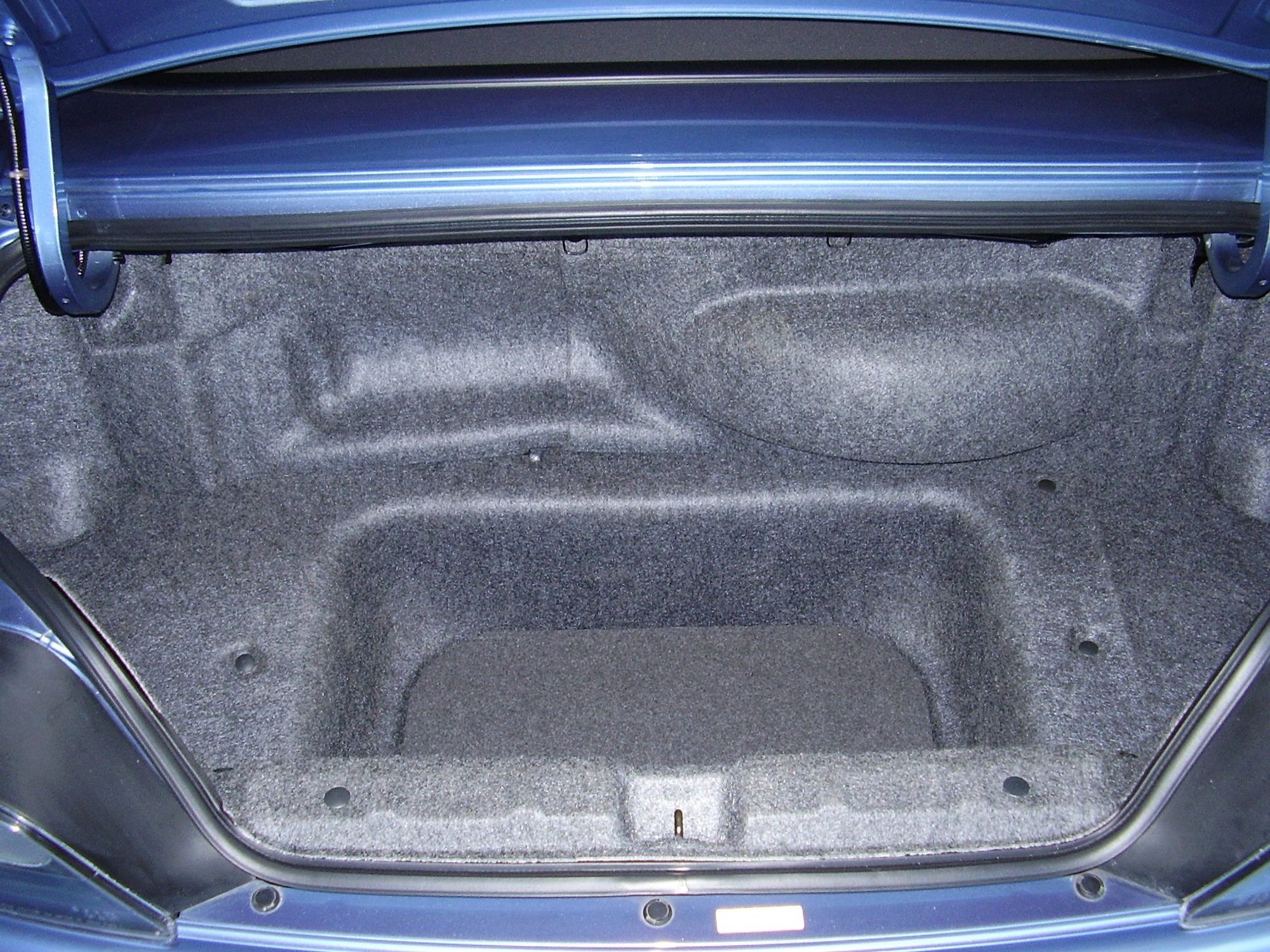

I finished the trunk
