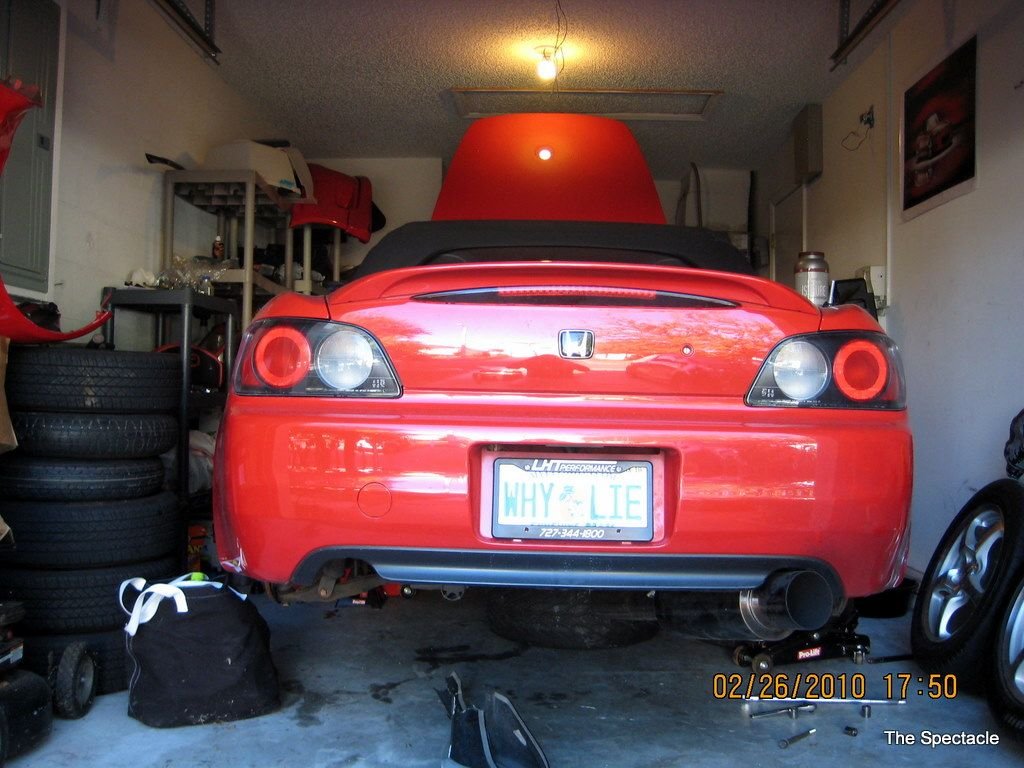

A lot of you have been wondering what my car and I have been up to the last couple months. The last meet I drove it to was in Nov or Dec and even then it was borderline broke. I’ve since corrected a number of things and it is finally almost road worthy again. For what seems like forever, my car has looked like this:
I finally got around to getting it back together. Here are the highlights.

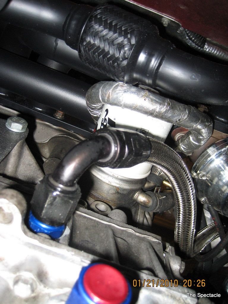

Rerouted return into the girdle. You can see my old return and the new coated downpipe also

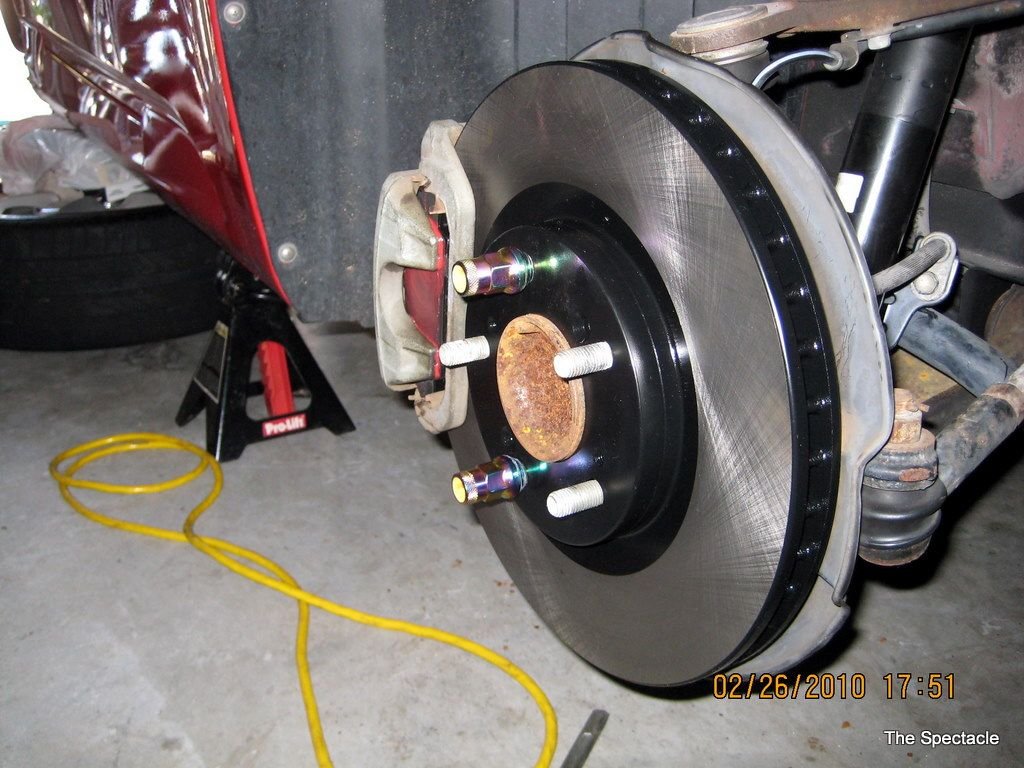

- New front rotors/pads (Hawk HP+). The rotors kicked my black ass. The retainer screws were damn near welded in and I was too lazy to go buy an impact. Took me like two weeks to drill them out lol. New pads dust like a mofo, but they stopppppppppppp.

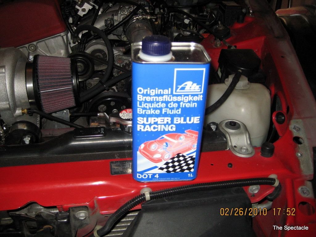

- New fluid (ATE Superblue). My old fluid was beyond trash. Smelled like burnt coffee

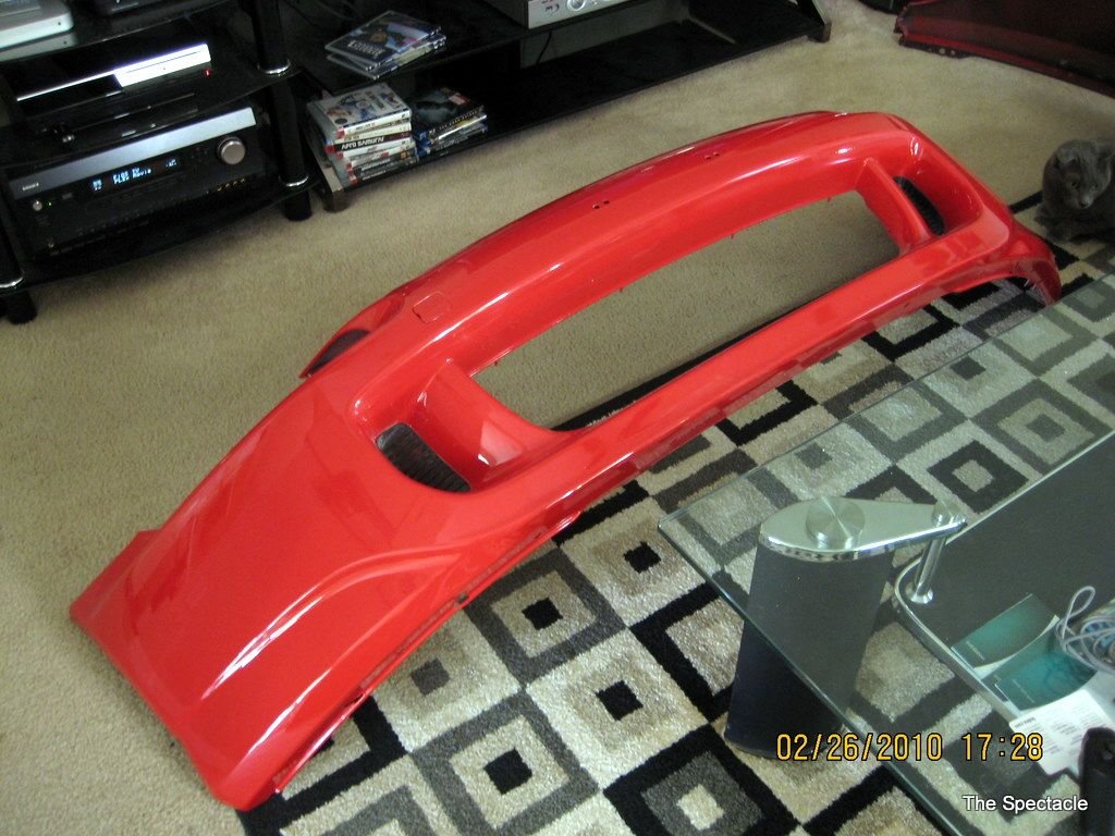

- AP2 front bumper

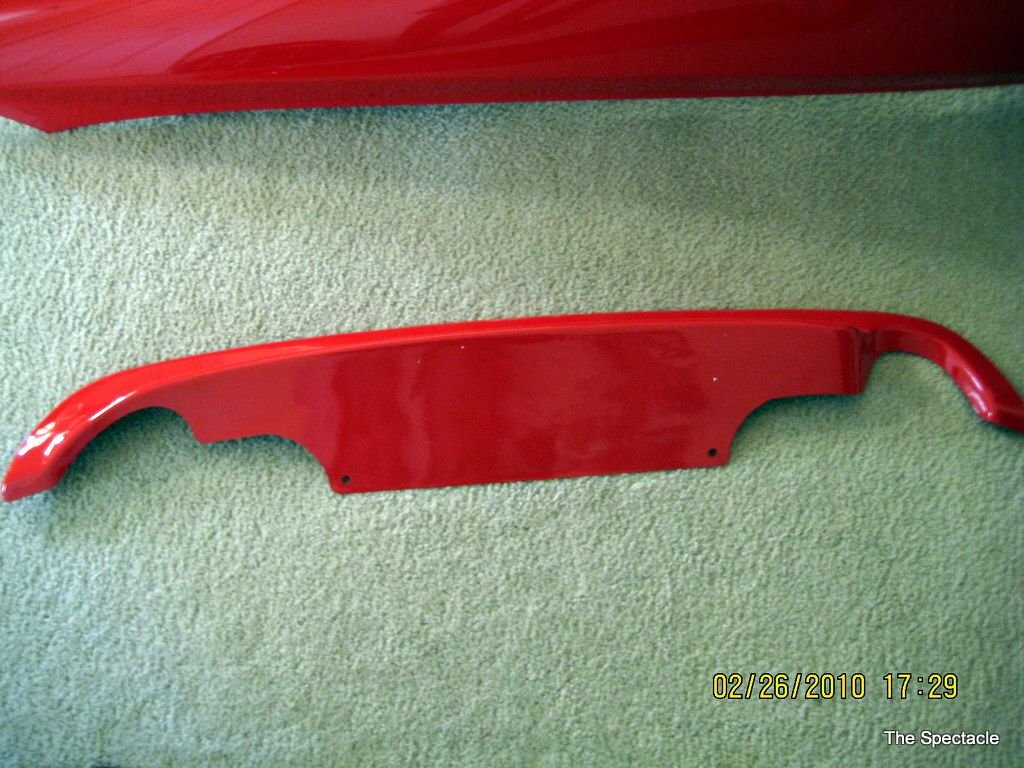

I had all the parts painted at Gene Perez off of FL Ave in Tampa. Funny story…they don’t take credit/debit cards. Checks only. Work looks good though, I would recommend them if you need paint/body work done. Talk to Mark.

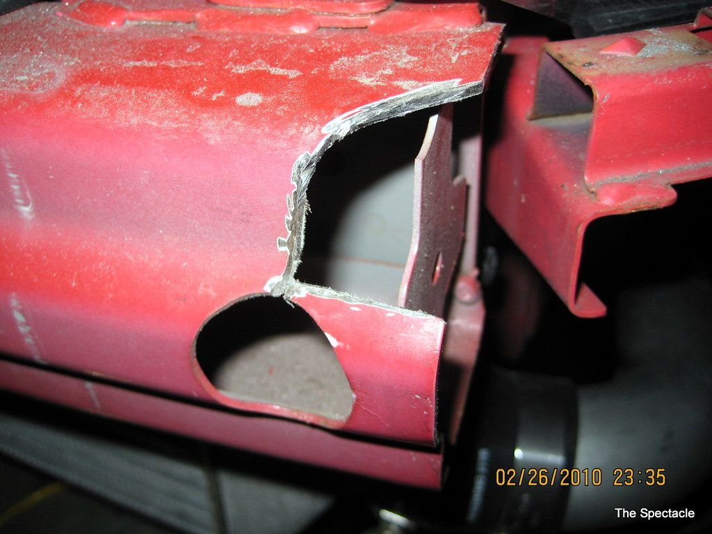

Oh and btw, you can’t just swap the AP1 bumper for the AP2 without a little modification. Don’t try doing this with a battery powered dremel. Ask me how I know.

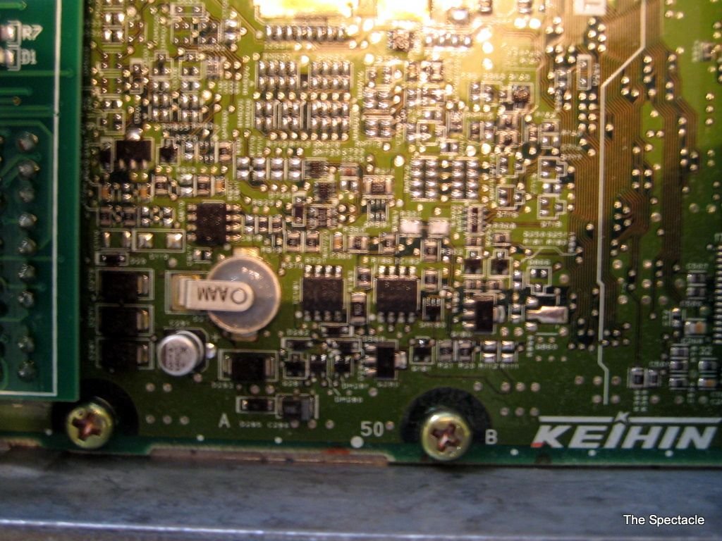

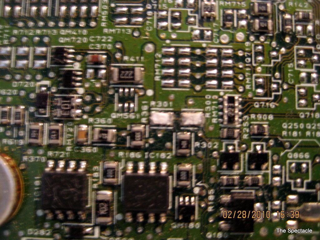

Lastly, I needed to figure out why my kpro wasn’t reading my wideband correctly. No matter what, it was always flatlined @ 12.3AFR. That’s fine for a NA car (which is why I didn’t catch it when it was installed), but FI cars run significantly richer under load. After countless tests and ‘discussions’ with Hondata, they finally conceded that it was the ECU that was the cause. Had to take out some resistors on the main board:
Works as advertised now.

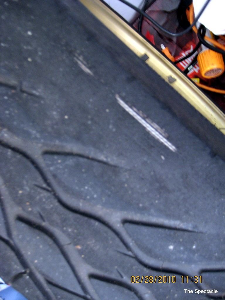

So as it stands now, I need new front tires. You may have seen this pic in the other thread:
Going with Hankook Ventus II Evo’s this time around. For all intents and purposes, they perform equivalent to the Dunlop Star Specs but at a fraction of the price. I’ll get an alignment this time lol
