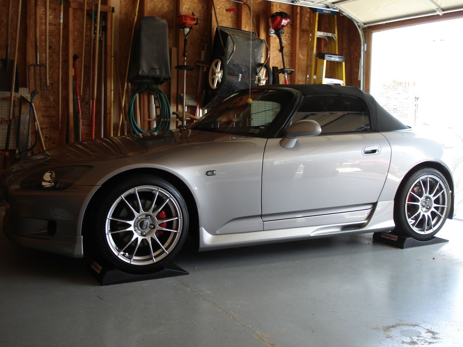

Originally Posted by 8BALL,Nov 3 2004, 08:30 AM
17. Pump the tires to about 45PSI to avoid flat-spotting. Place a piece of scrap carpet or foam insulation under each tire while parked.
An update on #17.
I was not happy with the results I got from this, especially in winder when the floor becomes damp/wet. The carpet retains water and does not give the tires enough support. Even though I have not encounter "Flat-Spots" in my tires, I did not want to risk my tires as my car will be stored for longer than the "usual" time.
FlatStoppers -- Prevent flat spots in your expensive tires when storing your vehicle. When you store your vehicle for long periods of times, use the Flatstoppers - Race Ramps. The known "whap whap" that flat spots cause is only one of many problems they cause. The Flat spotters aid in tire life and prevent cooling and warming of your tires making them more vulnerable to breaks and blows as well as cracks. Even on bias ply tires, the Flatstoppers put an end to flat spots to ensure your first cruise after storage is just as great as the year before. These non skid Race Ramps won't slip on any surface and won't leave marks on concrete or asphalt. The dimensions of the Flatstoppers are 22.34" long x 14" wide x 1.5" tall and are lightweight, weighing only 4 pounds each.

I know it's a little cool for the time of year, but it's still a bit early for winter storage Mike, isn't it?!?

I think that it has soimething to do with the knee
I have seen these before. They are not cheap. Let us know your results

I'm expecting to have my other leg done in the fall, so unfortunatley, I will not be able to drive the S until spring next year. I have not fully decommissioned the car yet in hopes to drive it a while before the next surgery.
It was pretty difficult just moving it to tget it up on the ramps.
