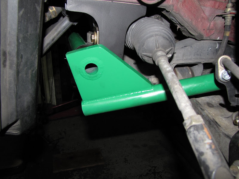

Behold, the 1.5" monster (the girlfriend decided I should paint it green):

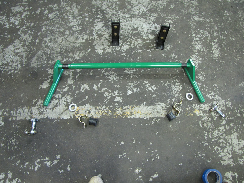

Guy Ankeny threw it on a jig to measure the swaybar stiffness. The stiffest Gendron bar measured out at 580 lb/in. This guy was 720 lb/in, and we think a lot of that deflection was in the bushings. Since he doesn't have to cut splines on the main bar, it's a bit cheaper than the Gendron too.
Also with the swaybar I installed some beefed up swaybar mounts as we're talking about some pretty significant swaybar loads:

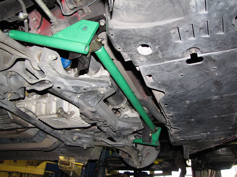

The install went super smooth. First time I tightened up all the bolts the swaybar still went through it's range smoothly with no binding. It's well clear of the steering boot and isn't going to bang into the shock body like my Saner bar did.

Looks good Jim, I did mine with a splined 1-7/16 bar and went over top of the steering boot.
Looking at yours makes me feel stupid because that is so much simpler. I can't go to full lock on mine without rubbing because I used a standard 37.5" Nascar length bar.

I still have stock shocks and with the Saner bar set to full stiff the end of the threads for the endlink rubbed the shock body. I could have ground 1/4" off the bolt and it might have fixed it.
I just did a quick 'test-track-behind-work' shakedown and the car feels great (on street tires). It's tight but I don't feel like it was 'pushy.' I might take a little of my toe-in out of the rear to let the rear feel a little more 'live.'

Jim - what did you guys use for the center section? Looks like you've got something that is about a 1/4" wall thickness

1.5" x .375" wall. The bushing ends are turned down to 1.25" to use standard poly bushings.
Guy is also looking at selling the bar with a blade type adjustor on one end. He built a prototype for his car but I believe right now he's trying to figure out the best way to manufacter more blades.
unbolt the endlinks from the control arm and the bar. Unbolt the bar brackets from the car and slide the whole bar forward a bit. Then bold the endlinks to the bar with the nut on the inside of the swaybar arms. This puts the head of the bolt nearest the shock. Then bolt the brackets back up and re-attach the bottom of the endlinks. You should gain clearance between the endlink and the shocks.
