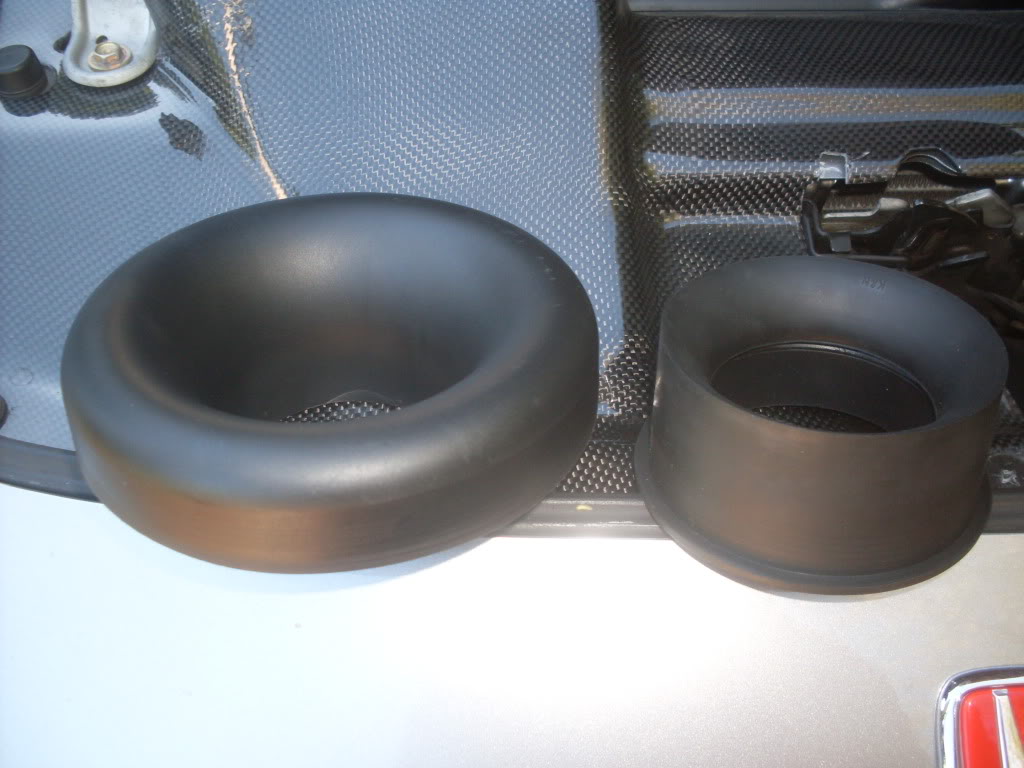

Here are some pictures of the velocity stacks side by side; huge difference.

Some measurements. Notice the lip on the inside of the FIPK velocity stack? That's the inside diameter of he FIPK pipe.
Traditional FIPK
FIPK with BPi stack. Notice that the BPi adds a little length to the pipe. The FIPK velocity stack slips over the FIPK pipe, while the BPi buts up against the end of it.
Traditional FIPK
